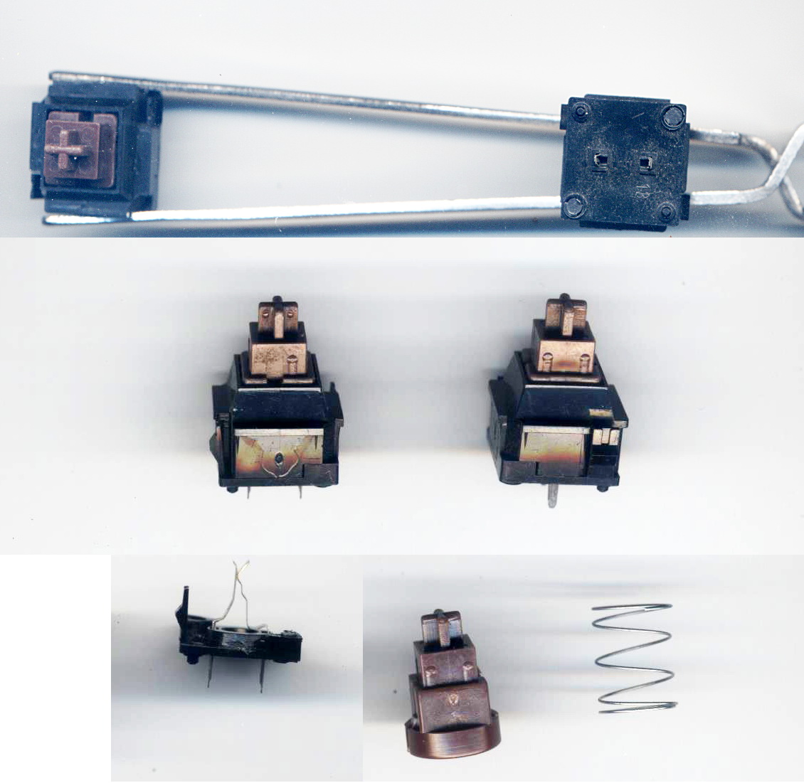

I recently came across a package of switches. And, with the help of the wiki, I am able to identify the switch. It is a USx LXBB03.
http://deskthority.net/wiki/USw_LXBB03
According to the wiki, its origins are unknown, although they've only been found to be used in a specific Fluke keyboard. The slider is different in color only when compared with the imagery in the wiki, as the switch I have on-hand is a dark brown. So, it could be a different part number. To make sure this was indeed the right switch, I sacrificed one for science.
Deskthority describes the metal contacts as "praying hands," as it actually looks like two hand placed together. Unassembled, the contacts touch. In the slider, there is a white stick that runs across the inside. With the slider in its natural position, the stick is jammed between the two contacts, separating the contacts. When the slider is pressed down, the white stick goes down with it, thus allowing the two contacts to touch. And then, when the slider is pushed back up by the spring, then once again the stick separates the contacts.
It does make sense that the switch is used by electronic test equipment such as the Fluke, seeing I found the switches in a store that sells test equipment. Unfortunately, the people who run the store have no idea where the switches came from. They've been sitting in the store for over 30 years, and never moves. When I purchased a bag of them, we had to work out a price since they didn't even have a part number or price for them. The rule I've always practiced is to know the product better than the seller. In this case, he offered a price for one switch equivalent to a tact switch.
If the image is found to be worthy of being placed in the wiki, please do so.

Nice find, thanks for sharing.
Unfortunate that the store doesn't know anything about the origins, but you've at least revealed another slider colour. I wonder if there is any functional difference though. The contact leaves look to be the same, and although the spring in the image on the wiki is obscured, they seem to have the same amount of turns. The only other cosmetic difference I can see is that yours doesn't have a dimple on the bottom, though I doubt that is significant really.

Someone posted photos of a brown slider switch that resembled that one a while back. It should be in some DT topic somewhere.
Note that it cannot be LXBB03 as BB means black shell, black slider. A new colour requires a new code. R for Brown?

This switch is now the USw LXBR01 based on established nomenclature :)
I've updated the wiki accordingly.
Just realised it will be funny if we ever find an unknown switch with a red slider/stem...maybe 'N' would have been better as a designation for brown...oh well -- can always change it later.

While looking at patents, the diagram for this one struck me:
http://www.google.com/patents/US4361743
The wording confirms it: the leaf shapes are specifically designed to provide a tactile feel, and a subtle click. It's a similar idea to LXBN01 above: there's a section where the leaves are parallel which, once cleared, should cause the leaves to snap closed.
As such, both these and LXBB03 (Sandy's) should be tactile and faintly clicky. Sandy indicates that they should be fairly smooth linear when new, but that the feel of his has degraded (to paraphrase bad Google Translate), whereas the design ties in with a Stackpole patent indicating that the leaf shape is specifically such as to be tactile. (Anyone heard from Sandy lately? It's been nearly a year since I last heard from him, though I've been dropping him regular e-mails to keep him in the loop with any discoveries that should interest him.)

Just in case terrycherry is alive anywhere — these cream ones appear to be the Cherry MX mount version, so that would make them LM instead of LX. It would be nice to get these confirmed. I tried buying some ages ago, but they'd already sold out. I guess there were not many of them for sale.
(terry: USw LXBN01 means "unknown switch, metal leaf contacts, black shell, brown slider, number 1"; R is red, so brown had to be N instead. In fact, these are [wiki]Datanetics DC-60 series[/wiki] switches, but no documentation has been found for these cream ones.)
