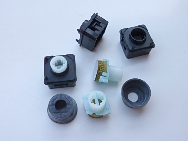

The foam in the eBay auction even looks a bit like the foam used by Key Tronic.
original:
I wonder, is the thickness of 5 mm correct? (I gave my discs to another member, so I have nothing left to compare against)
