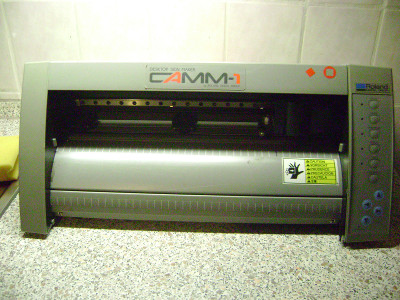

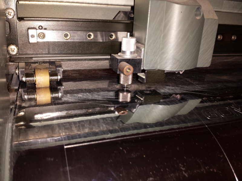

I had what could be a revelation today in a shop, It is a photo shop. They where cutting acrylic with a Roland plotter to make metal-like stickers:
This is what I saw:
Two questions came to my mind: (1) is the acrylic foil conductive ? (2) would be possible to do membranes and/or F PCB (like) with it ?

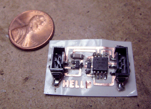

The guy offered some left overs from the tape. It is not conductive. But searching the web I found that my revelation may be a good one. Look at this How to make circuits with a Roland CAMM sign cutter
--> The following image is extracted from the instructables above:
Has anyone already thought about this idea ?
I do not have access to a plotter and to test it we will need to get our hands in the conductive tape: this one ?
What do you think ? Could it be that it a real revelation ?

More than "printing" I mean "cutting" copper tape. From what I have seen. I guess that it should be possible.
One could create a matrix with diodes as suggested by Mu here "Plan for NKRO in a Model M". If all the contact points of the matrix are routed to an outside board the diodes could be added. Again, this is just an idea.
But what I consider even more interesting and perhaps more complex, is to cut the copper to create capacitive boards for Fs.
