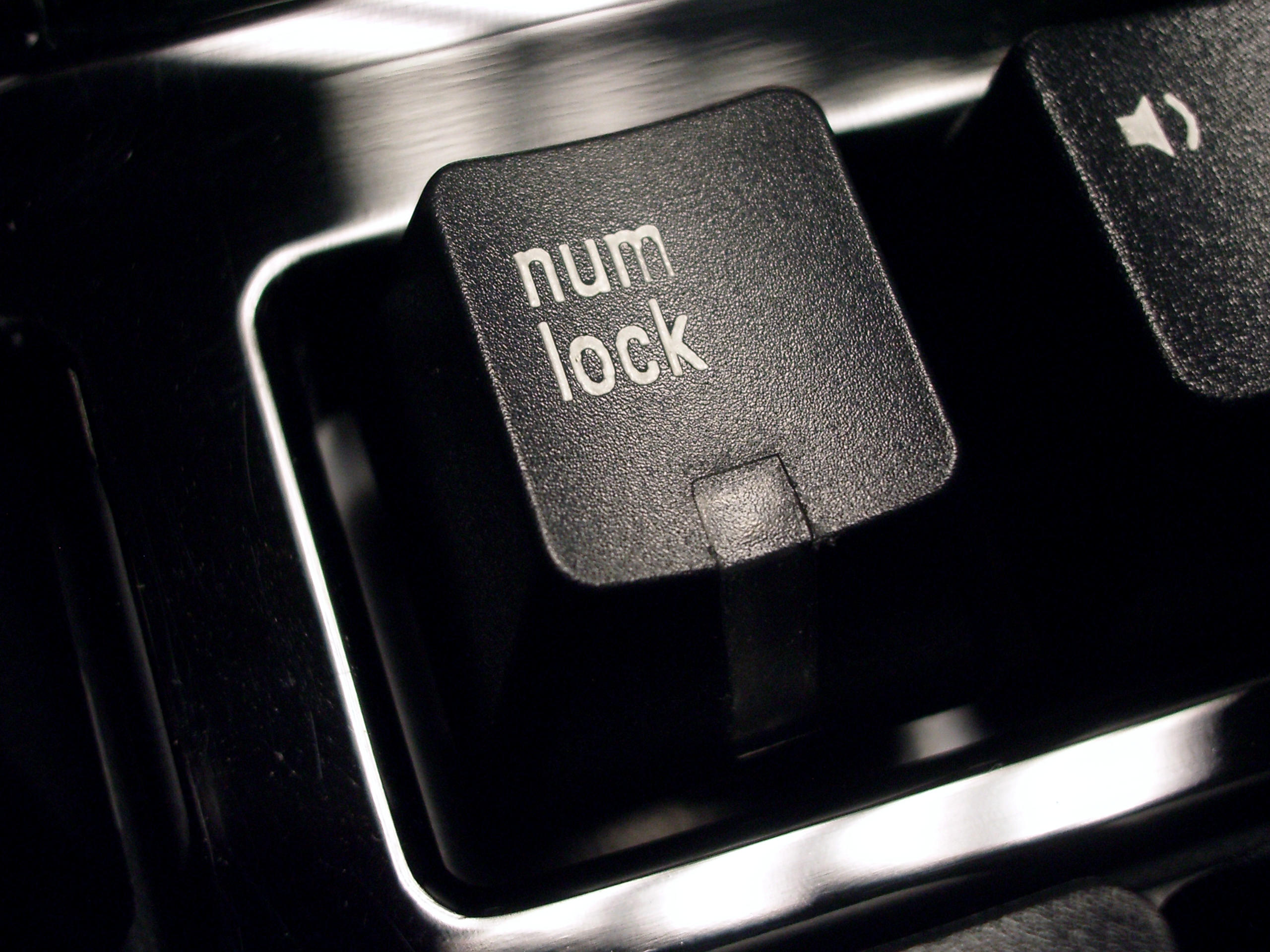

Here's the key I noticed first, the 'm' in "num lock":
Matias Tactile Pro 4 -- laser foaming.jpg (553.77 KiB) Viewed 9289 times

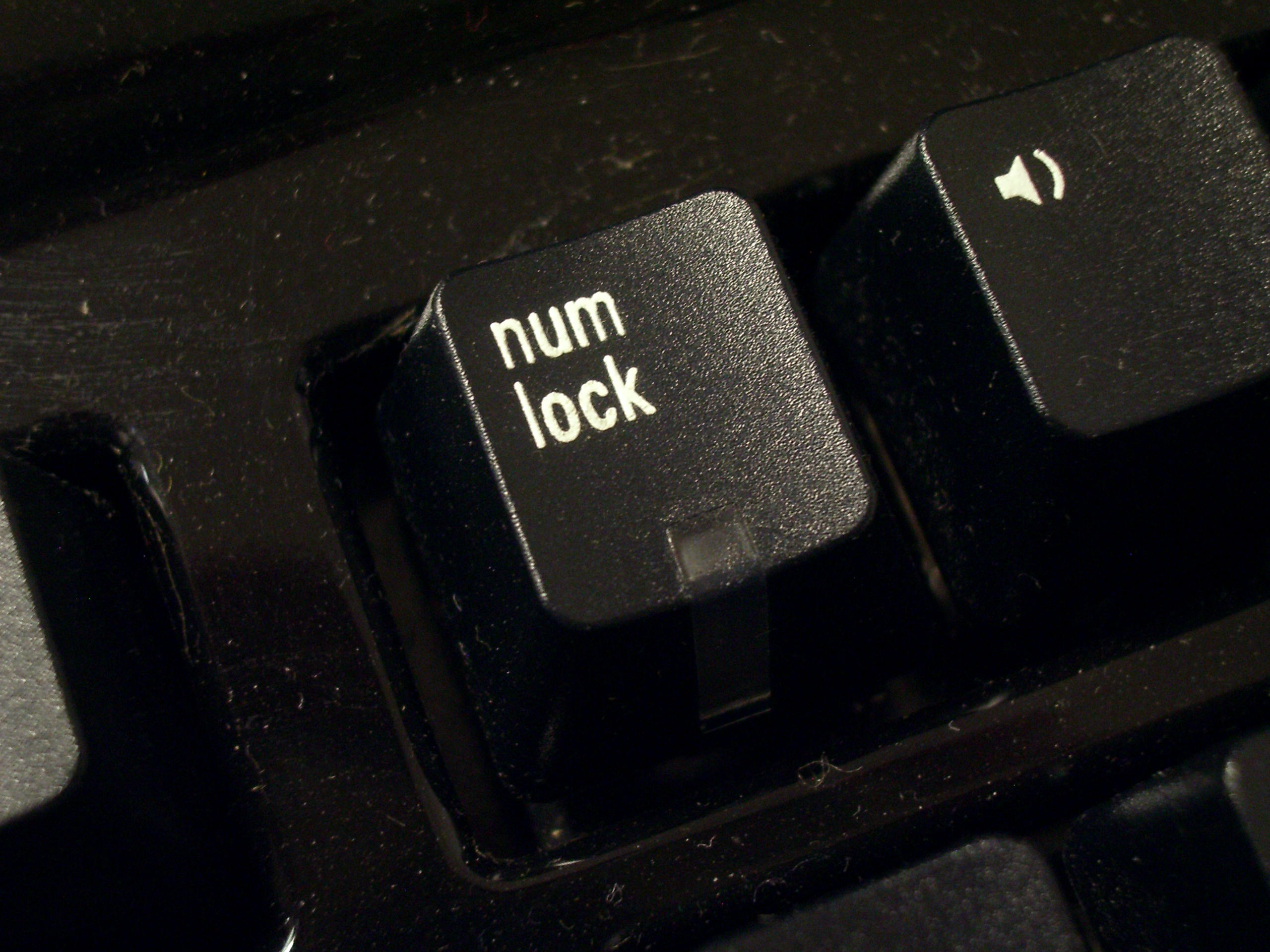

This is how it looks on my Quiet Pro:
Matias Quiet Pro -- laser foaming.jpg (561.45 KiB) Viewed 9289 times
I imagine there's a fair amount of variation from keyboard to keyboard. You can see the aliasing (steps/jaggies) even in the words "num lock" on the Tactile Pro 4 for PC, but it's much more noticeable on the 'O' key:

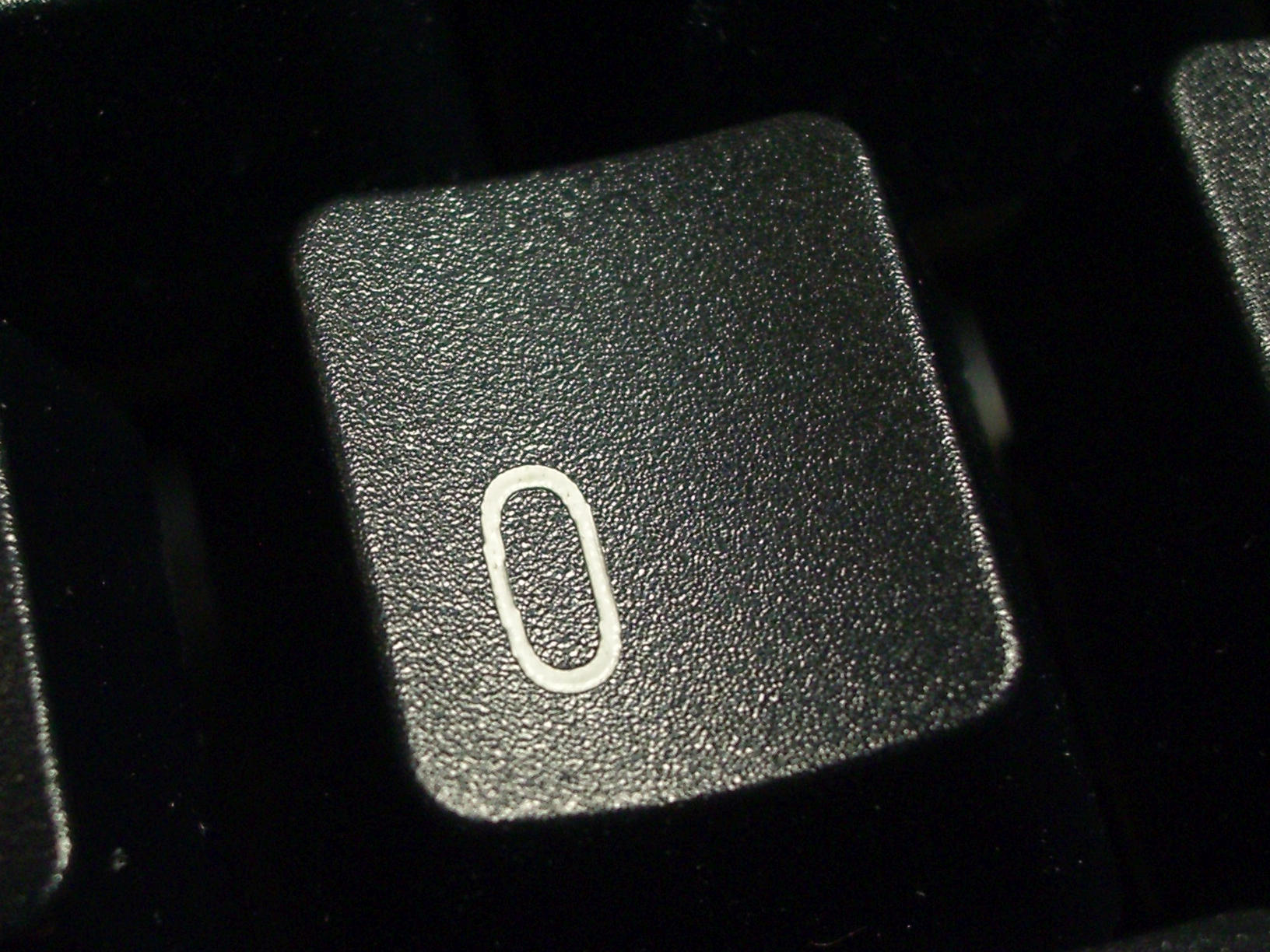

Matias Tactile Pro 4 -- O key.jpg (340.71 KiB) Viewed 9289 times
It looks worse in person — I was having a hard time with those photos, trying to get enough light for the camera (under the really bright strip light bank) while trying to avoid the resulting glare. (The middle photo was taken under far less light, as I couldn't move that keyboard — too hard to get the cable out from the desk.)
The keycap printing is pretty shabby. On the one hand, many people accept that they'll be replacing all stock keycaps, but with an Alps clone keyboard this much less of an option right now!
26 Dec 2014, 12:13
Christ, that's shitty. A nice sharp edge, but a nightmare distortion of the legend! So close to being a great technique, but only enough to highlight what a botched job it is!
By the way, I'd never heard of laser foaming, so I looked it up.
http://www.or-laser.com/en/laser-marking/laser-foaming/
Having read one page about it (and so therefore now clearly an expert) your pictures look surprisingly high contrast for this technique. Are they really that clear? And do you notice any inconsistency in the surface texture with the rest of the cap?
26 Dec 2014, 13:40
The legends are pure white and they're raised above the surface of the keycap — I was having trouble getting the right exposure with the limited indoor light and the glare off the shiny case. All the grey stains in the legends aren't visible normally; I was trying to illustrate the aliasing and malformed shapes, not the staining that doesn't really exist. The second photo is a lot closer to how the legends actually look, which is pure white.
The rest of the keycap looks fine.

Strangely, I like the Matias gloss black, but mine came scratched from new (as did the Quiet Pro as I recall) and polycarbonate seems to scratch very readily. Even brushing off dust for a photo left scratches in the plastic! It's not like whatever my camera screen is shielded with, as that's glossy yet not terribly scratched after nine years. (It's scratched, but not like my brand new Matias!)
