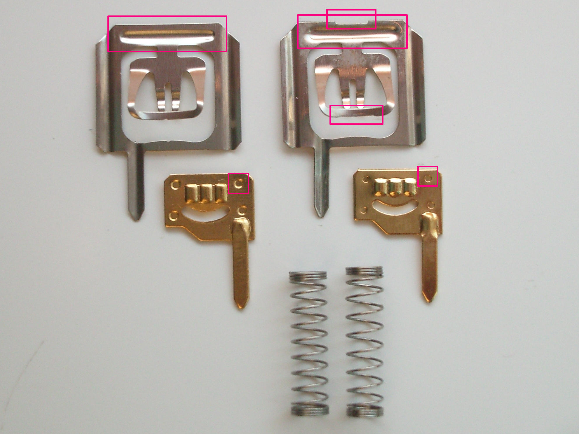

Xiang Min KSB/KSBF series and Hua-Jie AK series switches do not use the same internal metal parts!
I've just had my samples apart and scrutinised them, and the parts are not the same at all.
  • Looking at the photos that alps.tw took from a Filco Zero FKB108ZJB, the stationary contact from the Zero resembles the one that Hua-Jie now use
  • Xiang Min's stationary contact has a notch across the top, and along the bottom of the crossbar; for some reason this notch vanished from Hua-Jie's switches
  • Xiang Min use two different shapes of movable contacts: one with a curved crossbar, and one with a straight crossbar; neither design is quite the same as Hua-Jie's as they don't have either of the two notches
Hua-Jie AK-CN2 (2) vs Xiang Min KSB-C with points to note:
Hua-Jie AK-CN2_2 vs Xiang Min KSB(F) curved.jpg (245.2 KiB) Viewed 995 times
The springs aren't the same, but I guess that was to be expected.

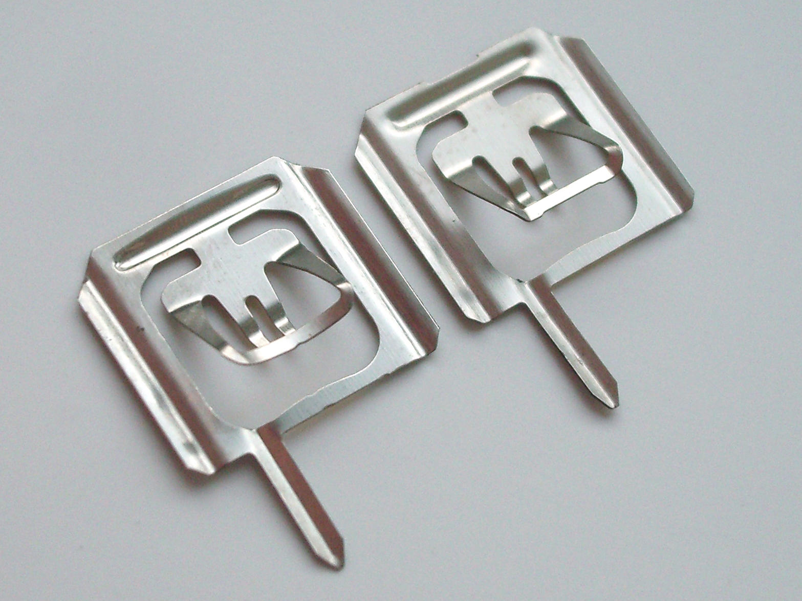

Hua-Jie AK-CN2 (2) vs Xiang Min KSB-C straight crossbar:
Hua-Jie AK-CN2_2 vs Xiang Min KSB(F) straight.jpg (189.29 KiB) Viewed 995 times
There seems to be no consistency about the crossbar shape. alps.tw's Zero switch had a curved crossbar, while Sandy's had a straight crossbar. Of my Ducky 2014 sample switches, the split is 3-2 in favour of straight for the linears, and 5–0 for the clickies. With Xiang Min's 2013 sample switches (2 of each type), clickies are straight crossbar, and linears are curved.
