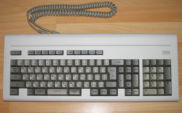

ok see now I understand your needs a little better. I was baffled by the very "specific" layout. Your bottom row remindes me of a Japanese layout, although I have seen other users here "cluster" the spacebar area.
