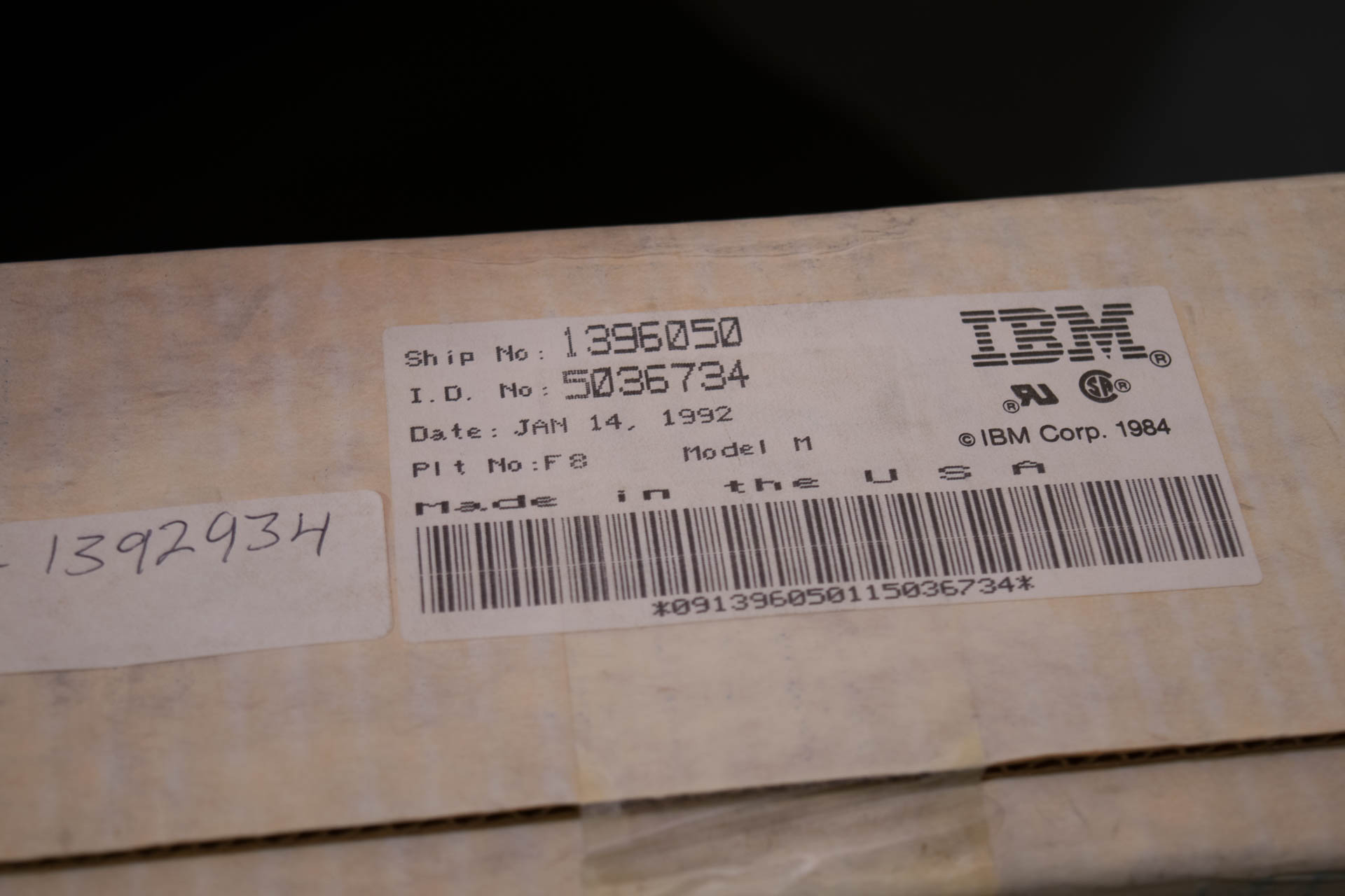

Upon interrogation, it revealed it's true identity:

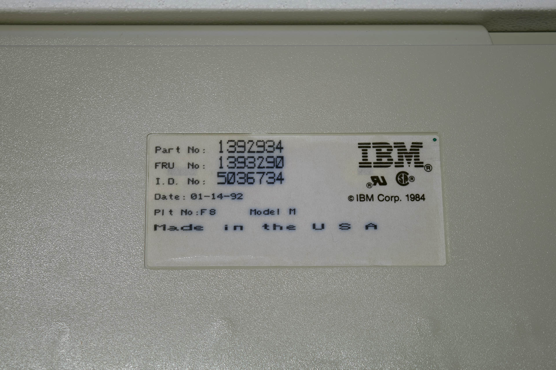

IBM Personal System/2 Space Saving Keyboard P/N 1392934 born on 14th January of 1992, two days late for it's 23rd birthday.
Tape was still intact!

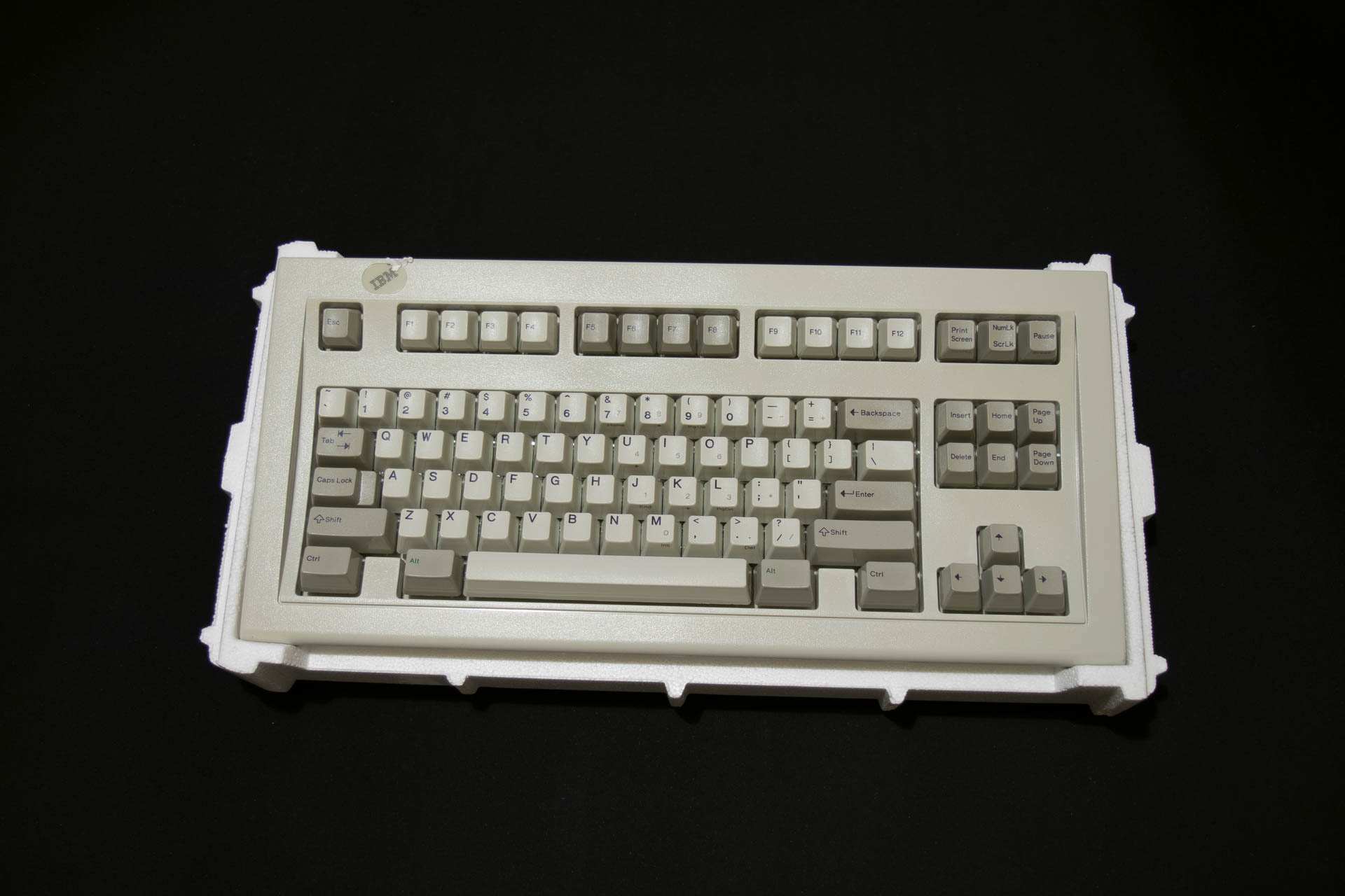

Promptly an operating table was set up and the outer shell removed to reveal the protective insides!
And..here it is!
It was flipped to show it's label
The label is covered in plastic film, presumably to protect the sensitive label underneath!

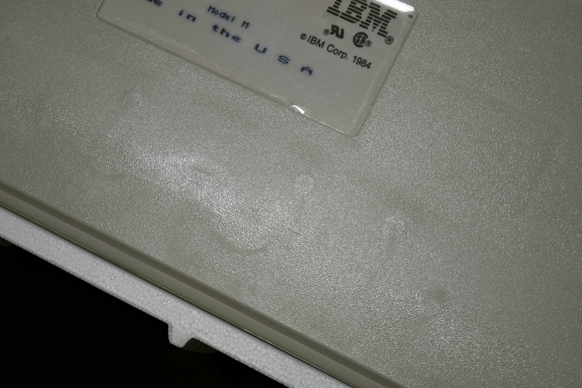

The underside shows some casting irregularities but no big deal!

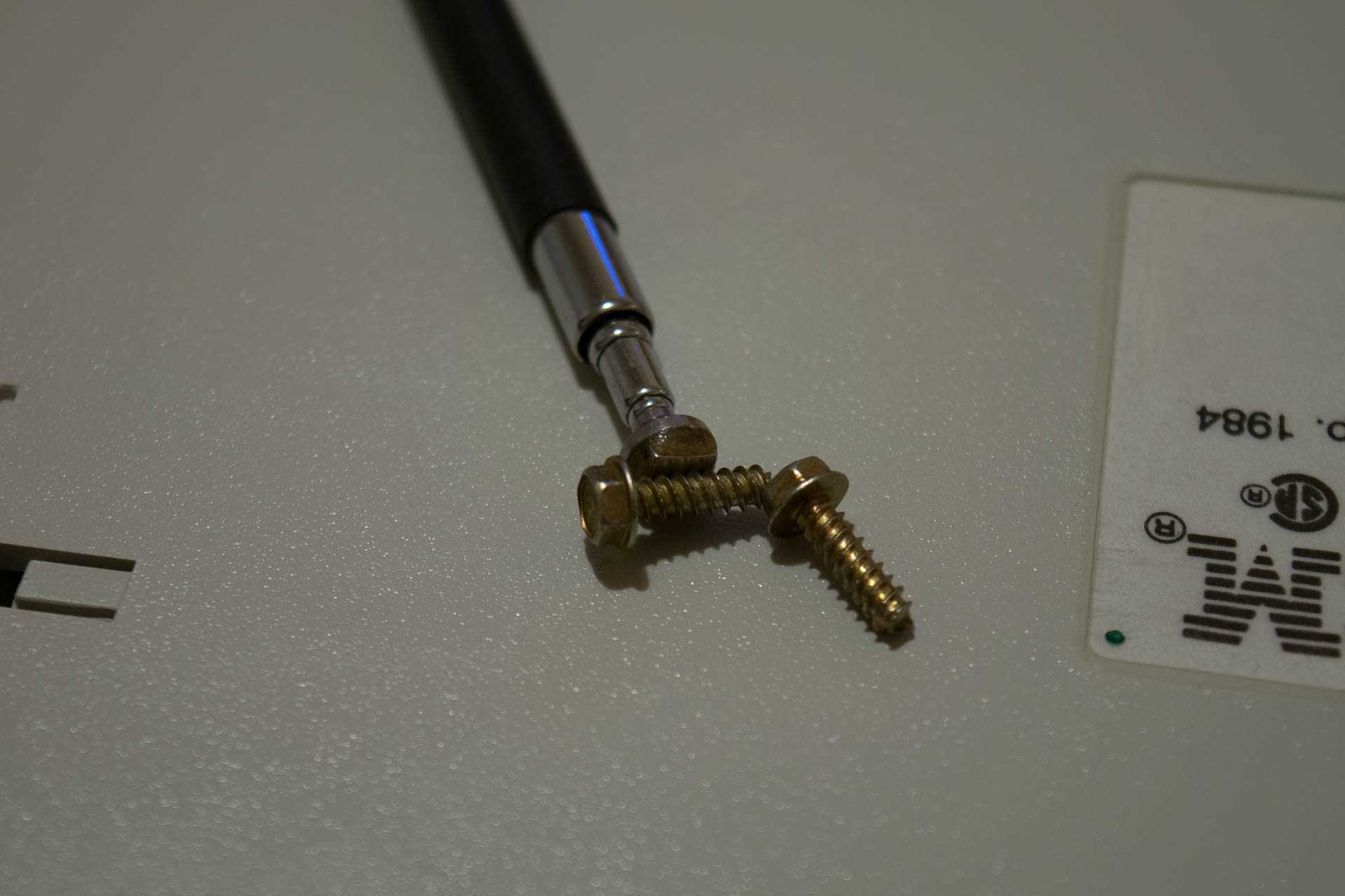

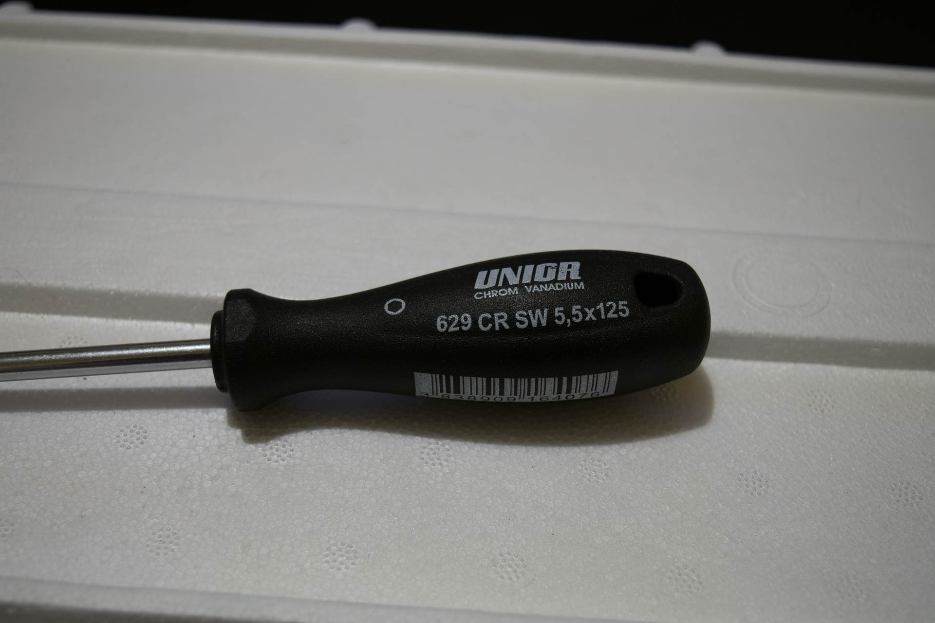

While turning it, I heard some noises inside, so out came the "Model M Violator"...
And the DIY "Metal stuff Retriever"

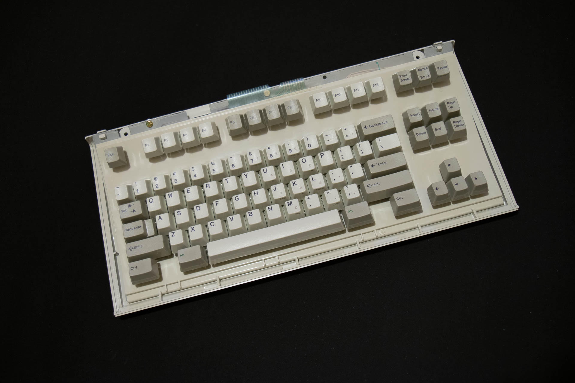

After it's shell is removed the problem becomes apparent:
(look at the membrane connector and below right Alt)

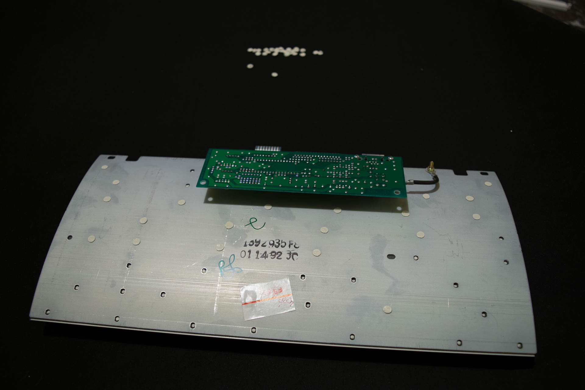

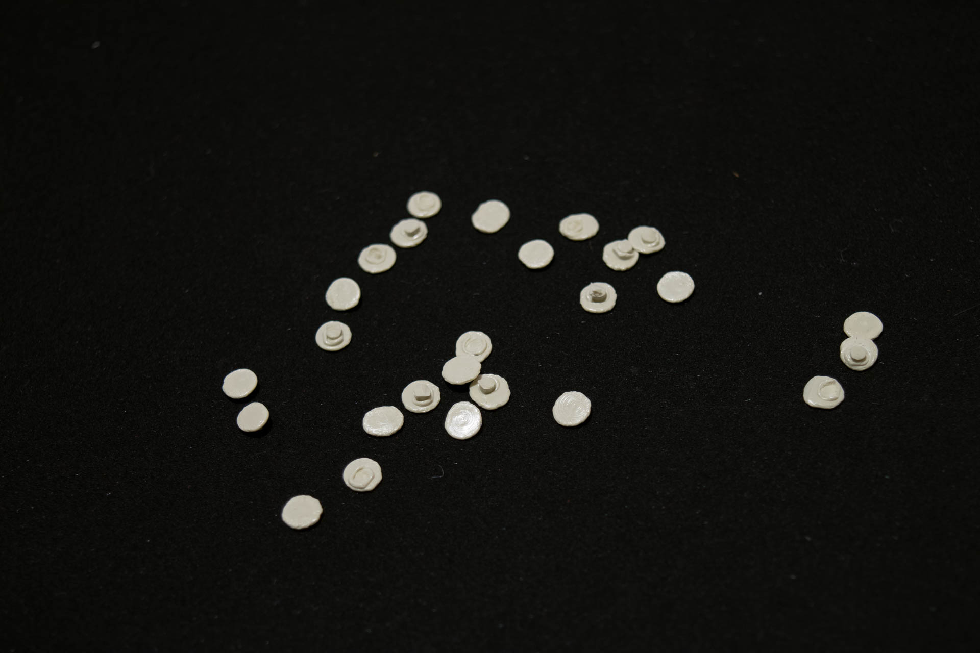

Innards removed and rivets poked with fingernail, and the result is this:
Half were already off and the rest needed just the slightest of touches...
The back of the plate clearly shows the distribution:
Funnily enough, the middle ones are intact although they are under way more stress than the others.
And even more funny, the keyboard works fine...keys are not as crisp as they could be, but still...
I am typing on it right now...27 rivets missing vs 22-23 remaining and it just won't die... :o

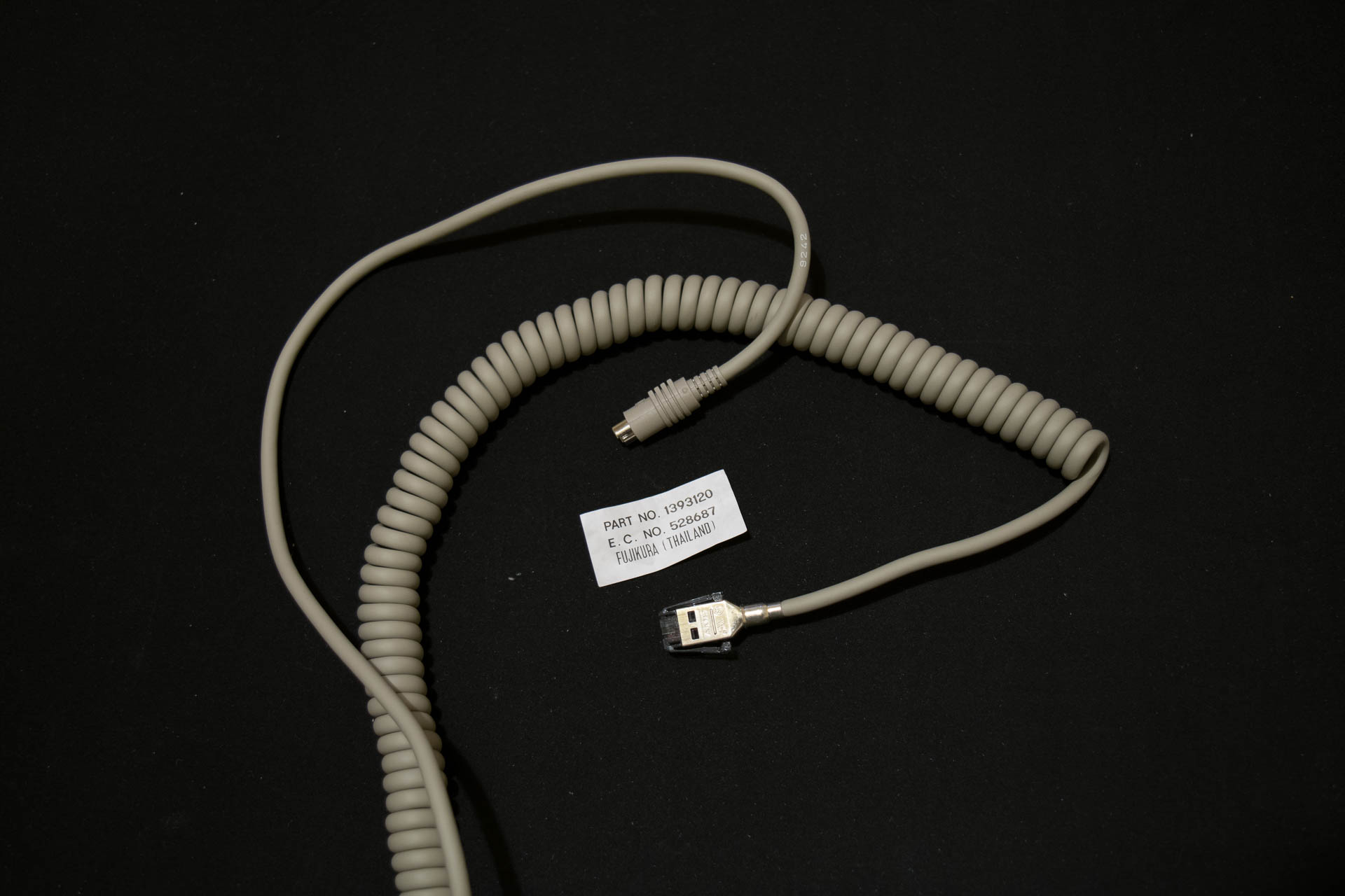

I forgot to show it's little pet snake:
NIB coiled goodness!
what I find strange is that I own serveral Model M´s, on some the exact same situation: the rivets allmost falling off by themselfs. Other M´s I own are completely intact, and it has nothing to do with the age either. Strange.
chzel
17 Jan 2015, 19:41
I guess it is just material stress and ability of the plastic to handle said stress!
My other M is a quite used 1383295 Greek one from 1990 with black barrel plate (which I must shoot some day). When I bolt modded that all the surviving rivets were super strong, ejecting themselves all over the place! Maybe some formulations are more elastic than others, enabling them to withstand the stress for longer?
Well we`ll probably never find out. I recently took a look inside a IBM 1389278 from 1989 that I own for the first time and all the rivets were super firm. But that´s a different keyboard of course.

I had something similar with regards to broken rivets, but also mine works despite this. Only one of my four model Ms have all/most of its rivets intact. It is also the only one I have with Swedish layout and thus is the only one that has not been shipped across the Atlantic at some point (recently)...
