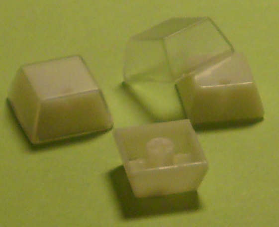

kbdfr wrote: […] prepare the new stem, taken from another keycap with a bit of the top (I use old Jarltech relegendables for that), ensuring that the stem will be perpendicular to the base of the keycap:
Image.
The Jarltech keycaps I use for that are made from a softer material which is much easier to work on, and as they have no "angle" the only thing you have to worry about is adapting the remnant of the top.

The caps I use are not flat - as a matter of fact, they are rather tall.
They consist of two parts, the one with the stem is a rather soft material and quite easy to cut with a Stanley knife.
(Sorry for the blurry pic, the autofocus of my camera is on strike)
Jarltech relegendables.jpg (51.33 KiB) Viewed 6714 times
