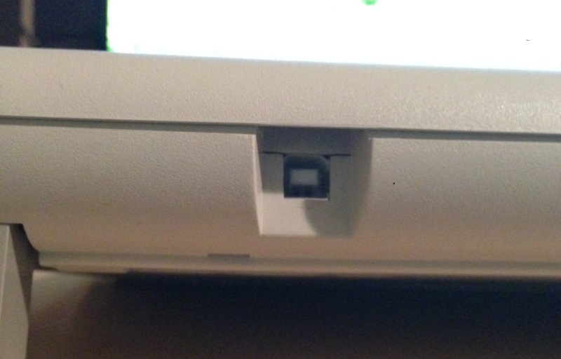

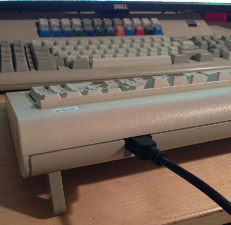

I now have it working. Soarer v1.12 with Teensy 2.0. USB port fit right in opening for cable. I've attached some pics.

- USB Type-B jack fits perfectly. No modification of the keyboard was necessary, only needed to shave some of USB plug body to make room for speaker.

- IMG_4751.JPG (148.36 KiB) Viewed 3106 times

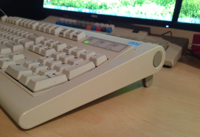

- Side shot showing Model F style keyboard stand. This one is different though-- the legs are actually spring-loaded. If you press the buttons the legs will automatically rotate outward.

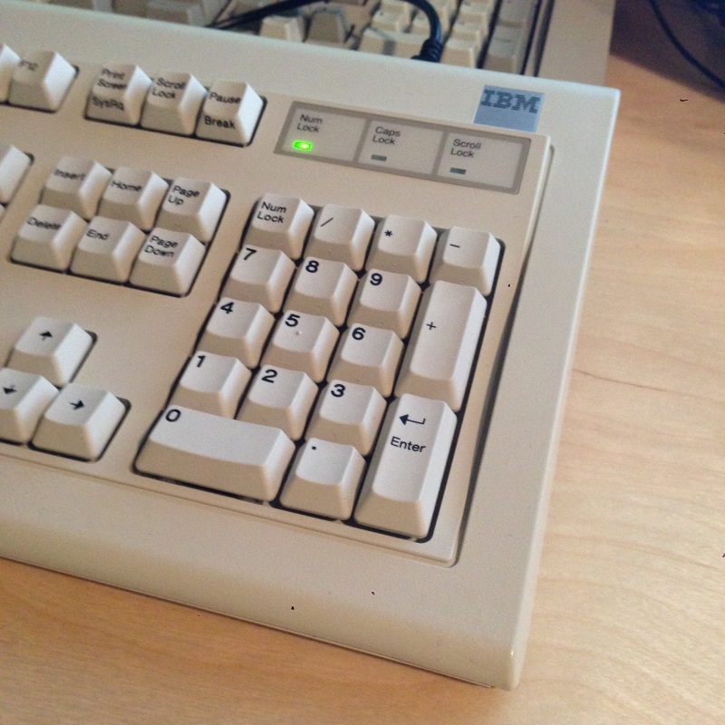

- Another shot showing numpad. Notice how the keys are all white, like a Wheel Writer III.

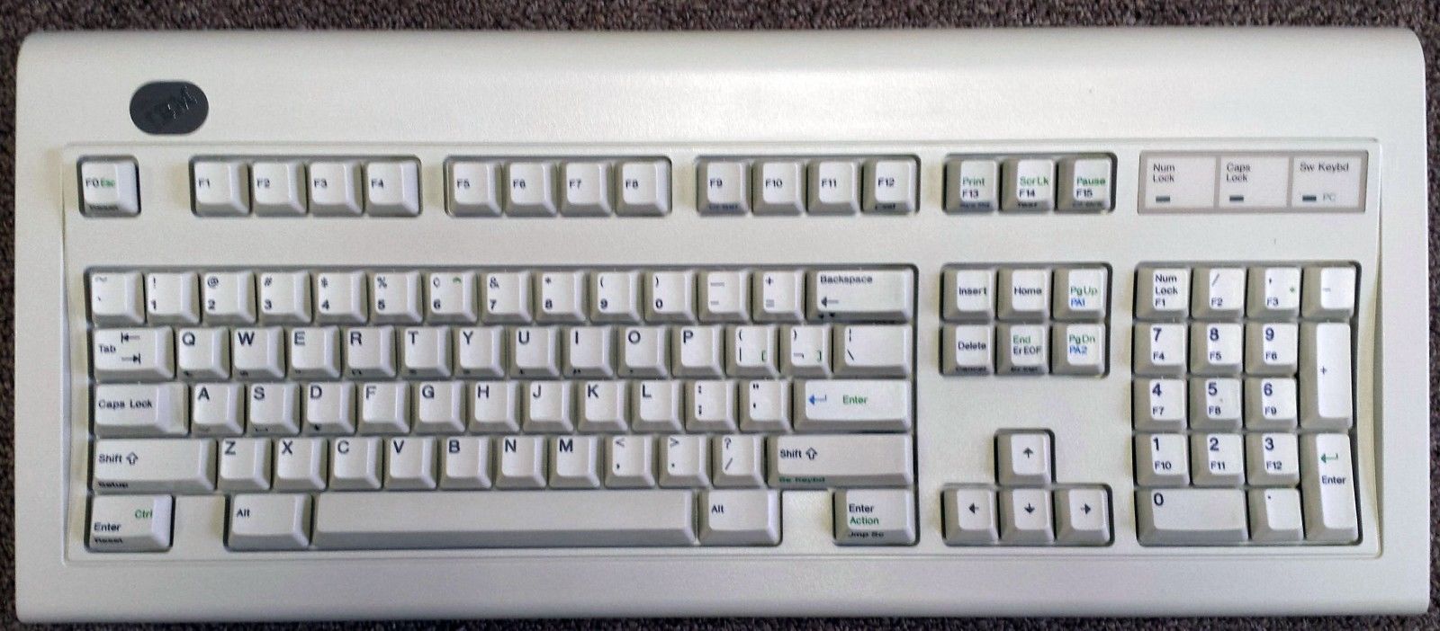

Nice find! I've been eyeing this "IBM 6247440". Similar but not identical.
http://www.ebay.com/itm/121184199564
This one is membrane based, not capacitive. I wonder if it feels any different.

That board (you just posted a picture of) do you know who manufactured it? It looks like it shares the same DNA as my '86 edition, in that the keycaps and body molding looks almost identical (the caps, the bottom body, speaker grille, etc.) It looks like an evolution of my board.

The keyboard I posted has a Brother branded membrane, I found some more photos by running a Google search for the model number. It has a membrane instead of a PCB.
