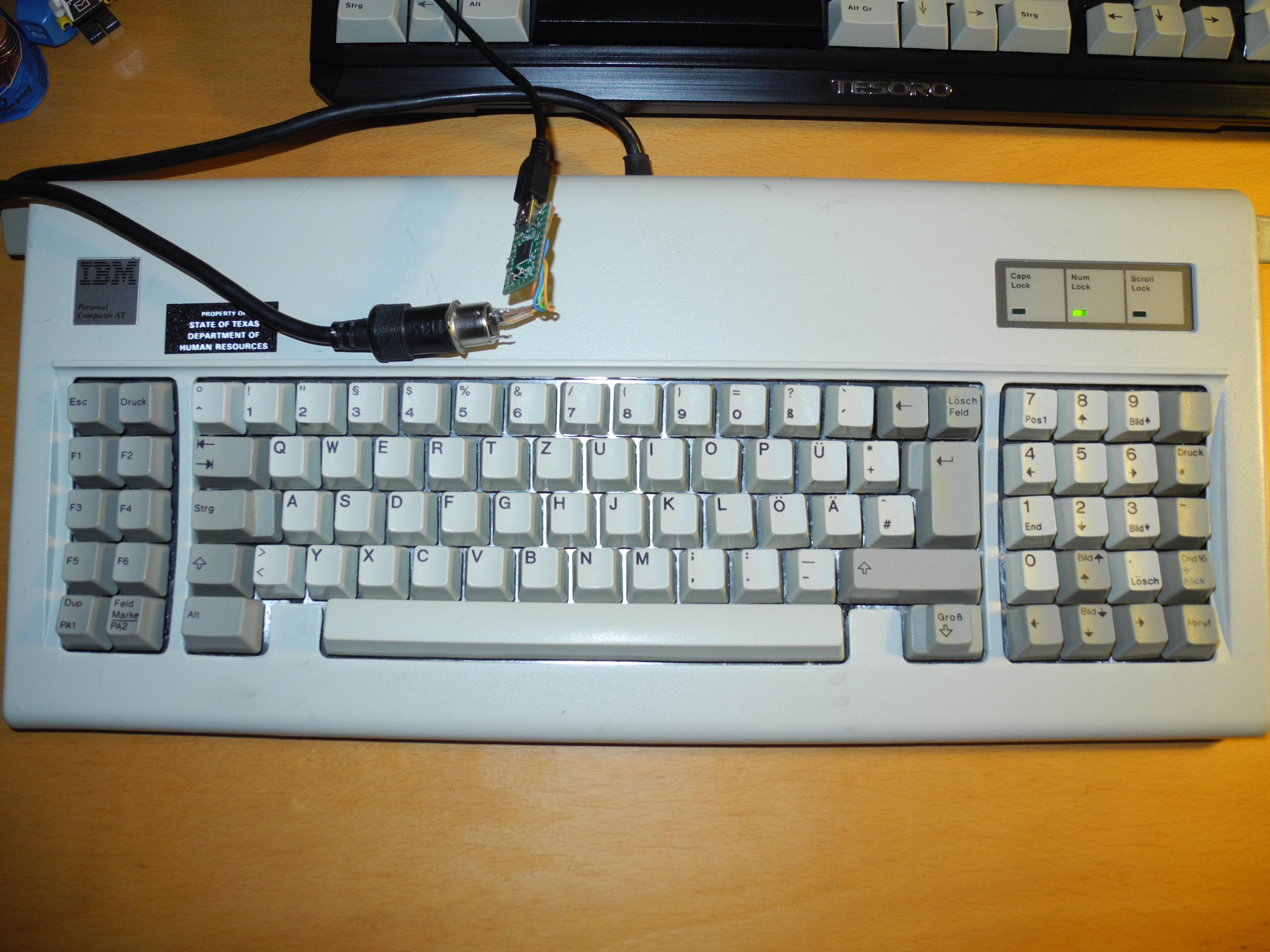

As a kind of "proof", here you can see my F AT with some remappings done with Soarer's converter:
DSCN3478 Klein.jpg (894.08 KiB) Viewed 3637 times
Rotti
21 Jan 2015, 14:14
Nuum wrote: As a kind of "proof", here you can see my F AT with some remappings done with Soarer's converter:
Looks good. That is very close to the layout I was thinking of with the arrow keys below the num pad. How does that layout work for you?

The layout works fine for me, the only problem I have is the placement of the Alt and Ctrl (Strg) key, I'll have to mod my F AT to a more modern layout some day. And as Touch_It said, you just have to add springs and hammers to the right barrels. If you want to add extra keys to the right and left to the spacebar you need two extra barrels. F AT's don't have stab inserts, they use wire stabilizers, so no need to remove them. You have to open the keyboard though to add springs/hammers/barrels.
