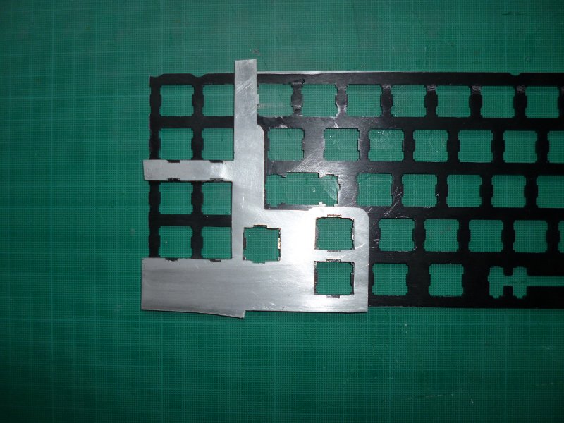

I had cut off parts of the plate a long time ago. A few days ago, after a discussion on GH about improving the TKL, I also cut it apart and shuffled stuff around on the right side to add spacing around the arrow and nav clusters. I reinforced the plate on the back with some sheet aluminium, hand-cut and epoxied on:

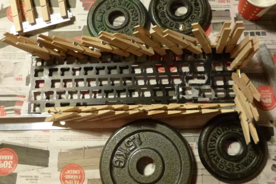

The idea for the case is simple: Each side wall is supposed to be a bar of aluminium with a slotted groove for the plate - all put together with epoxy. Then the bottom is supposed to be a simple metal rectangle, bolted to the plate through stand-offs in-between. When a key is pressed, the force should be on the standoffs, not the case walls.
This is then supposed to be painted, so I don't worry about there being visible seams: I would simply fill them with putty before painting.
However, I could not find any aluminium profile with a groove, or any way to make a 1.5 mm wide groove myself. I did find a type of narrow L-shaped aluminium profile though, which I could complete with a metal bar. I could only find the right dimension of bar in brass. I also decided late to use slotted parts of L-shaped profile in the corners to add rigidity and more glue-area.
I have cut the side walls and started to glue them together... This will have to sit undisturbed to cure until tomorrow night:
Then tomorrow, I will get on with gluing the rest and adding the partitions between key groups.

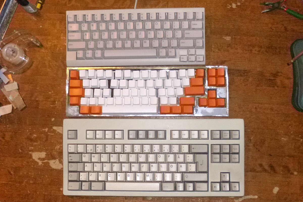

I am shipping the HHKB Lite 2 soon, so I wanted to get a comparison shot while I could.
Here are also the keycaps that I am going to use, and you can see the HHKB/TKL-hybrid layout a little better. The caps are laser-engraved from WASD Keyboards, back when they offered engraving. I had also got green modifiers after I had seen how good CCnG caps looked. The case will be painted white to match.
At the bottom of the picture is my daily driver: a Phantom, where most of the case has been built from a BTC 5140.

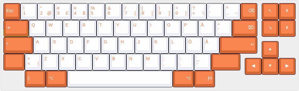

I am changing the layout. My original idea was not to have any partitions between the key groups and with a right Control key on the bottom row, but with partitions it would look weird with a 0.25 step and I don't think that I really use the right Control key...
Away the key goes.. This is now a 68-key keyboard.
The bottom row looks more symmetric, but at the same time a little bit too much to the left. The cursor keys on the right look as if they are further away. The layout is not symmetric anyway: the two Alt keys have different meaning.
While I am at it.. should I split the space bar? :?
If I did, I would cut the key exactly in the middle and glue new stems on the inside. It would also require some cutting in the plate for new stabiliser and switch positions.

Is there any reason you put the navigation cluster not in the bottom row?
07 Feb 2015, 22:00
I think it would be more ergonomic to have the arrow cluster closer to the home row.
The idea was also that it would provide lots of continuous space for a controller in front of the cluster. A Teensy (or even a Teensy++) fits in there without having to strip the USB cable. The space is quite narrow though, so it would have to be mounted diagonally.

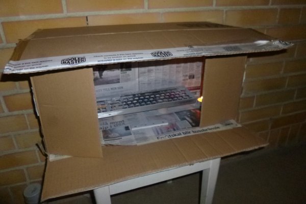

This is how you spray-paint outdoors in the middle of winter: you do it in a large cardboard box with some lit tea candles inside.
Let the spray can sit in a bucket of hot water, and let the box warm up for a while before you spray. Don't spray at the flames or you will get a fireball, although that sometimes can't be helped. :oops:
I kept a thermometer inside. Even though it was below 0°C outside, the temperature in the box was kept around 15-20°C.
Thanks to Cooler Master for sponsoring my paint job (in a way) by having given me the box for free! :D

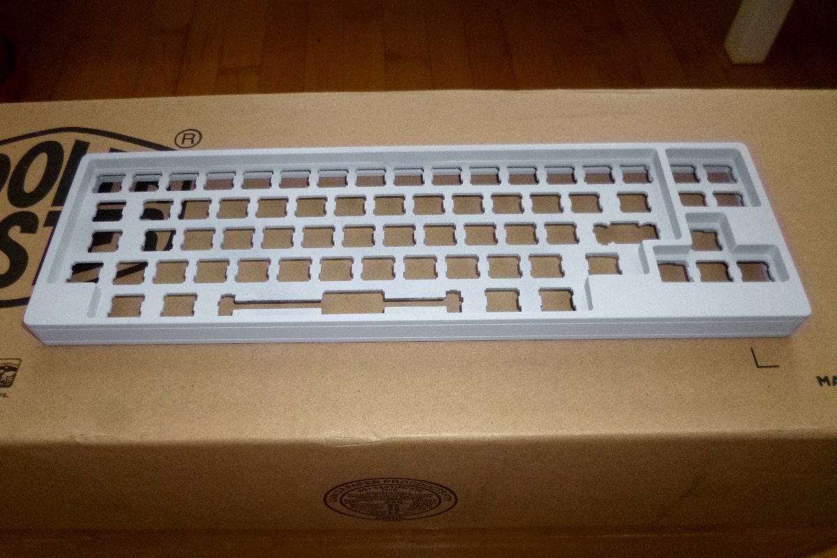

That was only the first layer of aluminium-primer, to make the flaws stand out better and provide a surface for filler.
Then I sanded, filled gaps with Milliput (an epoxy-based clay/putty), sanded some more. and made the internal corners rounder with more Milliput. This stage took a lot longer than actually building the frame.
Then after the second layer of primer, it looks like this:
The grooves were on the alu profile from the start, and kind of gives it the look of being layered don't they ...
The new layer of primer has exposed more small stuff to sand/fill, and the next time I paint with primer it should only be in a few tiny spots.

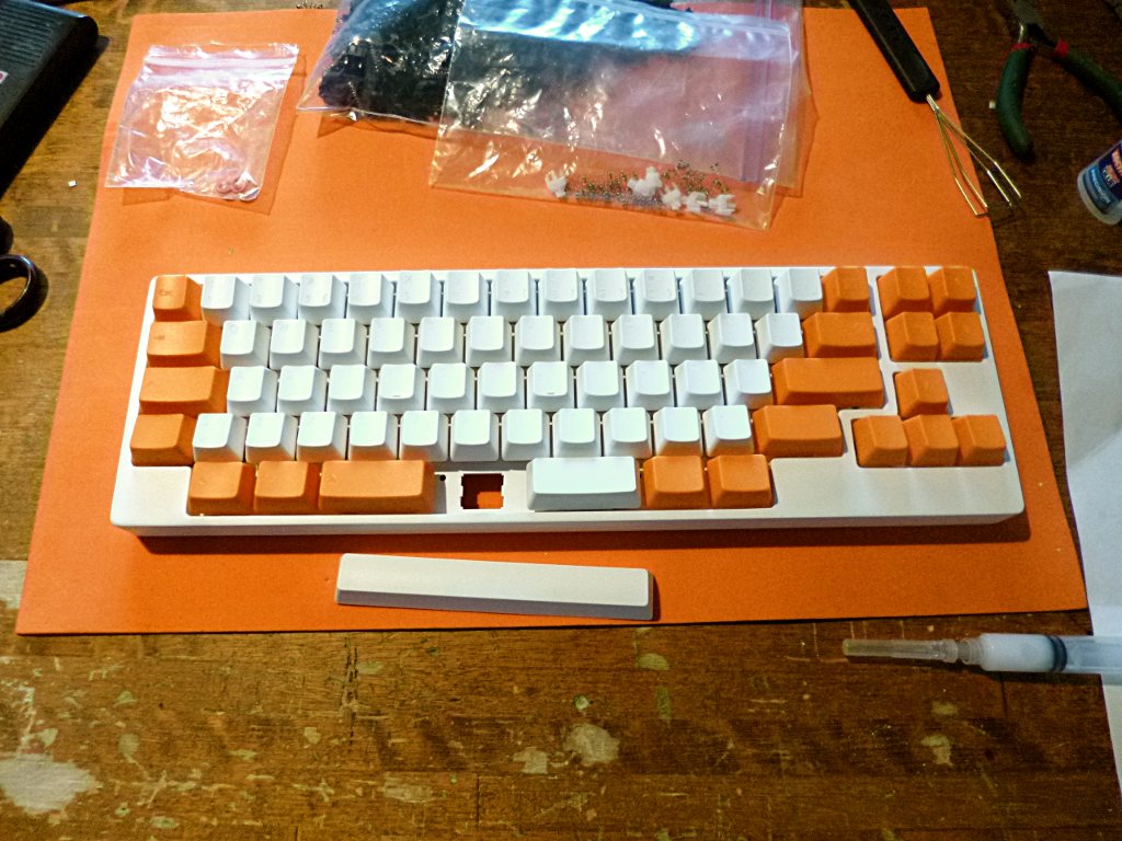

All stabilisers installed. All Gateron switches installed with lubed Cherry MX Clear sliders and springs.
In almost all switches, I also installed a small piece of plastic inside the snap so that it could not be pulled out.
Unfortunately, a couple of fillings I had made in the plate's extra-large switch holes broke out when I had pressed switches into it.
I tested typing... and found that my right thumb lands on the very edge of the Space key. This means that
that key has to be enlarged to the left.
I am thinking of replacing either the Space key or both it and the "Erase Eaze" key with a Space Bar that
has got additional stems and been cut into two pieces.
But how should I cut it?
- Right in the middle, giving two space bars of identical size, or
- Somewhere to the left, leaving the additional Backspace key alone?
How much could a keycap jut out from the stabiliser's stem before the key becomes too wobbly?
If I do the latter, then maybe I could use an empty switch in the centre switch hole to help stabilise the space bar.
