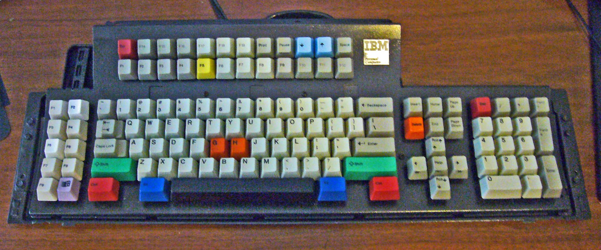

- F-122-open-001e.jpg (450.77 KiB) Viewed 2207 times

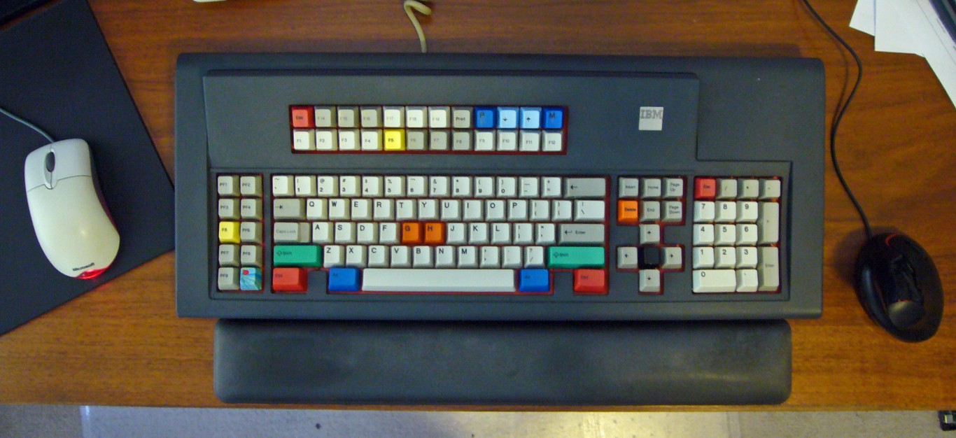

- F-122-002m-unicorn2013.JPG (199.5 KiB) Viewed 2209 times

ahh ansi conversion on model F 122 good man, no number pad tab key tho disappointing all the cool kids have them. Looks very nice where did you get that key on the bottom right of the left hand F keys ? ( second picture)

What I would really like to have on the numpad is a comma.
That "Windows" key was done by my daughter with fingernail polish and I put a blob of red on it because the legend was still showing through.
