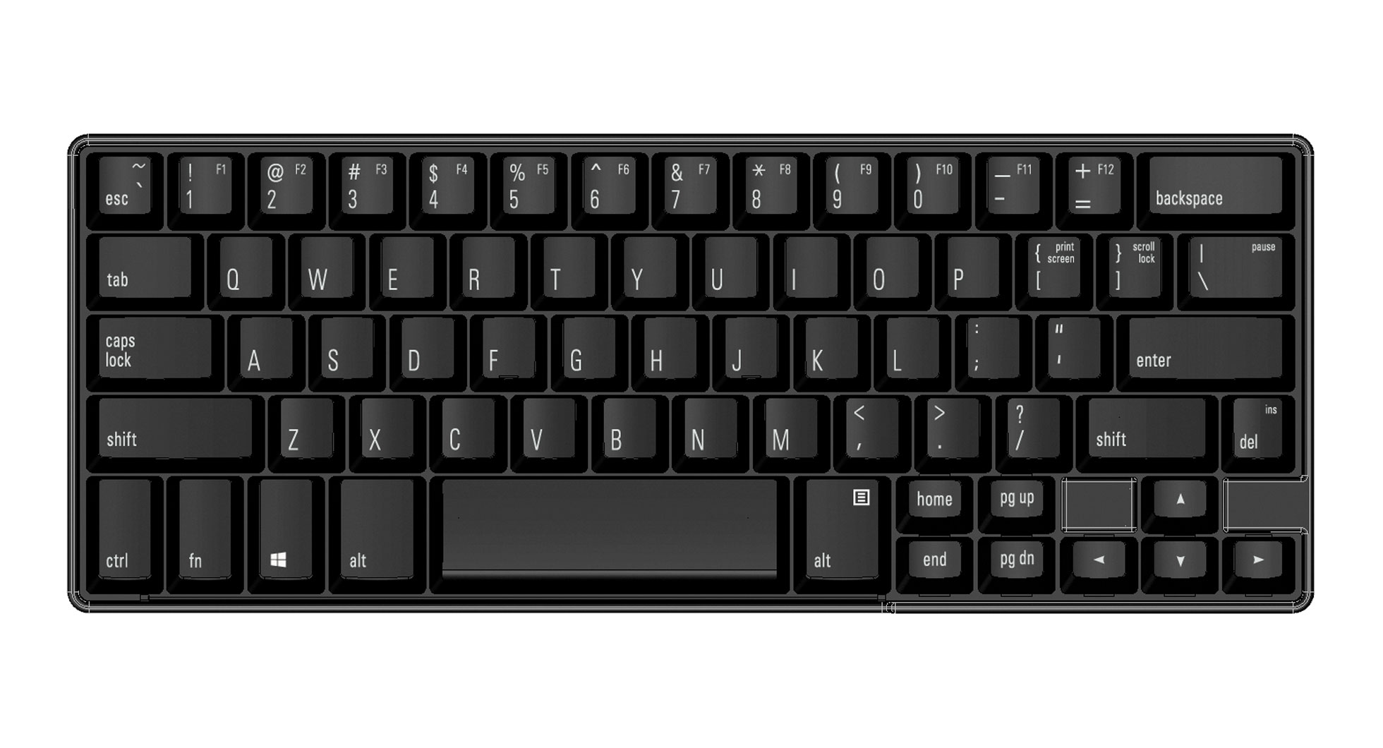

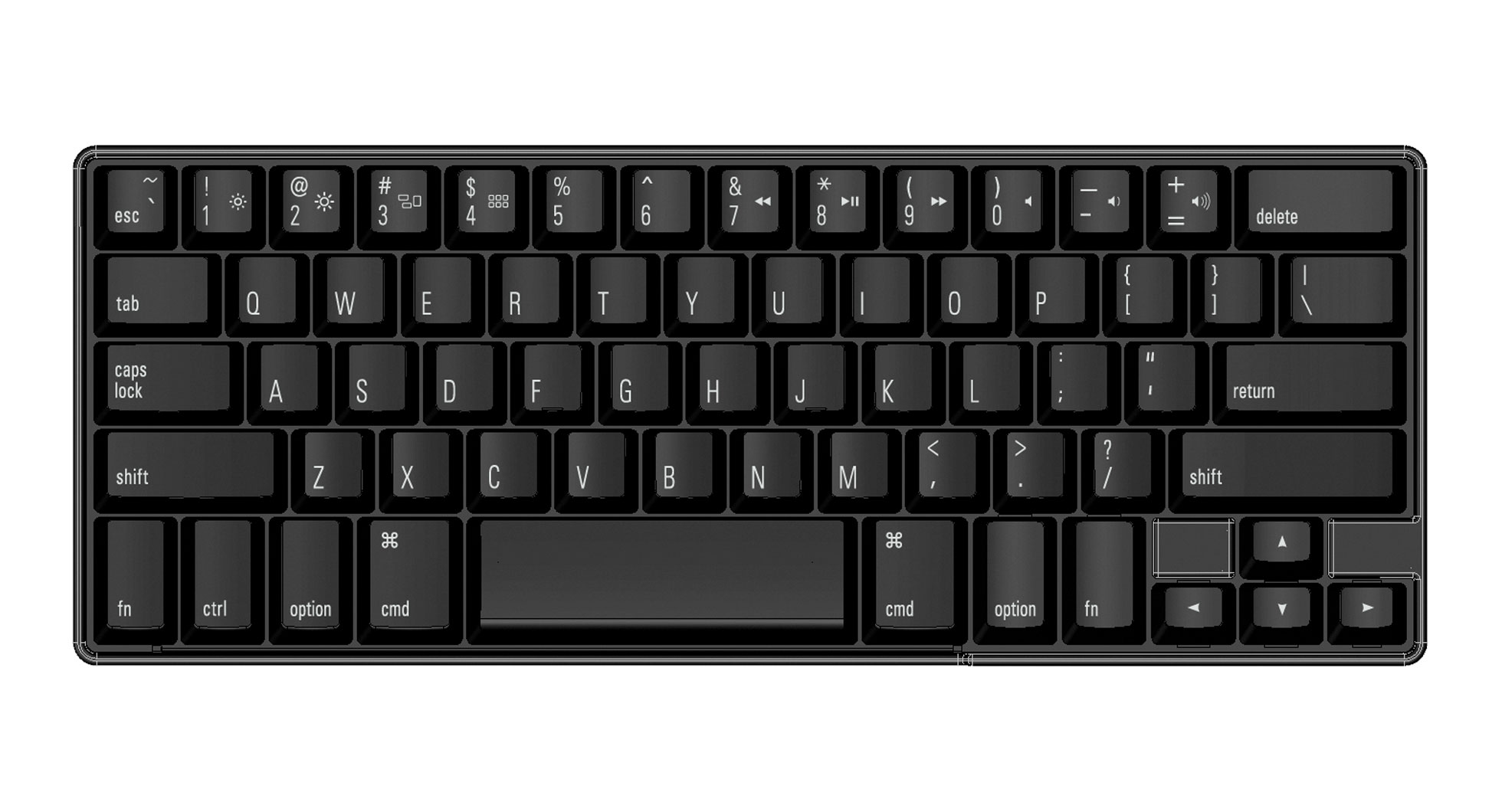

I am considering ordering a Matias 60 keyboard, despite the strange configuration of the bottom row. There are two layout choices: PC and Mac; and three key switch choices: Click, Quiet, and Quiet Linear. It will be possible to toggle between Mac and PC layouts via a DIP switch setting. However, it is not clear how this might affect the Navigation keys in the PC version, i.e., Home/End and Pgup/PgDn.
Despite the strangeness of either layout, which of the two would be preferable and why?
PC layout:
Mac layout:
09 Feb 2015, 02:01
I think I would prefer the PC layout for a few reasons:
- On the Mac layout, the left-hand function key is to the left of control. I'm used to this from my Thinkpad, but I think I would find it irritating on a desktop keyboard.
- The PC version has a "HHKB Fn". Edgar Matias himself previously said that he would be open to sharing schematics etc. to enable users to add their own controllers. Even if this proves to be difficult, it could be remapped in software. This is a major plus for the layout for me.
- Dedicated PgUp/etc keys are nice but probably not optimally placed for my usage. Then again, I don't use right-hand mods very often so they might be nice to have.

Accepting the horrors of the super fat bottom row, the PC one is better in every respect besides the legends (ugh, Windows key). Well, if the well placed key currently masquerading as Delete were Fn. Although I will definitely buy neither!
Do we use Page Up/Down and Home/End on Macs? Yes! So why lose them? Surely only the mods should be differently labelled.

Legends are of secondary concern. It will be possible to swap keycaps, and I might opt for blanks for the mods and nav keys. In addition, the bottom row will be PBT and, depending on the number of units sold, the keyboard will be increasingly populated with PBT keycaps.
If I can decide on a layout, this leaves only the choice of switches. I've ruled out the Quiet Linears, because I prefer having tactile feedback, which both the Click and Quiet switches deliver handsomely. The Click switches remind me of IBM Model F, and the Quiet remind me of silenced Topre but with more tactility.

To go back to the subject in hand; I would go for the PC layout, as the additionally keys make more sense to me, especially if you can remap the small delete by the shift to be function as well.
