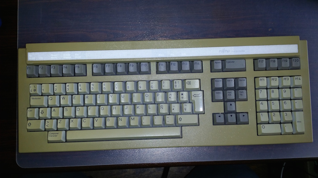

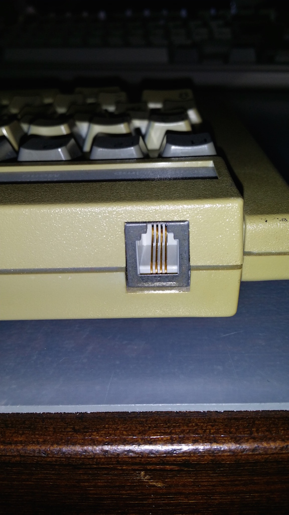

Hello, I am a new member (from Spain, so sorry for my poor english).

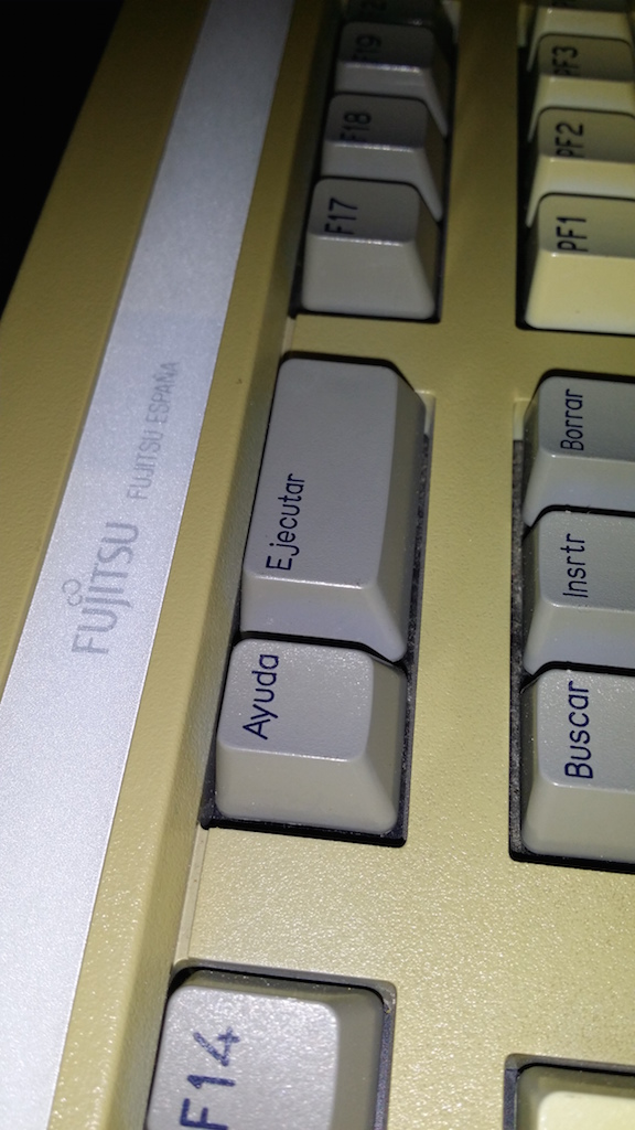

I have several old mechanical keyboards and I love them (IMB M, Olivetti ANK, Dell, etc...) and... a FUJITSU terminal keyboard (¿4p4c?, I do nor know the model). I would like to make it possible to work with my modern computer (windows xp or 7, or mac). I have been reading from Teensy & Soarer's firmware... Does anybody knows if I need to buy this Teensy & install (I do not know how) this firmware. I upload some pics from the FUJITSU KEYBOARD.

The layout is the same as for DEC terminals which were very popular at the time.
That looks like a Wyse terminal keyboard. It could be compatible with their General Purpose Terminals, but I don't know. I think there could be different other keyboards with the same layout but different protocol.
09 Feb 2015, 13:09
*If* it speaks Wyse protocol, then you can definitely convert that to USB:
http://deskthority.net/workshop-f7/wyse ... t7424.html
