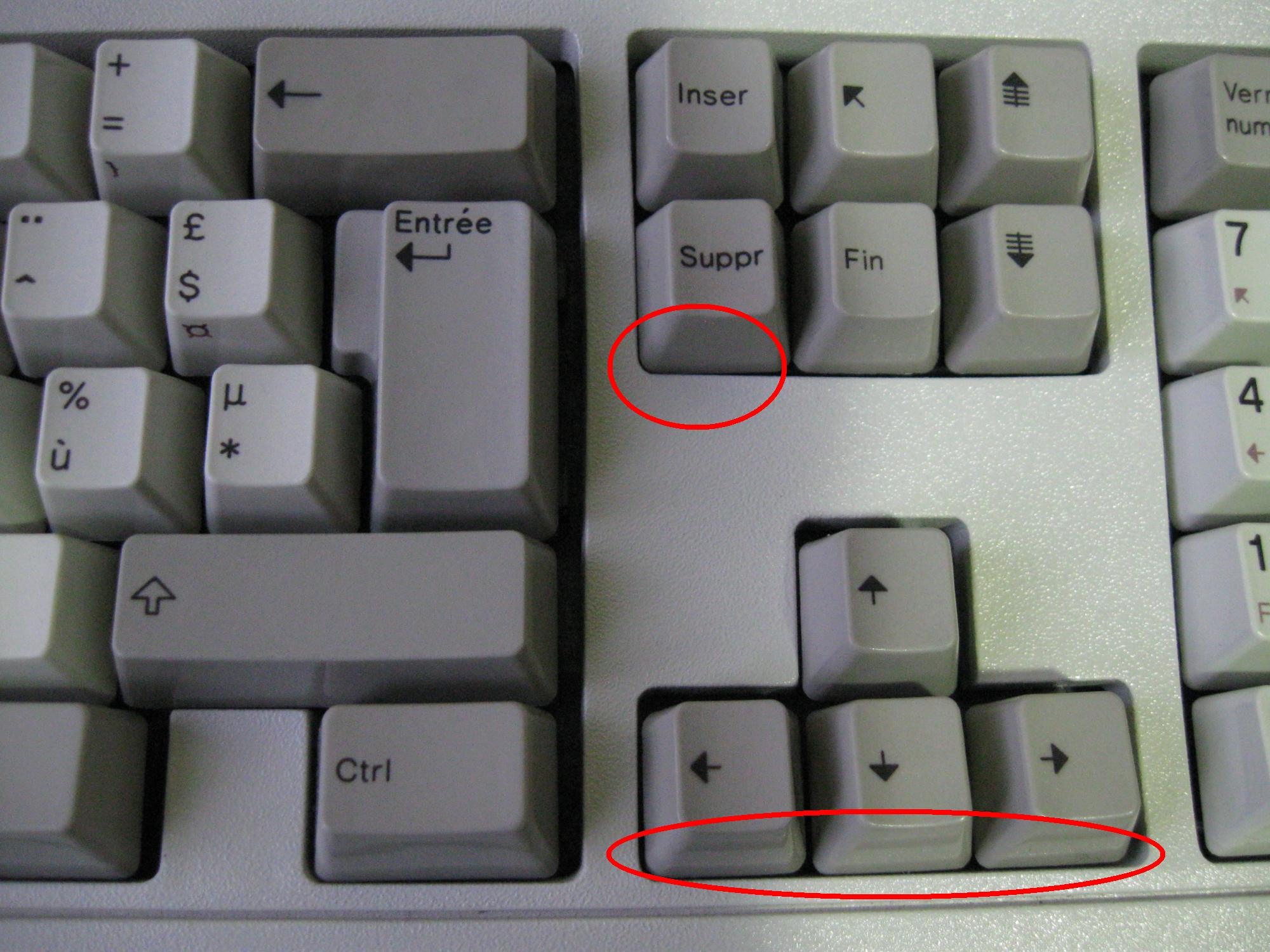

I recently found an AZERTY Model M that I cleaned and tested today. Everything is in working condition and there is only one missing rivet; the rest are still firmly attached. It's a black label Model M with part number 1391402 from 1989 that has been laying around forever in the storage room of my boyfriend's parents. I wanted to clean it and offer it to him, as I already have a US ANSI Model M (also from 1989).
Now, the problem: as I opened it, I noticed the upper case was deformed at the front part: the two middlemost of the plastic clamps didn't clamp on the lower case. At the same time, a few keys were stuck (they could be depressed with a lot of difficulty): Delete, Left, Down and Right arrow keys.
Here are the keys that get stuck:

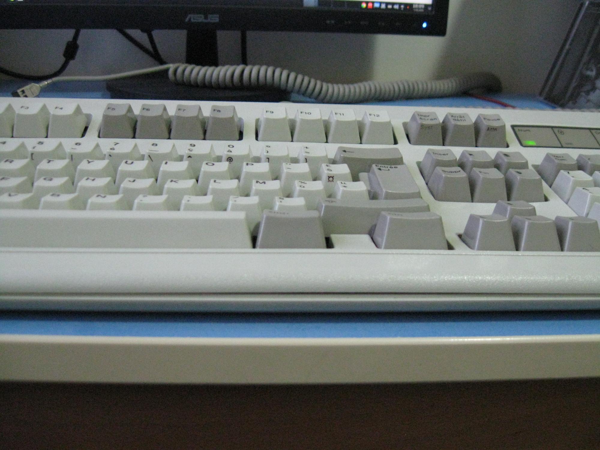

Here's the gap between the upper and lower cases:

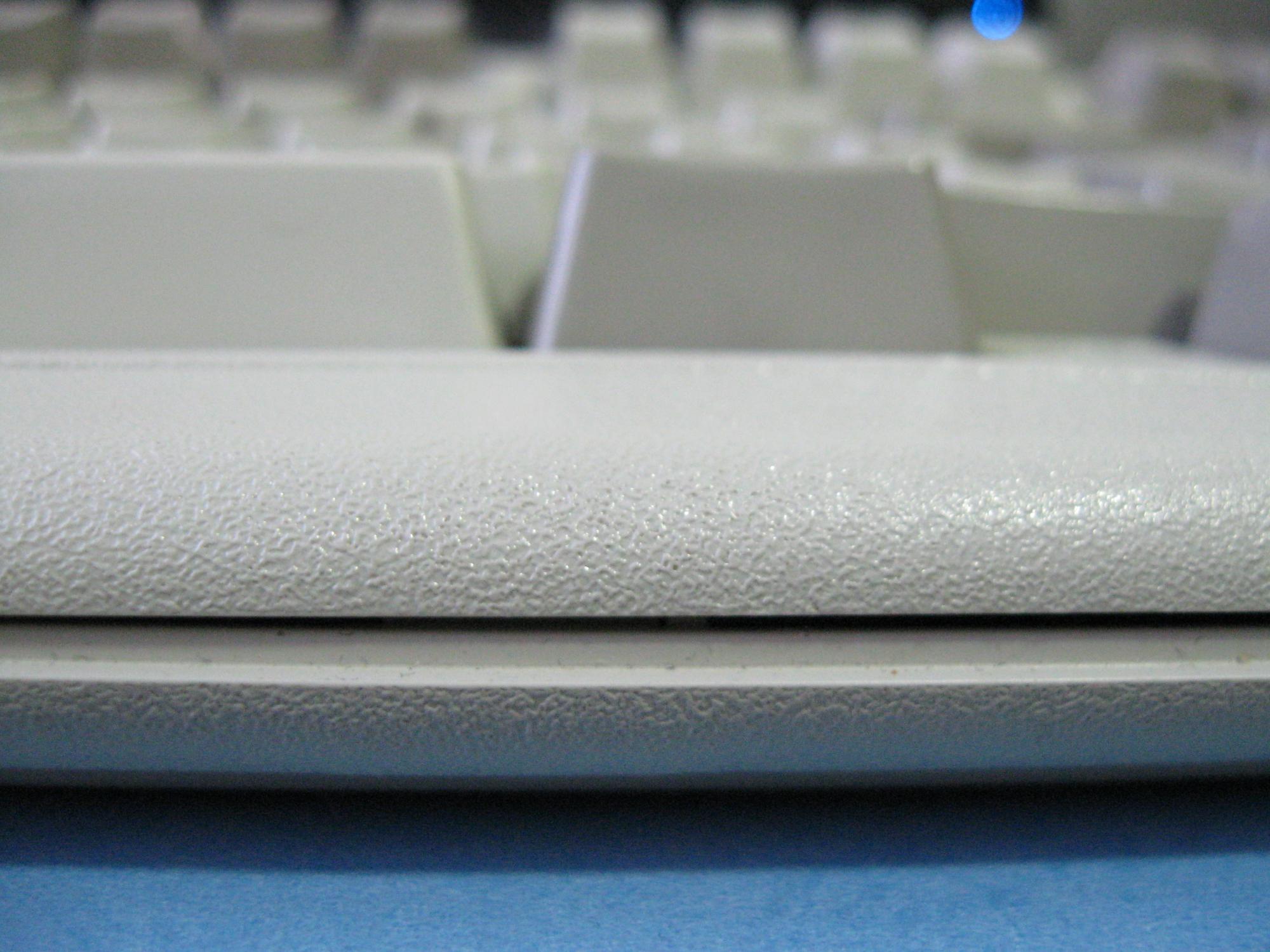

A zoom-in:
I thought it would be OK when reassembling, but it's not. I cannot make the two middlemost clamps, well, clamp. This is what makes the aforementioned keys stick.
I temporarily replaced the upper case with that of my Model M and everything is alright, which means it's only the upper case that is deformed.
Do you think I have any other option besides buying a replacement case? :(
