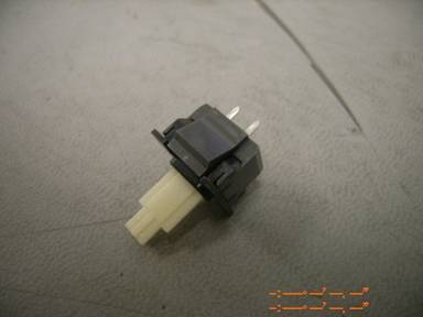

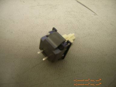

Quest Components stock Alps SKCCAF002A — I enquired about datasheets, and they sent me a couple of photos of the switch:
The datasheet he attached was for something else, so hopefully the chap just grabbed the wrong PDF.
The TI-99/4A is the first and only keyboard to date that actually confirms SKCC from the PCB codes (KCCBA082/12KC190B):
http://www.ebay.com/itm//281571442793?orig_cvip=true
To me, these appear to be the normal height switches, implying that both short and tall are SKCC as expected.
I'm still interested in that datasheet, but I think the evidence is there now to indicate that vintage tee mount is SKCC Series.
