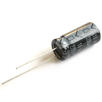

Apart from moisture sensors (I've never seen one on a keyboard) the only water sensitive components are electrolytic capacitors. You risk washing away the electrolyte which is a Bad Thing when you power on the board. These are the components that usually fail first on most consumer electronics. They look like this, with either one lead at each end, or two on one end:
Transistors, diodes, ceramic resistors and capacitors, ICs, and most other components are extremely well sealed.
Your best bet is to desolder the capacitors, give the board a bath, and replace them. Ideally use new replacements if you have them with the same ratings.
