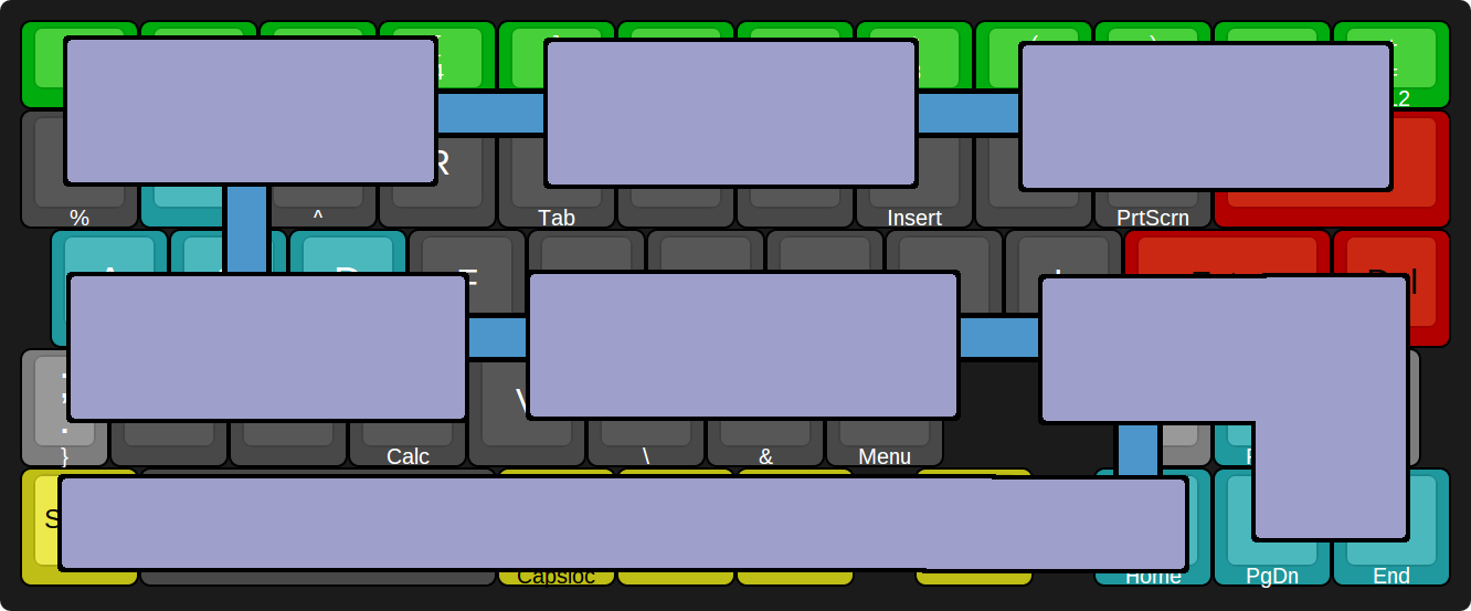

Well, I was thinking I was going to go with 7 PISO shift registers, each with (up to) 8 inputs daisy chained together. Like the image attached (the less saturated blocks are the shift registers and use the keys they touch as inputs, the brighter blue are the daisy wires, teensy would likely go at the top-right). I might go with SPI as someone else suggested.
I wish I could connect it to multiple pins (so there are multiple smaller daisy chains). If I could go with 2-4 serial connections if I could. It might be a bit more complicated, but I've also thought about using multiple serial connections (like SPI AND I^2C) to do just that. Can I have 2 I^2C connections? Regular serial and CAN bus maybe (would these just be asynchronous)?
Also, I might even use analog in addition to all that, I don't know yet. You're right, it's over-complicated, but probably so is making a keyboard on its own, going out and buying a keyboard I don't like is the simple solution ;)
