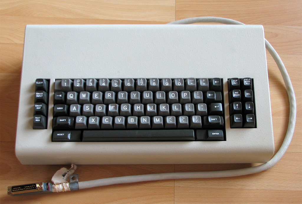

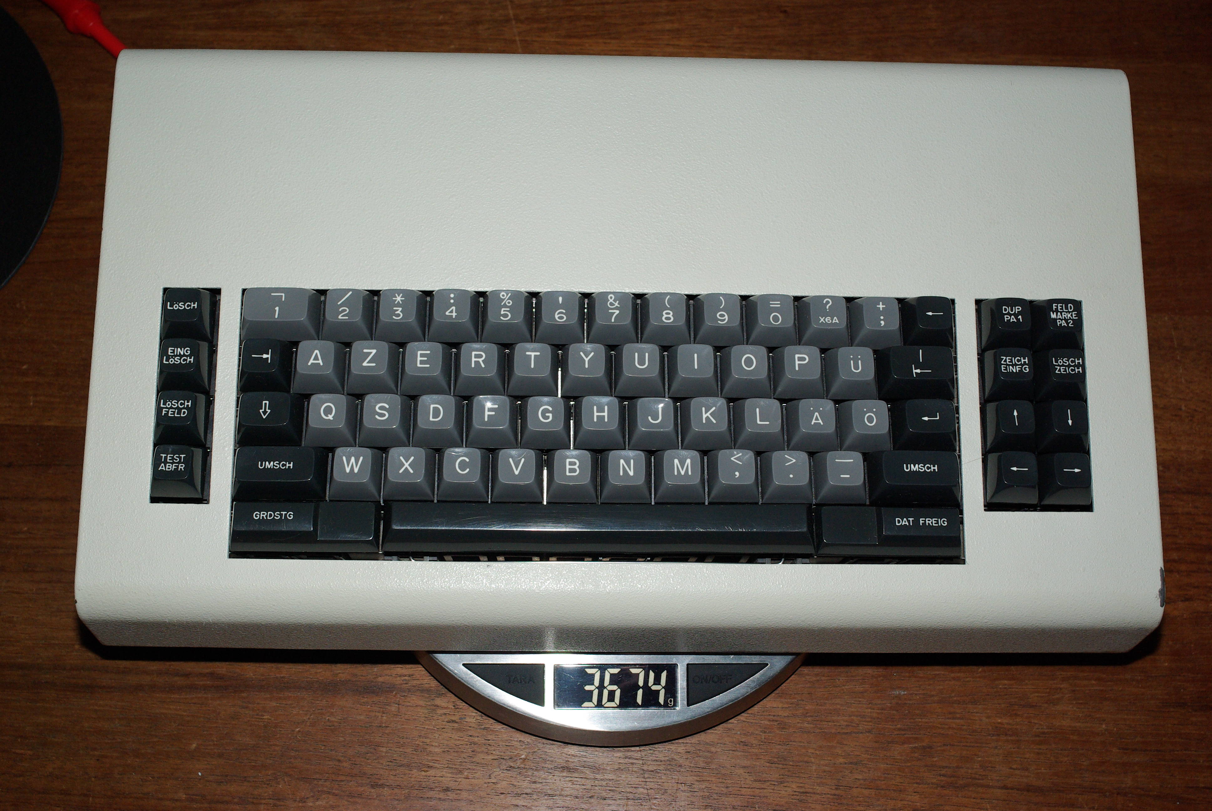

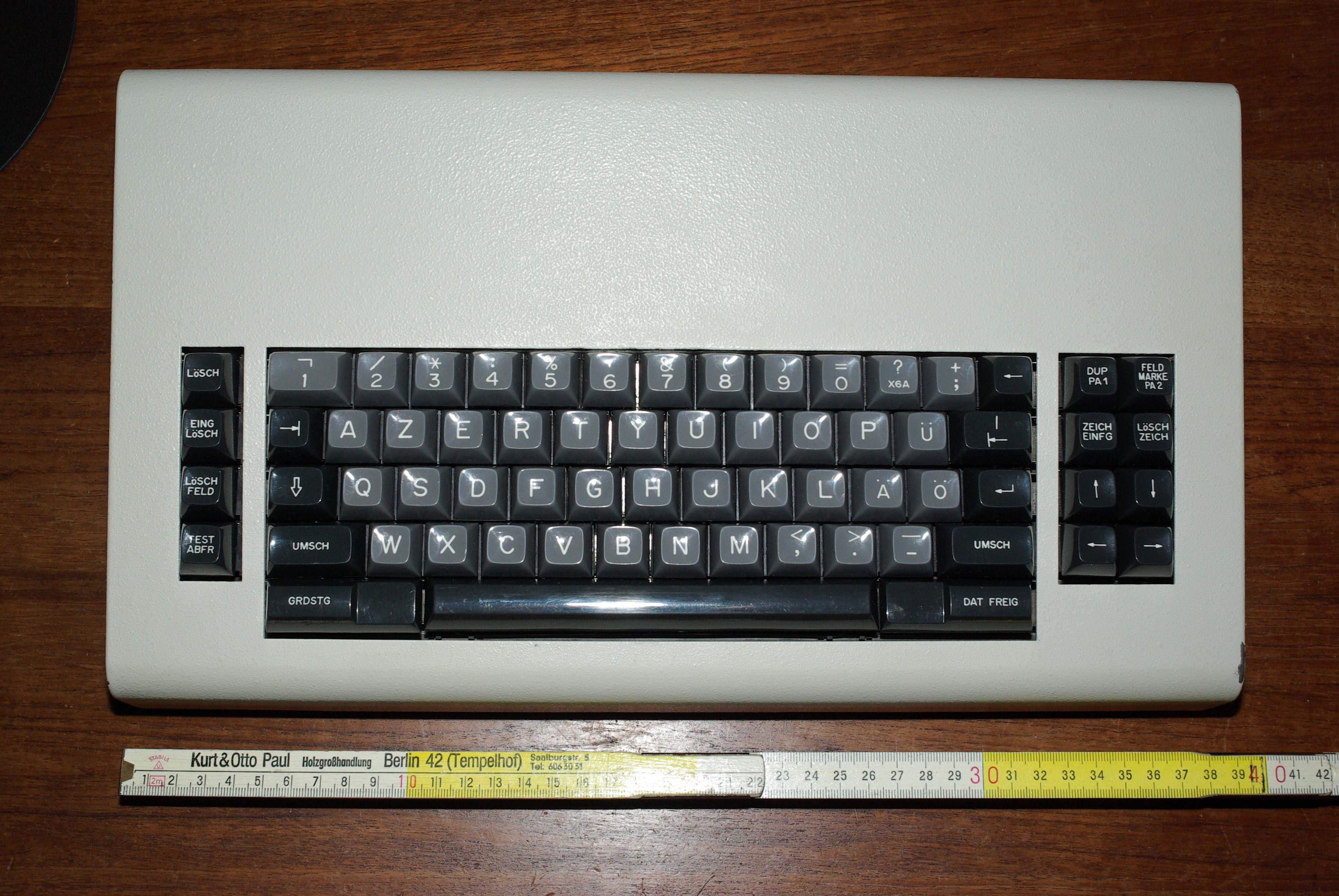

a few of you knew I bought this a couple of weeks ago. I'm not so sure if this is worth what I paid for but that's really not measurable right? I'm not sure how I like this keyboard at the moment. It's just soo different from all the keyboards that I own up to this point.Anyway this a MICRO SWITCH Keyboard from 1976 made in Freeport Illinois USA.I cannot see a production date. Maybe one of you knows more. I'd really like to know how old this is. There are a few different production numbers on the case, the PCB, the plate, the bottom plate and the cardboard. I do not know which one is the model number. You can read more about the switch right here which I believe to be the same switch.
http://deskthority.net/photos-f62/1977- ... t5395.html
It seems to be a linear hall effect switch. It feels like it needs lubing but then again how should I know? The keycaps are beautiful. These are the nicest I own. The case is made of solid metal, the bottom plate of even thicker metal. You can see the approximate weight in one picture, it´s built like a tank. The dimensions of the keyboard are (to me) insane. It's small yet very bulky.Remember this is my first really "old" keyboard. If and when I will be using this a wristrest will be a must!From the looks of it the external cable has been forcefully removed. The keyboard sits on thick round rubber feet. What is that piece of cardboard on the PCB for? One of the screws of the case broke when I opened it, I cannot get it out of the case at this point. It will not move. Ideas? The case has some wear but overall the keyboard is in good condition for it's old age. Yours looks nicer Webwit! The one thing that really strikes me are the dimensions. At some point in keyboard production history there must have been a drastic change of how big a keyboard needs to be, probably due to technological advancement in production etc . Of course I knew this before but having something like this sit right in front of me underlines this greatly. I cannot find very much online about this switch and almost nothing about this keyboard. I have read the information we have here at DT on Honeywell Hall Effect and there are a few threads at geekhack. I wish you all a merry Christmas holiday if that's part of your lifestyle. Cheers.

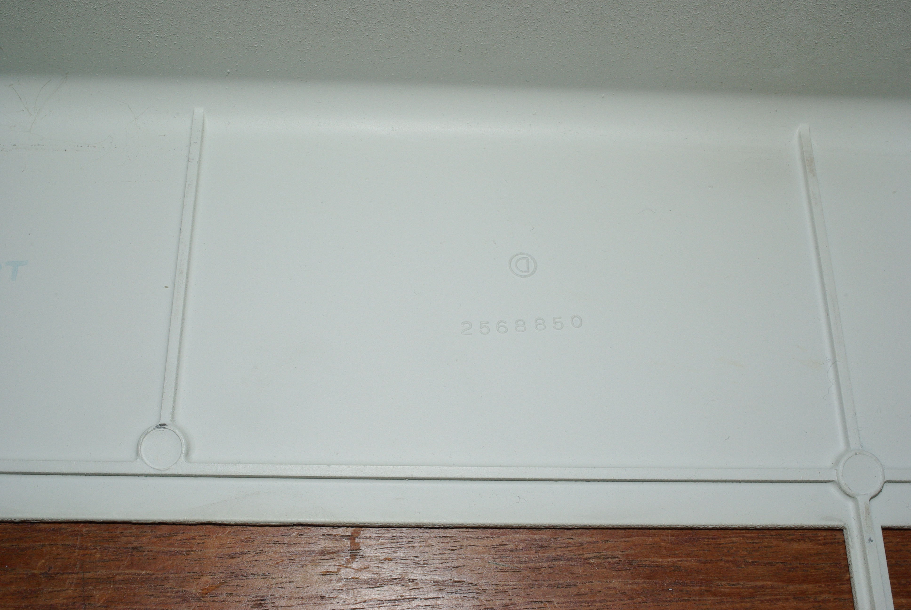

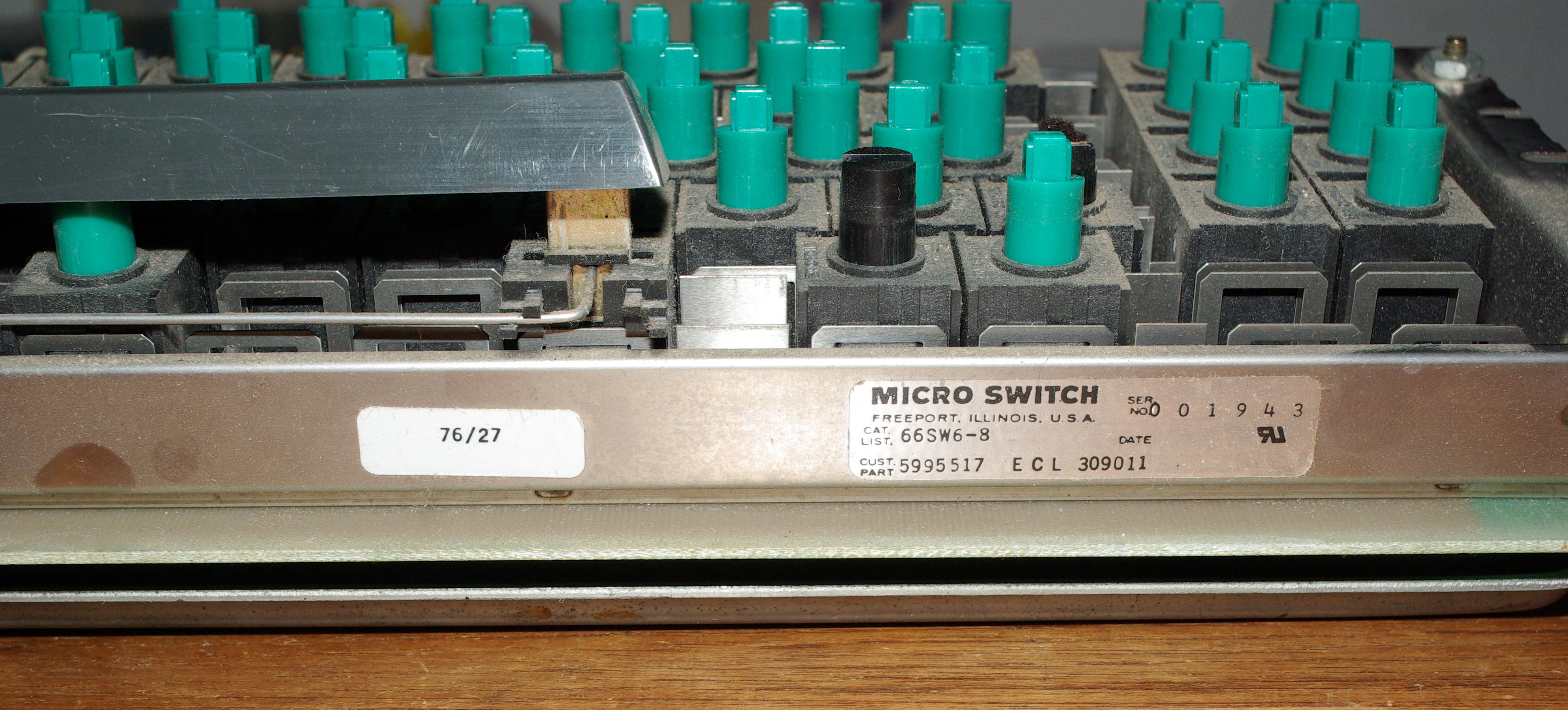

ok that little sticker on the plate, wasn't sure if that is a date. Thanks.

Wow! This is quite a find. Perhaps even more interesting than a beam spring, at least more novel.

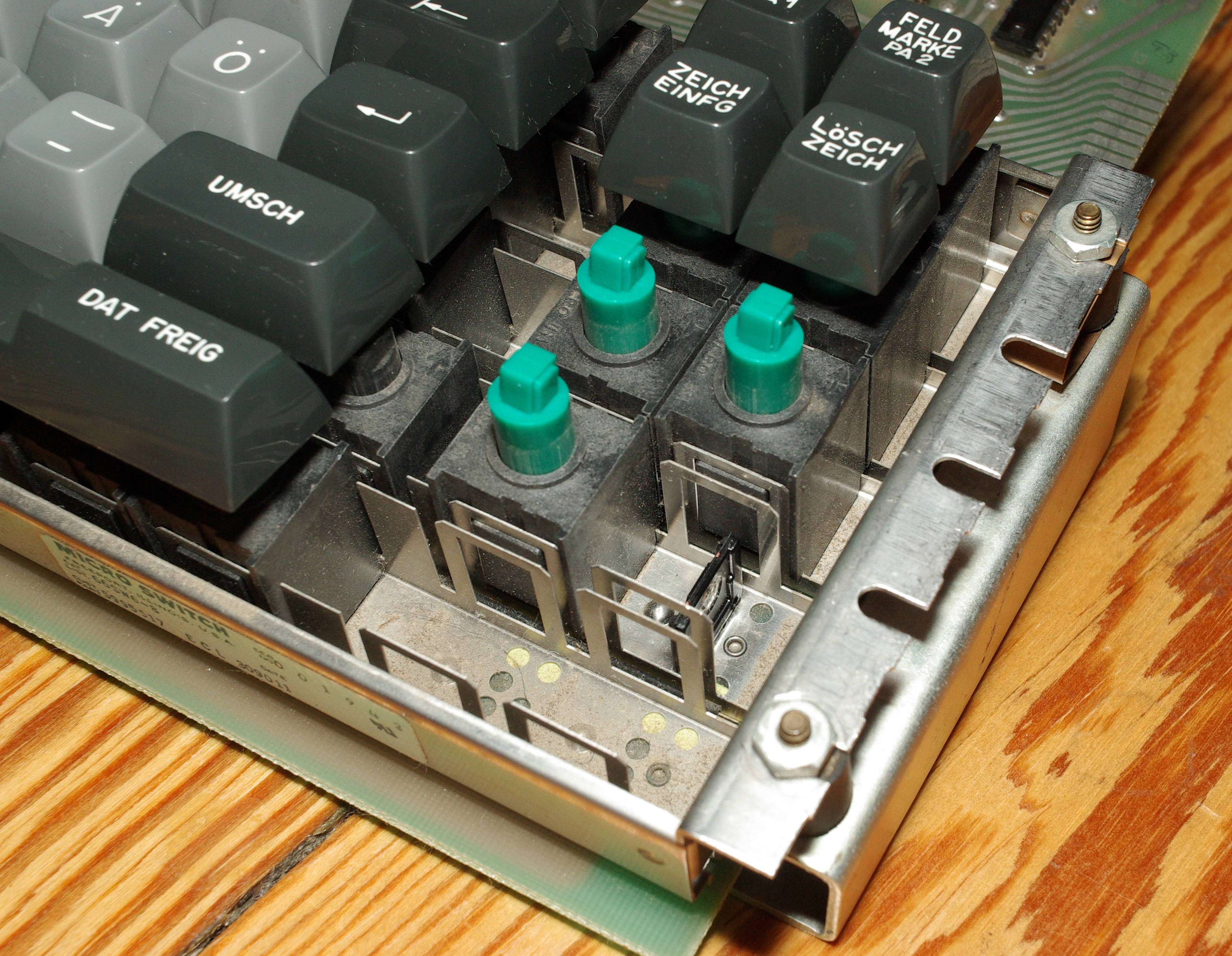

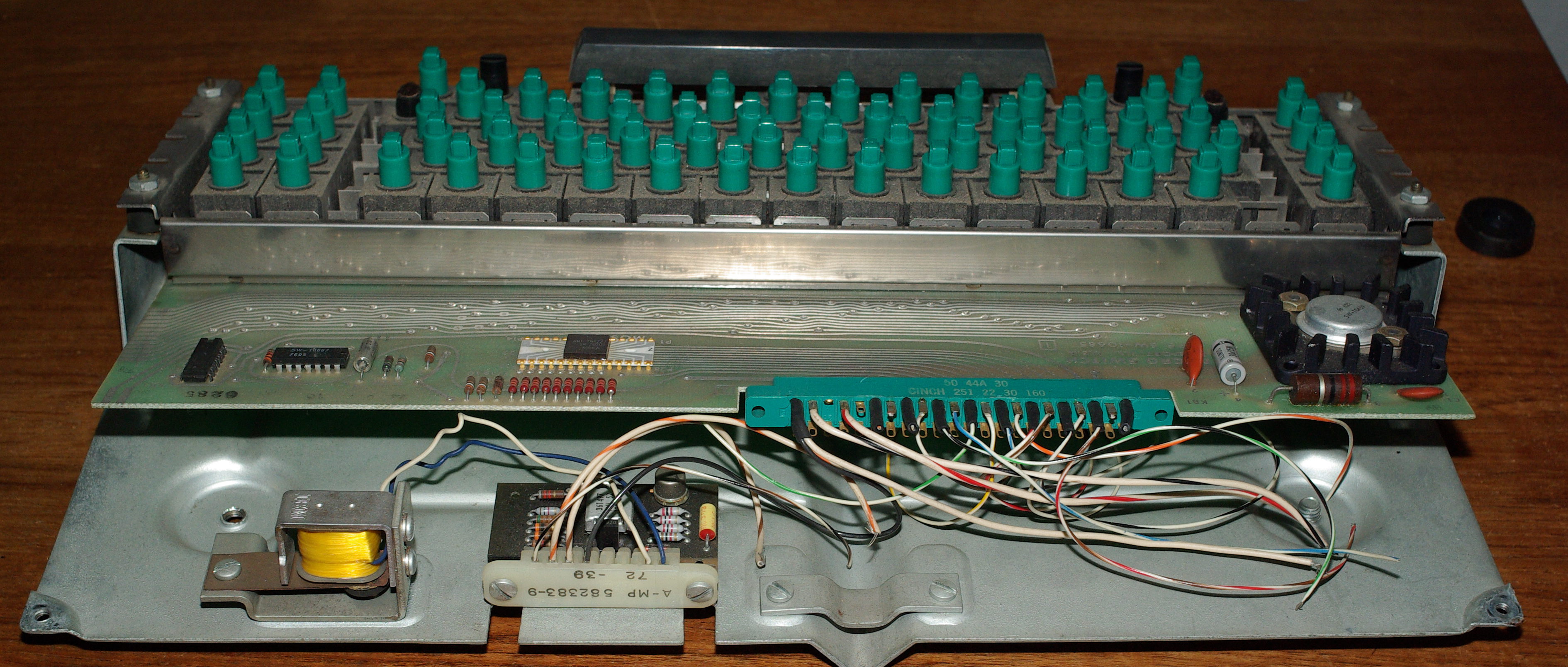

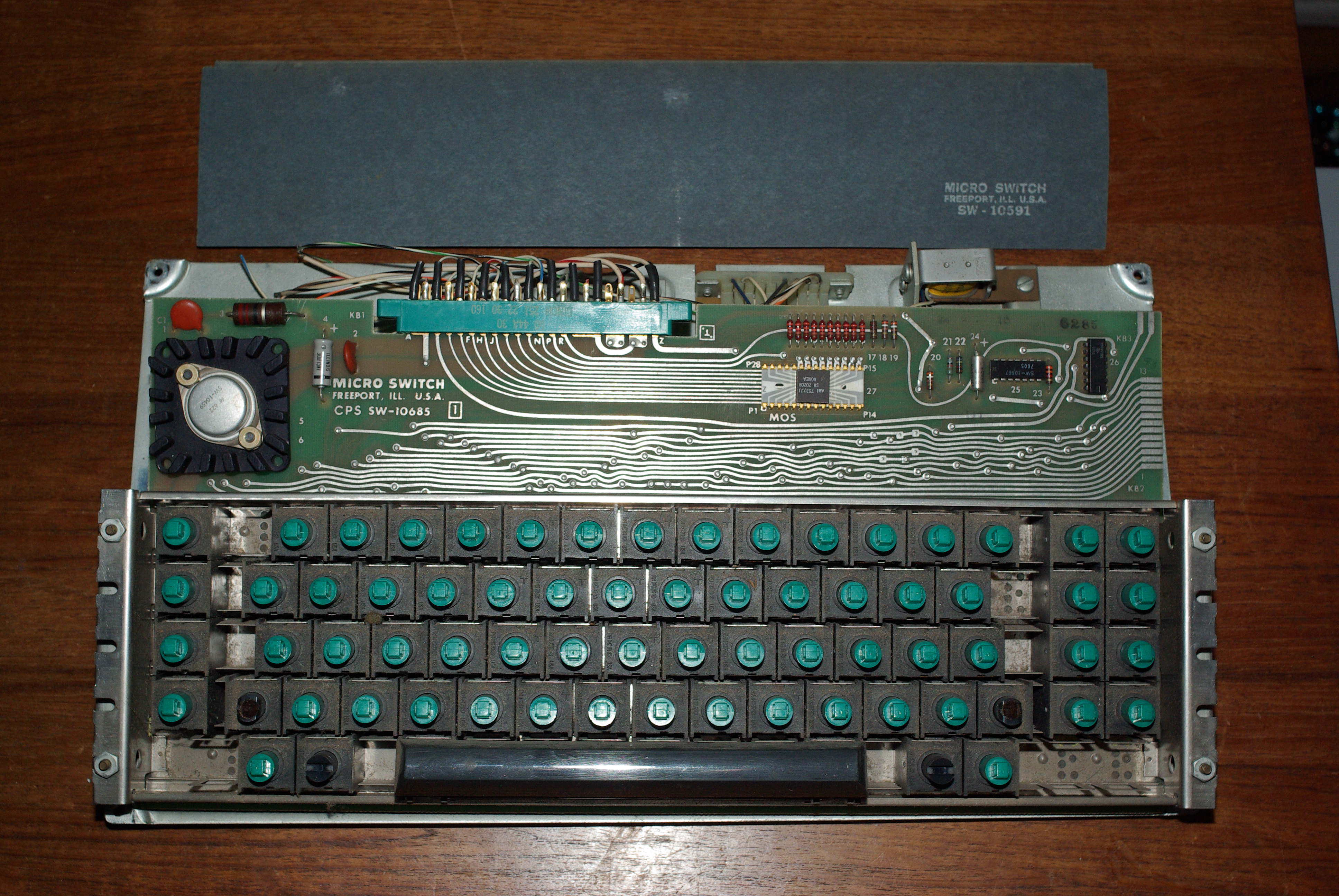

So this is a "dual magnet" hall effect KB. You can tell from the round sliders and "box" switch housings. Look for visible wear on the sliders as the housings are harder plastic. Lube everything up with a dry lube like graphite or wet lube like krytox.
HaaTa says corrosionX is great on these, but IDK if he's used it on an older dual magnet KB. It worked magic on a very dirty and awful to type on single magnet burroughs.

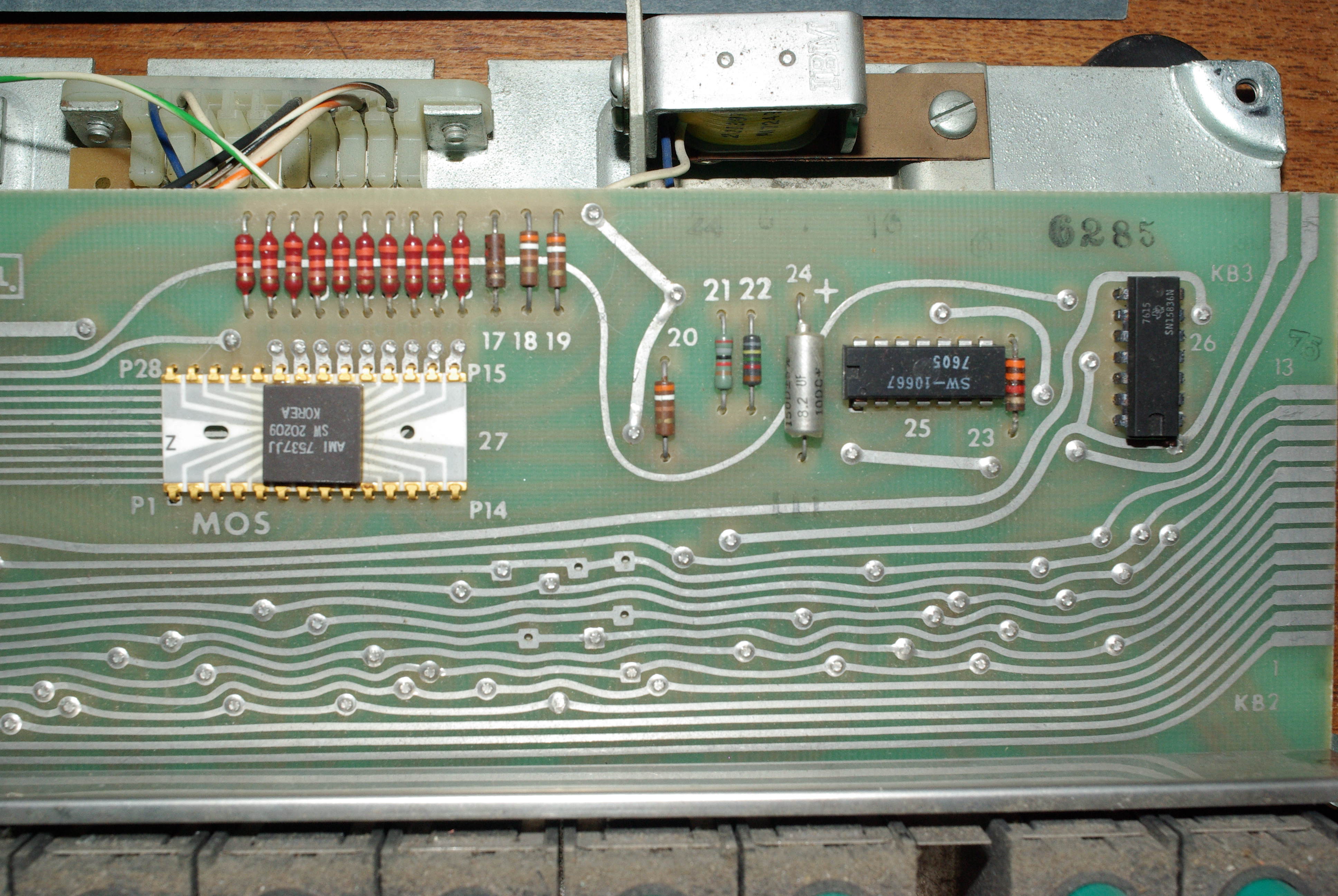

I was going to say: probably 1975-76 from the chip. My 1977 board has a different controller chip on it, but my 1976 one has the same ceramic package / gold pins. Pretty sweet!
So the best way to convert these (you get NKRO without diodes, more useful protocol, among other things) is to replace the PCB. Unfortunately these require a PCB, as the sensor is not connected to the switch.
On these single magnet type you can pull the whole switch body off the hall sensor by bending the metal leafs out a little (switches have a channel in them for a screwdriver for just this purpose) and disassemble them easily for cleaning and maintenance.

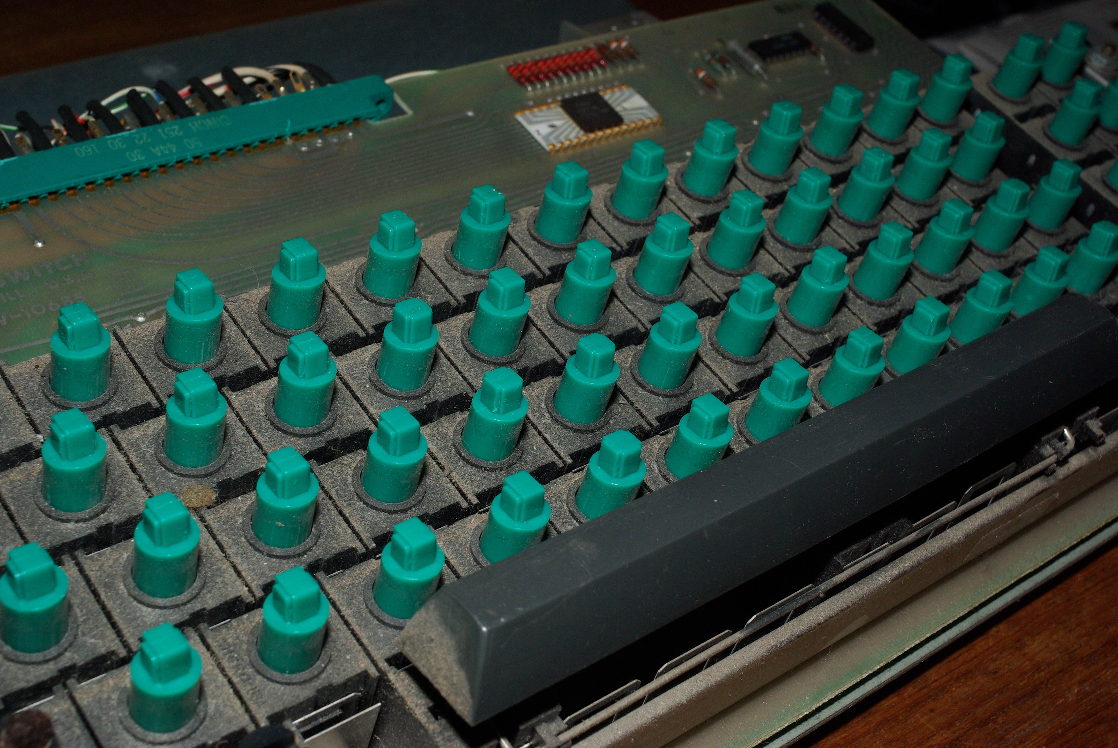

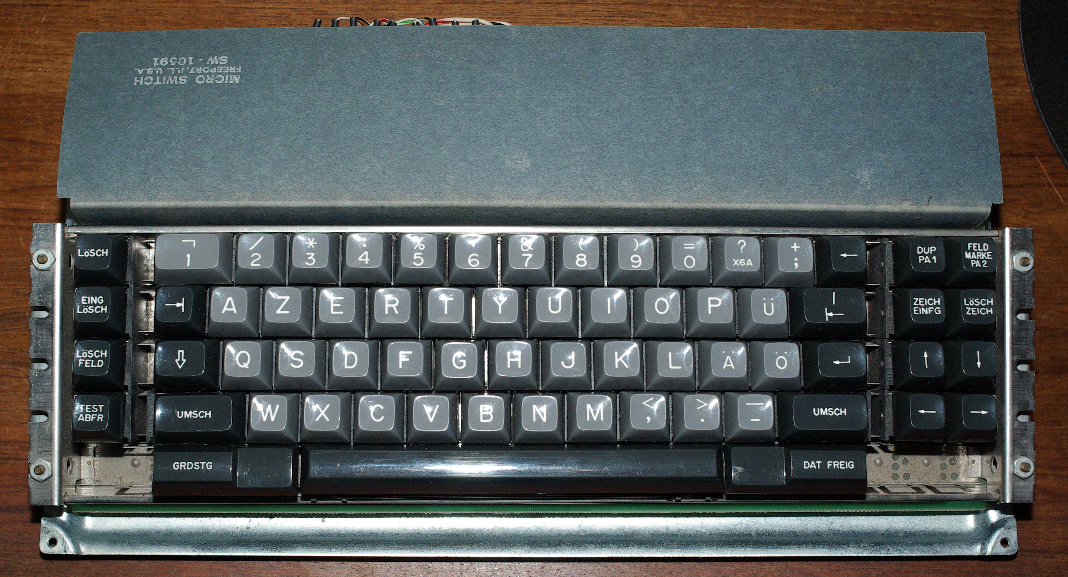

You’ll notice Webwit’s has sculpted keycaps, whereas yours are uniform. (Which means you can easily switch away from that silly AZERTY layout.)
Judging from the picture of the top of the switches, they definitely need to be cleaned out and lubed. I’m still not sure what the best way is to clean dusty/gritty switch parts. An ultrasonic cleaner would probably give the best results but those are expensive. Just a good scrub with something not too abrasive in some water & detergent might be sufficient.
Some kind of Krytox grease would probably be the best lube, but if that’s too expensive or hard to find then whatever other lube is probably fine. One nice thing about hall effect boards is you don’t need to worry about contaminating switch contacts.

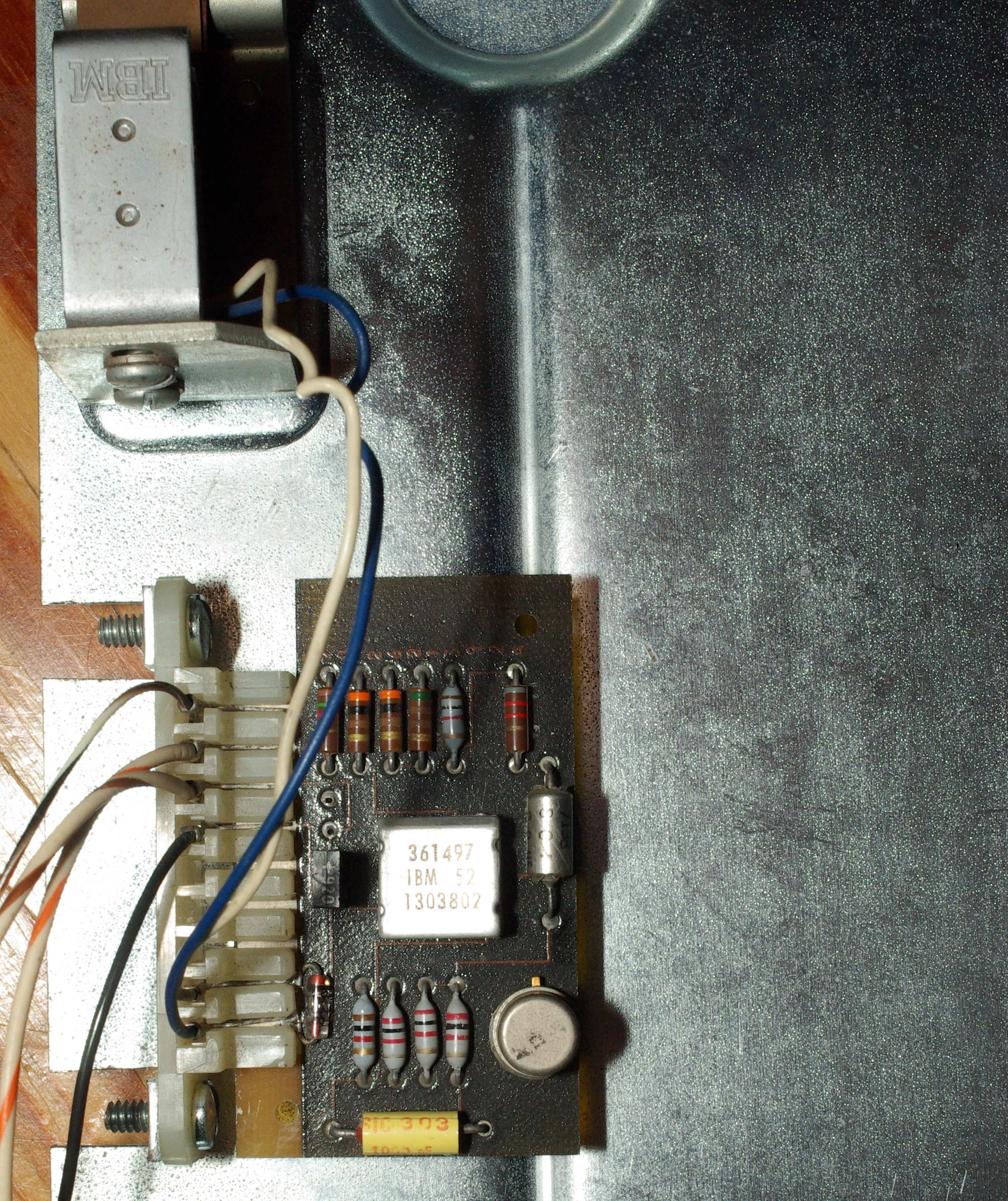

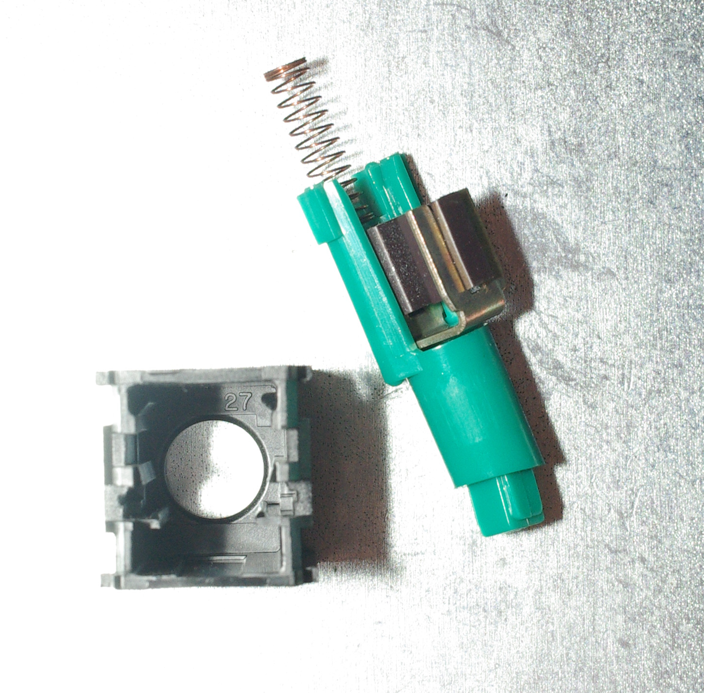

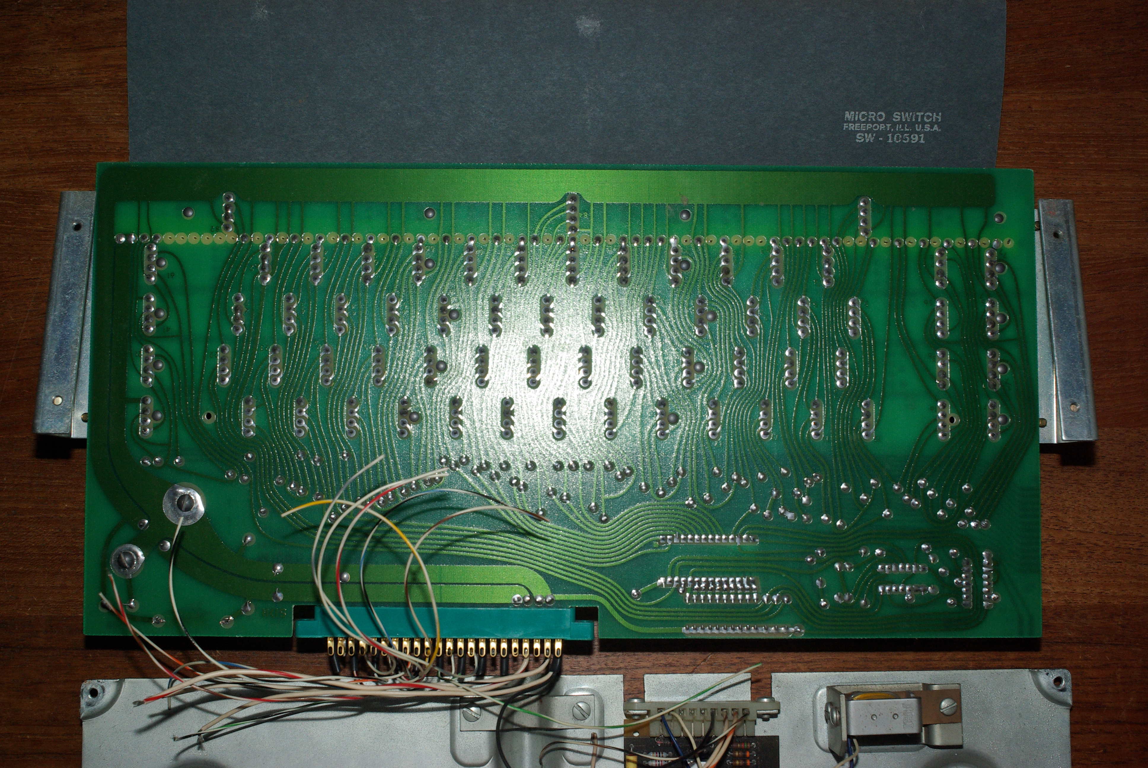

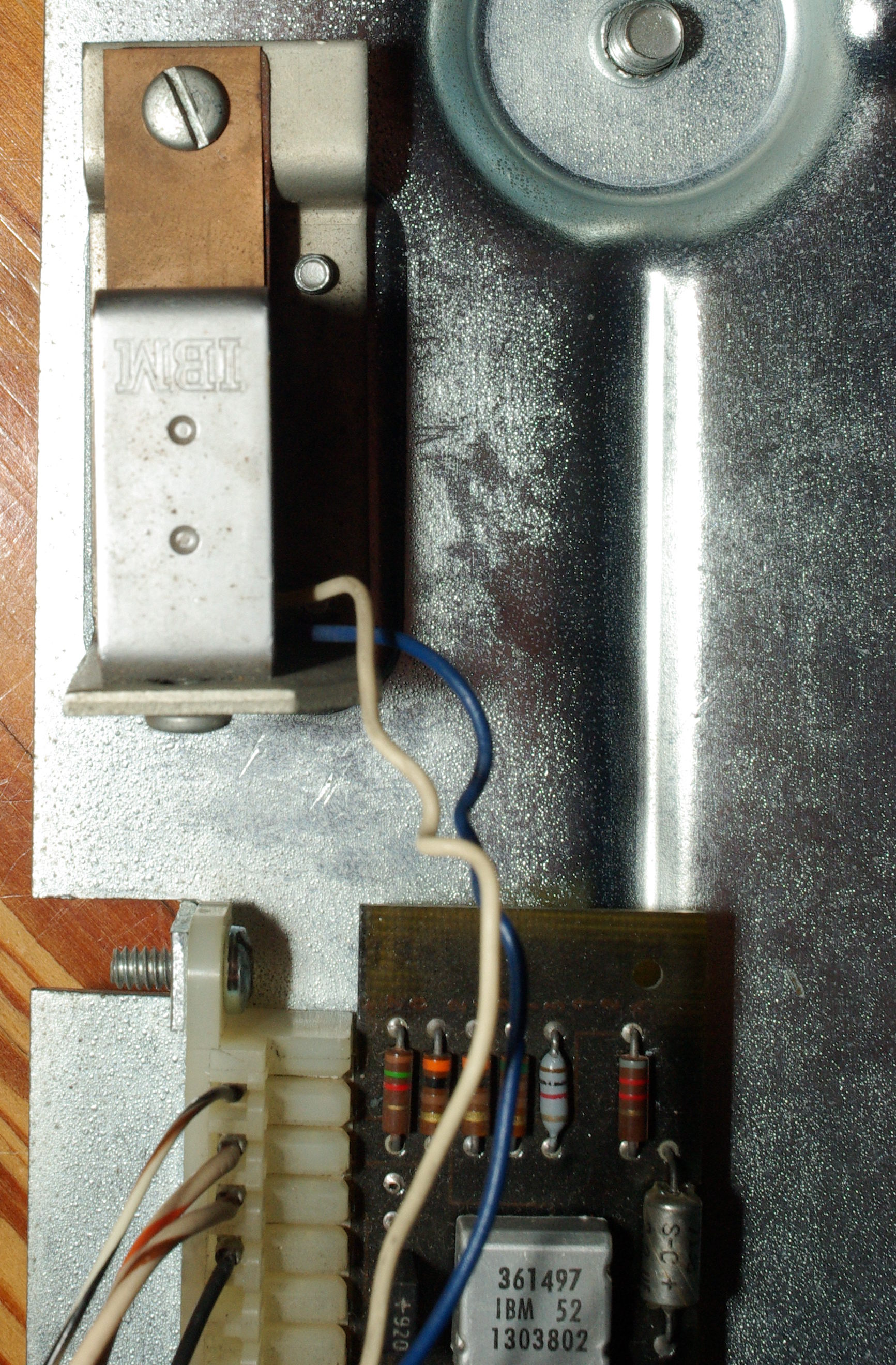

I shot some more pictures and learned some more. The chip on the small pcb and that small metal bar do read IBM as you can see.

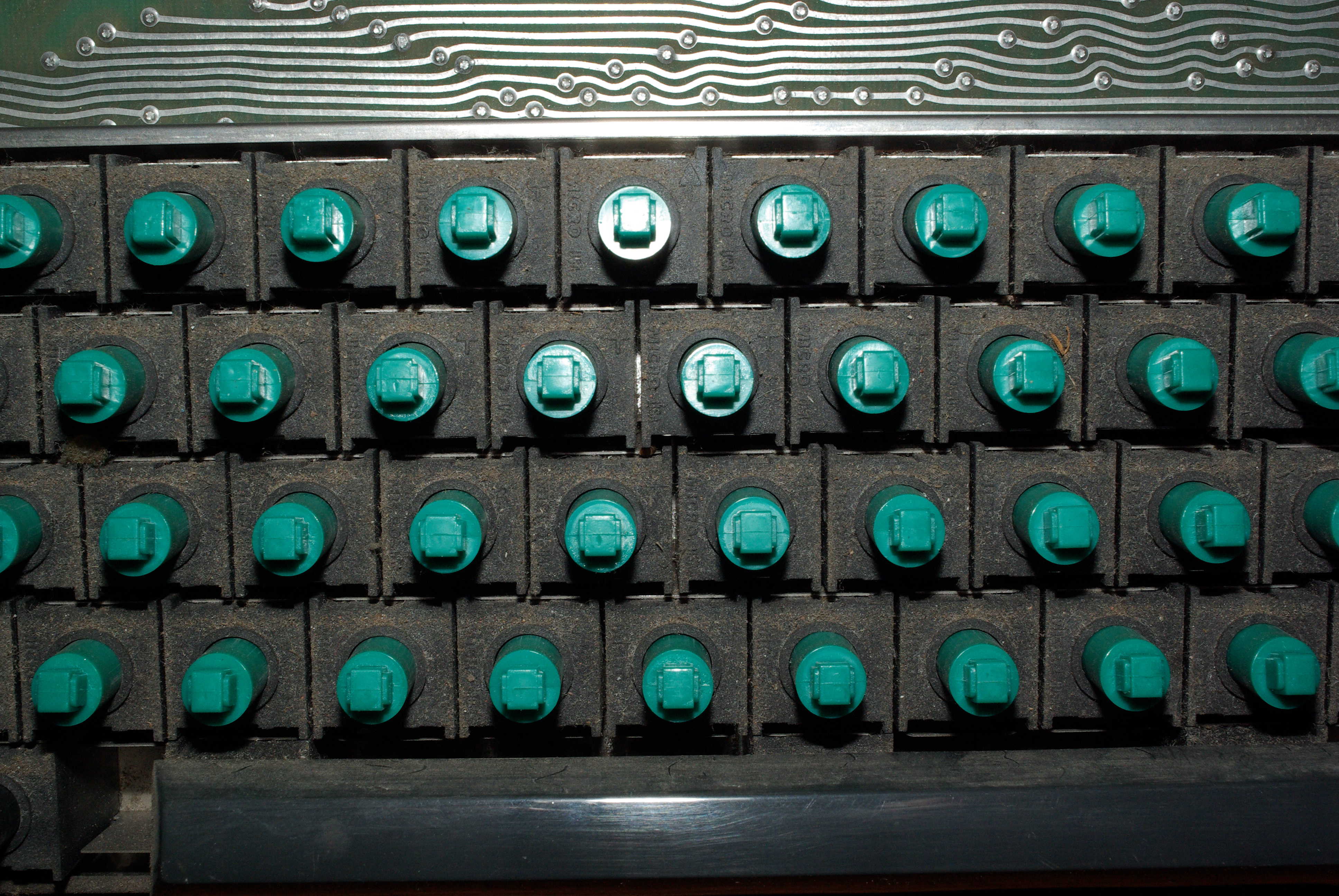

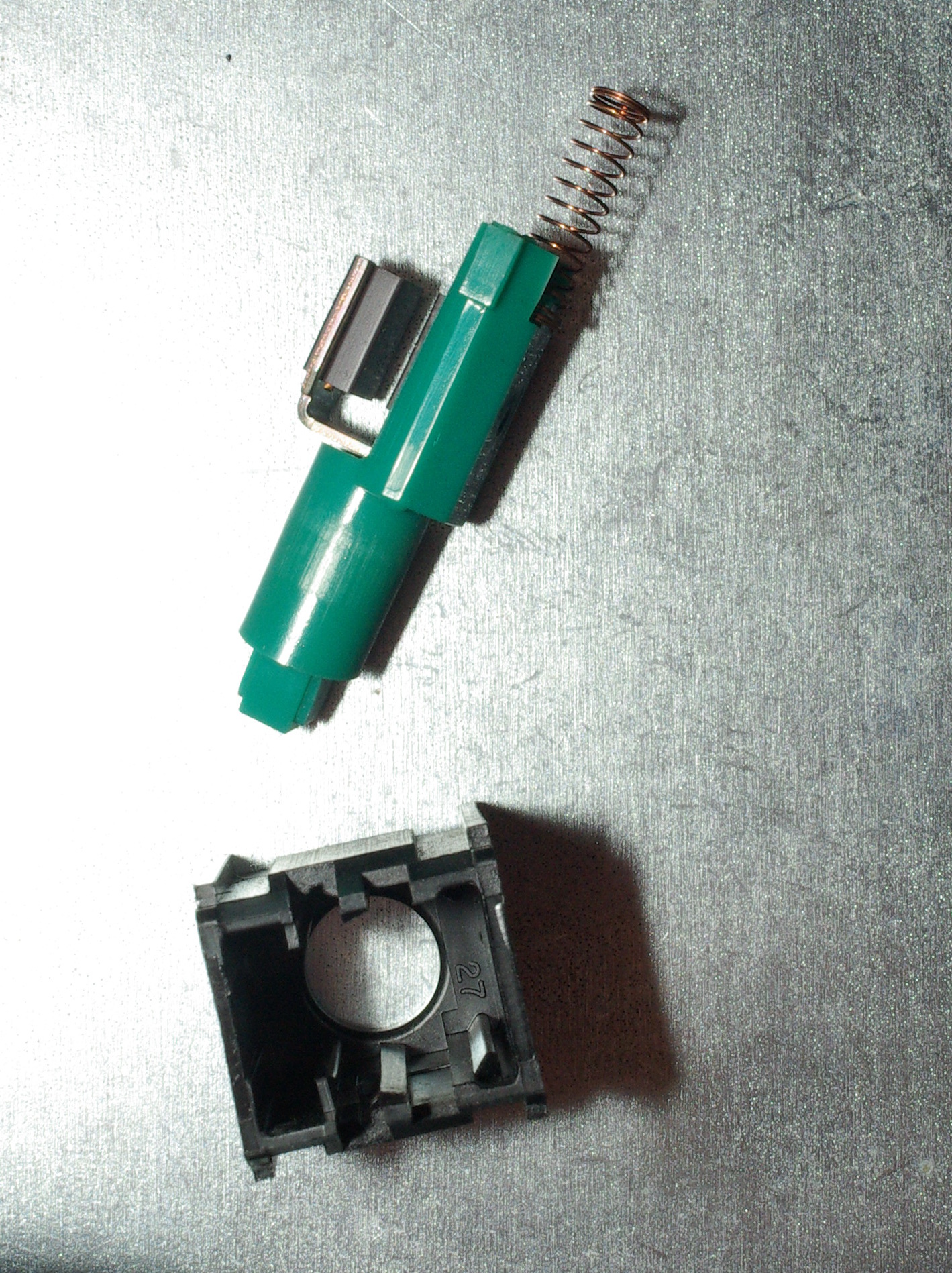

Now this is where my jaw dropped: how easy these box switch housings are to disassemble! 2 metal clips and the and the box comes right out! And it´s just a 2 part switch?!? Brilliant. Works just like you say dorkvader.
That one switch looks quite clean on the inside. Strange. I can see little wear on that slider. I'll have to take out all the the box switch housings and sliders for cleaning anyway.
I have this stuff for lubing here. It´s a silicon based cream lube. Not sure if I should use that. What part of the switch should be lubed?

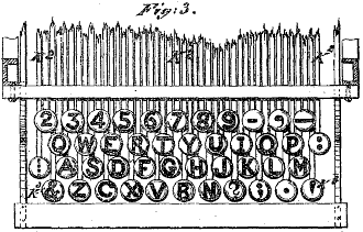

Qwerty Layout from 1878 look at the 3.
Olympia Typewriter 1964:
these images are from wikipedia btw.
http://de.wikipedia.org/wiki/Tastaturbelegung

now while a kind of evil conspiracy going on sounds exciting I bet that this also had to do with either some change in production optmization or it might also be that there was a change in some symbol format standard at some point where flat topped 3´s where not allowed anymore. When and why that change took place would be interesting.There's some kind of evil conspiracy going on...
