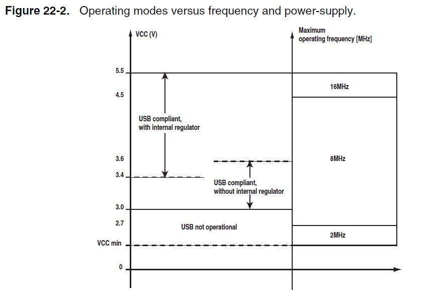

phosphorglow wrote: "Converting to 3.3 volts saves a lot of power. But the CPU is not rated to run at 16 MHz when powered by 3.3 volts. It usually works, at least at room temperature, but technically 16 MHz at 3.3 volts is overclocking." (From PJRC).
...wonder what would happen if I stuck it in the refrigerator and tried flashing it... ;P
The fridge would have nothing to do with it. Strictly speaking 16MHz at 3.3V isn't overclocking, it's undervoltaging. The two are different on a fundamental level. At a lower voltage some circuits won't be able to run as quickly due to RC time constants, parasitics, FET characteristics, and all sorts of other things. It might work, sometimes. Putting the setup in the fridge would't help with cooling (not like putting a water cooler on an overclocked CPU) but it might drop the resistances on some temperature dependent parts of the circuit.
I would follow Atmel's direction as mentioned in their data sheet. I don't have the data sheet handy but do they provide a reference clock circuit for 3.3V operation?

Ahhhhh yeah, that does make quite a bit of sense. Heh!
Correct, sir. Turns out there is a nice little chart in the datasheet (databook, that thing is huge).
Another instance where I can yell at myself for not RTFM. 8MHz crystal, here we go!

The MCU is shipped with FUSE bit CKDIV8 is programmed, this means clock is prescaled by 8 when powering up. So system clock is end up 2MHz with using external 16MHz crystal and it is totally within spec. As far as I know bootloader should work with 16MHz crystal and 3.3V.
After powering up we usually set devider of prescaler to 1 in firmware to get full frequency 16MHz for system clock. Then this is out of spec if VCC is 3.3V. Probably it will still work at 16MHz but we might want to use 8MHz system clock for safty and power saving.
