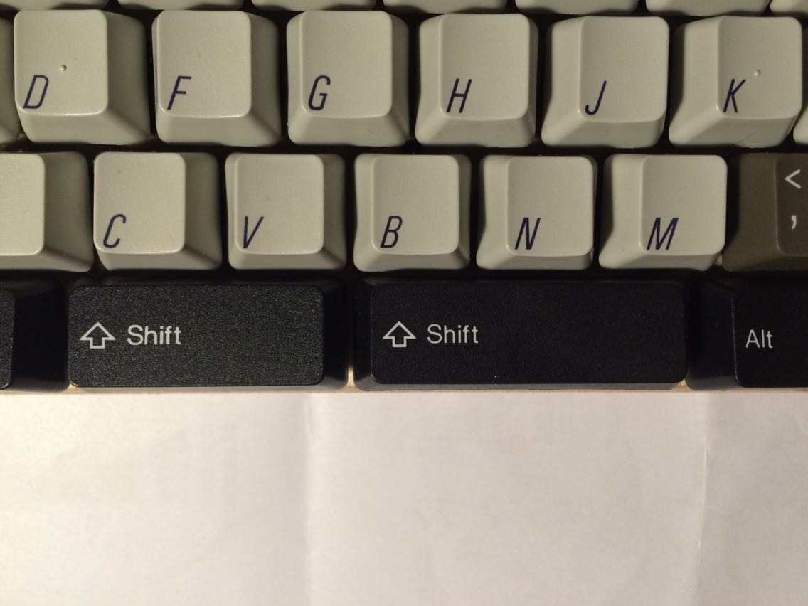

Almost? Well, there is one thing. Split right Shift key, HHKB style:
Not exclusively the preserve of HHKBs, far from it:
That key has such a following that Ellipse had to make a separate model of Kishsaver just to satisfy demand! Separate? Because IBM split that looooooong old 2.75u right Shift the other way. On Model Fs and Model Ms alike, there's two barrels and you can either cover the pair with a single 2.75u cap, or with a 1u on the inside/left with a 1.75u cap on the outside/right. I believe IBM did this is to satisfy Japanese and Brazilian layouts, which have an extra key in there, much like ISO crams into the ANSI Return key. Trouble is, that's the *wrong* way for us HHKB fans. And there is no simple solution. Because splitting the 2.75 units the other way around renders the board incompatible with vintage / available right Shifts!
Now, how much do I care about this one detail? Not so much, to be honest. The Fn key is absolutely vital on a 60%, so it matters a lot on a Kishsaver. I really prefer it HHKB style. But we're talking TKLs (and icky fullsize boards) here. We'll have arrow keys and the navigation sixpack intact, so Fn is significantly less important. I say go classic.
As for the rest of the board: I'm almost all in favour of following IBM's lead and going straight traditional SSK / fullsize Model M layout, with the addition of 2x 1u keys between each Control and Alt for the extra mods on modern boards. We're just talking capsense pads. No harm in adding these to the PCB, even for those of us planning to use unmodified vintage cases.
- need
- Location: United Kingdom

Knew that was what you guys were up to!
Splitting the huuuuuuuuge spacebar does make sense. Thumbs can handle a lot better use than just that one key. But it's quite a hassle sourcing caps. And at least as troublesome as the HHKB split Shift regarding retaining original keyset compatibility.
Fun math time: IBM's spacebars are 7 units*. Using two right Shifts like your image above, you cover 5.5 units. Add a third key, this time 1.5 units, and you've got all 7. I'd put that key in the middle for symmetry's sake (and because I press Space from the right rather than the centre) that would potentially make a smart layout. However! Shifts and Control keys aren't convex like spacebars. So it'd sure feel odd, as well as invite compatibility trouble in case you want to go back to a real spacebar.
Splitting space is a nice idea, but has a lot of fallout.
*Oh, by the way: screw Unicomp's own boards. We're strictly talking IBM originals, and Unicomp's available caps for them. "Large" Shifts as they call them. Things go right pear shaped if we include Unicomp's own bastardisation of the layout, and next to no one is remotely interested in their modern boards anyway. There'll be a whiner or two, but no buyers!
