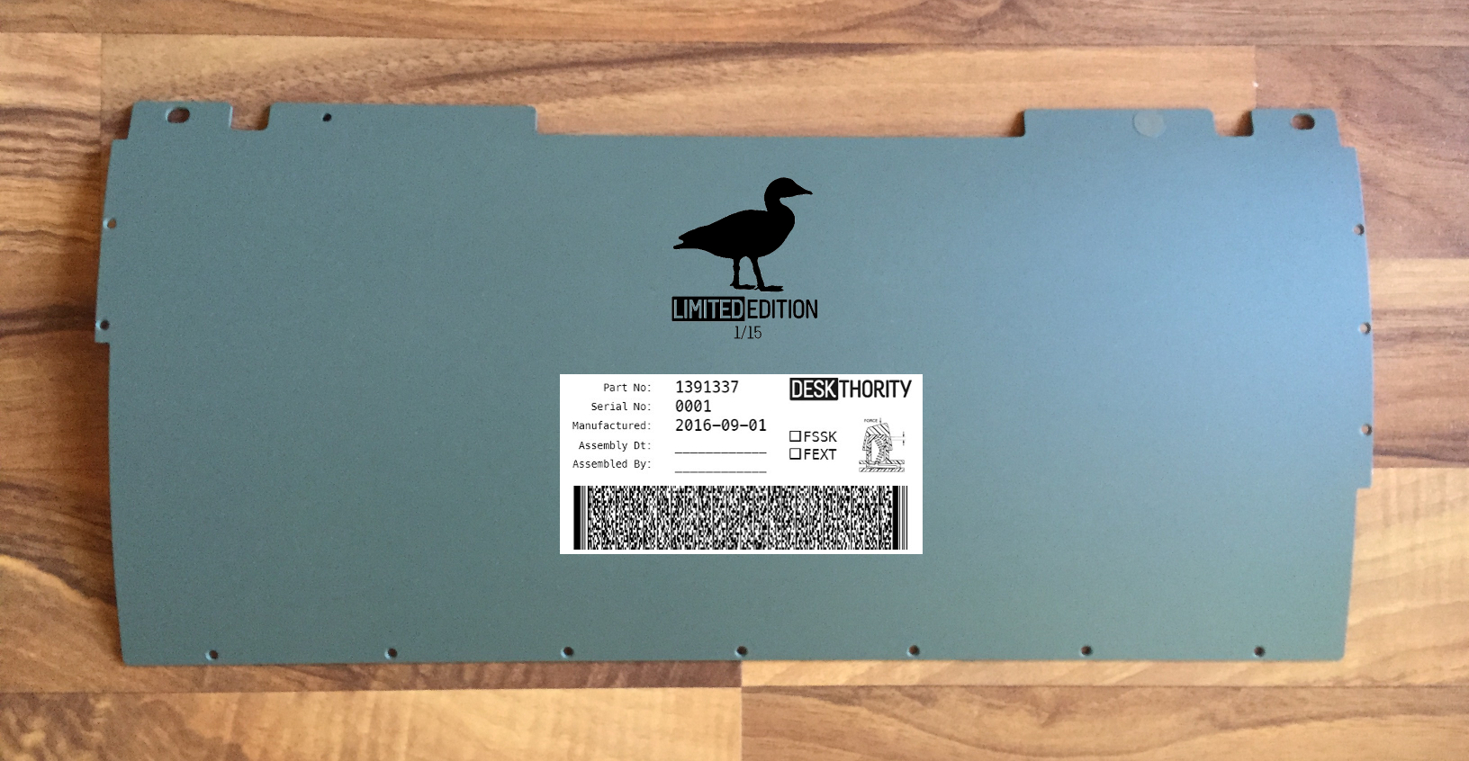

Was bored on the plane last night and threw this together. Just an optional sticker that wouldn't be tied to anything particular, but something you could grab to dress things up a bit if wanted. It's a tribute sticker to Soarer, xWhatsit (Tom Wong-Cornall), Hasu, WCass, and I$ as projects/activities that have had significant impact on this project ever taking place. Still needs polishing (font changes, etc), but the general idea. if I'm missing someone let me know
EDIT: Also went back and cleaned up the XTant Tribute Badge to avoid confusion. The update was added to the previous post with the original to show the difference
12 Jul 2016, 17:11
I like it , but it would be cool if it has more of a pixilated dot matrix look.
EDIT
Very quick and dirty filter but to get an idea
lot_lizard
12 Jul 2016, 18:29
andrewjoy wrote: I like it , but it would be cool if it has more of a pixilated dot matrix look.
That's an interesting idea. I'll try that this evening. Maybe add a faint circuit board pattern to the whitespace on the left as well? Something to make it yell a little less would be nice and give better depth
EDIT: Haven't played with the dot matrix pattern on the images yet, but over lunch added the circuit board to the white background, and your dot matrix idea gave me a better direction for the junk font before. Getting more retro
EDIT the EDIT: Changed the font again to something more "comforting" > happy.me
