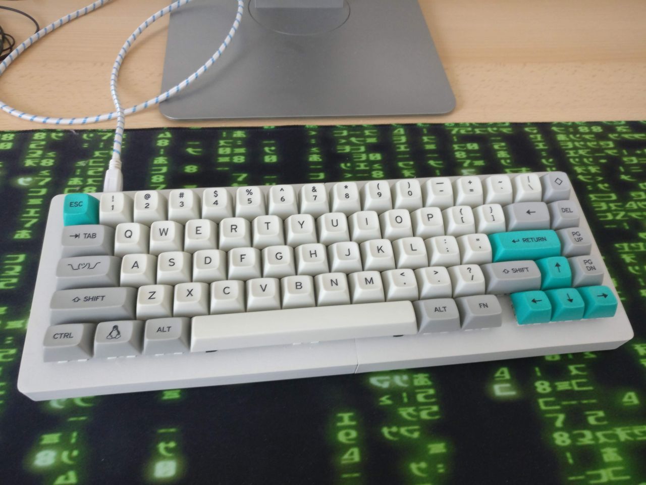

-[°_°]-
18 Jun 2018, 18:24
And this is the end result! Hand wired on /dev/tty keycaps :)
green-squid
25 Jun 2018, 21:45
Looking good! These are the caps you designed, right?

-[°_°]-
27 Jun 2018, 10:31
green-squid wrote: Looking good! These are the caps you designed, right?
they are indeed!
