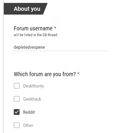

I... I... show up as a redditor in this list.
The important details (what I'm in for) are right, though.

I just checked to make sure I didn't accidentally made a mistake while exporting to excel. It seems I didn't, the google form shows that you did indeed check the box for "Reddit"

Must have been Google then, because I neber make mitsakes.
No worries, man.
