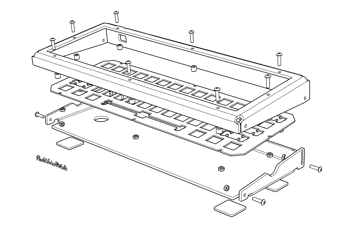

The design is simple. The decision for a material thickness of 3mm 2mm in combination with the plate mounting method and the bolts piercing through the frame lead to a pretty wide frame. The sides overlapping at the edges is a deliberate choice which should emphasize on the method of folding, rather then trying to hide it. It also exposes the thickness of the material. Some of you described it as "brutalist", "utilitarian" or "industrial" - all undeniable true in some way.
I like to view it as a robust and reliable, everyday tool with a focus on typing experience and ergonomics.
I want to point out a few things I had in mind when designing this case:
  • At first, I wanted it to be a simple implementation of a top-mount case, cause IMHO top-mount is best-mount :)

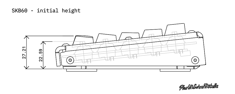

  • Secondly, the first and lowest or "initial" key row should be as low as possible. This is illustrated in one of the pictures down below.

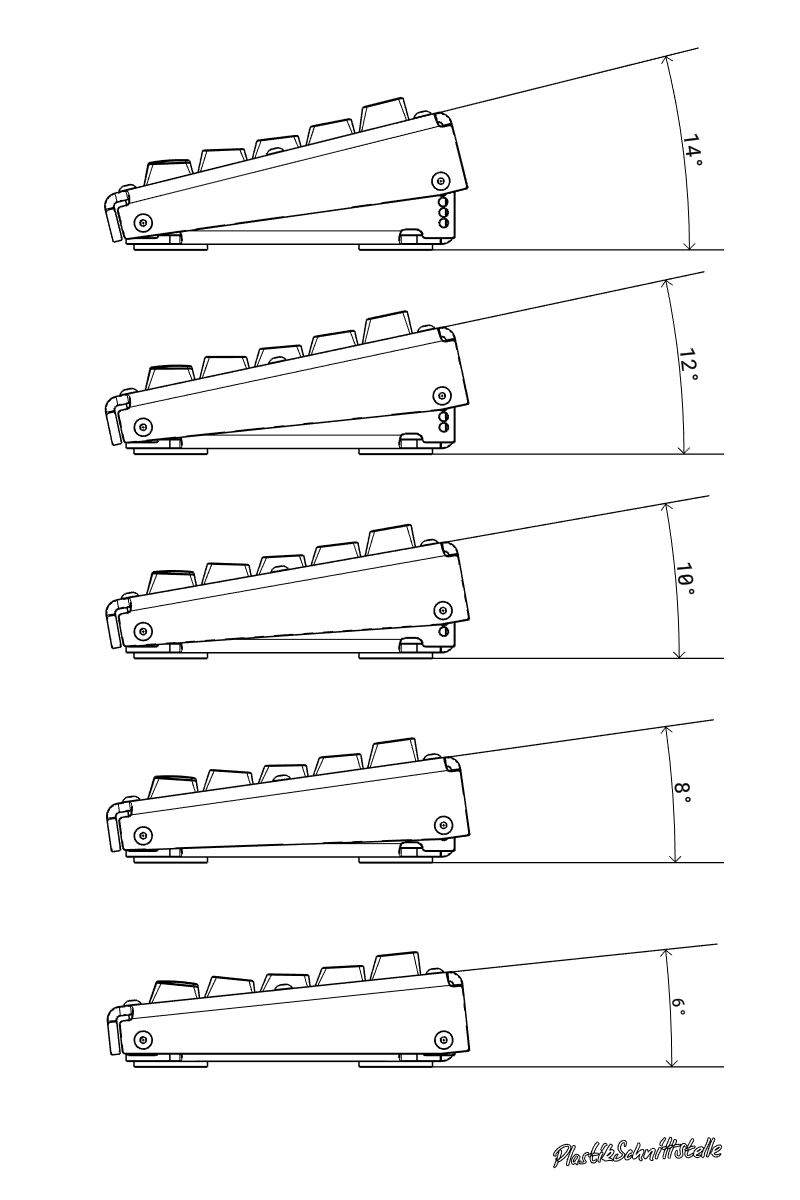

  • Thirdly, height adjustability. We prefer our keyboard at a certain angle but not everybody likes the same. So I wanted height adjustability to be an integral part of the design. You can choose between different angles: 6, 8, 10, 12 and 14 degrees.
01 SKB60-explosion.jpg (287.01 KiB) Viewed 54690 times
02 SKB60-angles.jpg (179.83 KiB) Viewed 54690 times
03 SKB60-height.png (32.97 KiB) Viewed 54690 times

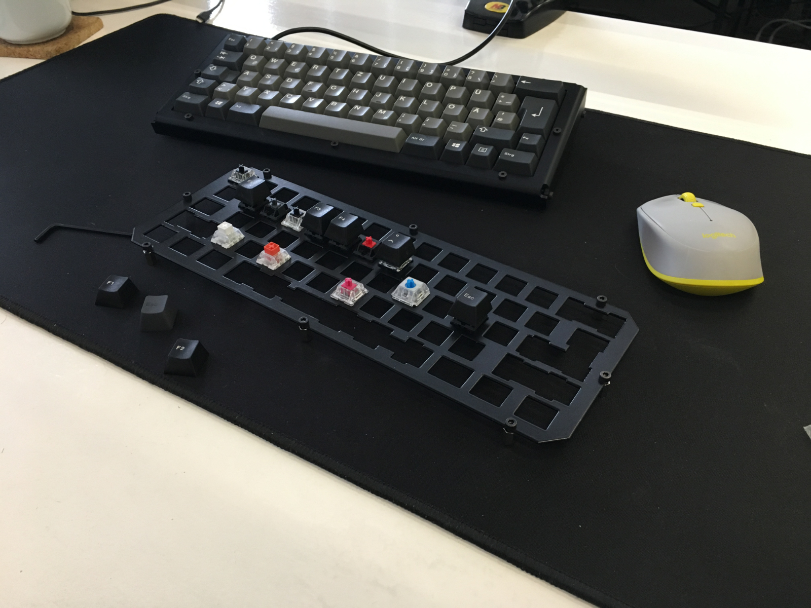

For the 60% there is plate A that supports most popular layouts including split spacebar. The YAS PCB gets its own plate. 65% 75% each have one plate, both support split spacebar as well.
Especially providing an option for the YAS62 - a project that I really like - was important to me. I have two of these PCBs and can't wait to finally put them to use. Silentreader still has some PCBs left that you can get, just PM him. The YAS PCBs will be sent to me. In the order form you have the option to add the YAS PCB to your order to get it from me together with the case. Price is 37€.
The plate does not support switch-top removal or alps switches. Yes, I probably could have convinced some more by offering those, but I made this decision because I wanted the plate to have as much mass as possible and the switches to fit tightly. Just lube your switches before you put them in ;)
All plates are ANSI/ISO unified and only support Cherry PCB mount stabilizers.

Height (center point of keycap top at lowest row): ~ 26 mm
Height (rear edge at 6 degree): 31 mm
Height (rear edge at 14 degree): 45 mm

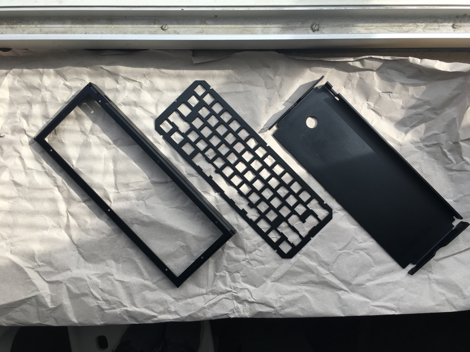

Top & Bottom:
  • 2 mm thick aluminium
  • LASER cut and bent
  • bead blasted and anodized, black
Plate:
  • 1.5 mm thick steel
  • galvanized black
Accessories:
  • 12x button head screws (M3x12)
  • 12x low head screws (M3x12)
  • 12x nuts
  • 8x standoffs
  • 4x washers
  • 4x rubber feet

  • Height adjustment is not quick like flipp out feet. You have to unscrew two and loosen two more screws on the sides in order to adjust the height.
