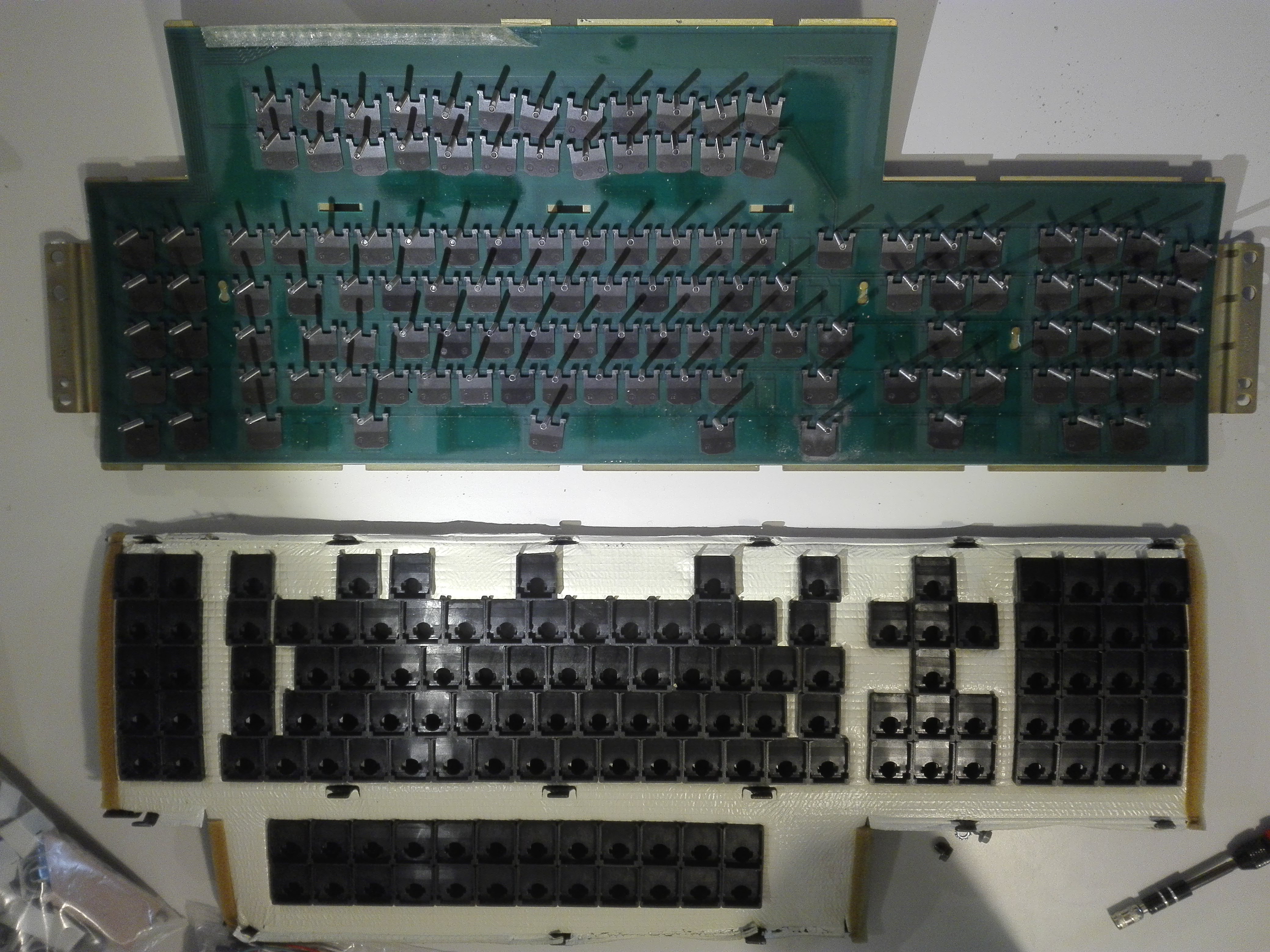

Hi all!
I wrote couple days ago about my recently found F-122.
Today I was able to connect it with Soarer's converter to a pc, to discover that half a dozen keys are dead:
S,D,4, and a couple other keypresses aren't registered.
The same keys, when pressed, have a different feel/sound as well: they feel "linear", and in fact there is no click at the end.
After disassembling the plates, a first observation of the PCB doesn't reveal any obvious damage:
some spots are brighter, less opaque than the rest, but I assume it is caused by the contact with the foam mat.
All springs and hammers are in good shape (see attached photos).
Any ideas about possible causes?
Thanks in advance
gg

Hammer hinges weren't in their slots or keycaps caught on the springs when you put them on. Just reseat everything and make sure it's right and put it back together. It should work fine.

I'll get on to it and report back. Thanks!

Sangdrax wrote: Hammer hinges weren't in their slots or keycaps caught on the springs when you put them on. Just reseat everything and make sure it's right and put it back together. It should work fine.
You absolutely nailed it. Everythings fine after reassembling and carefully inserting the stems. Thanks for your prompt help!
