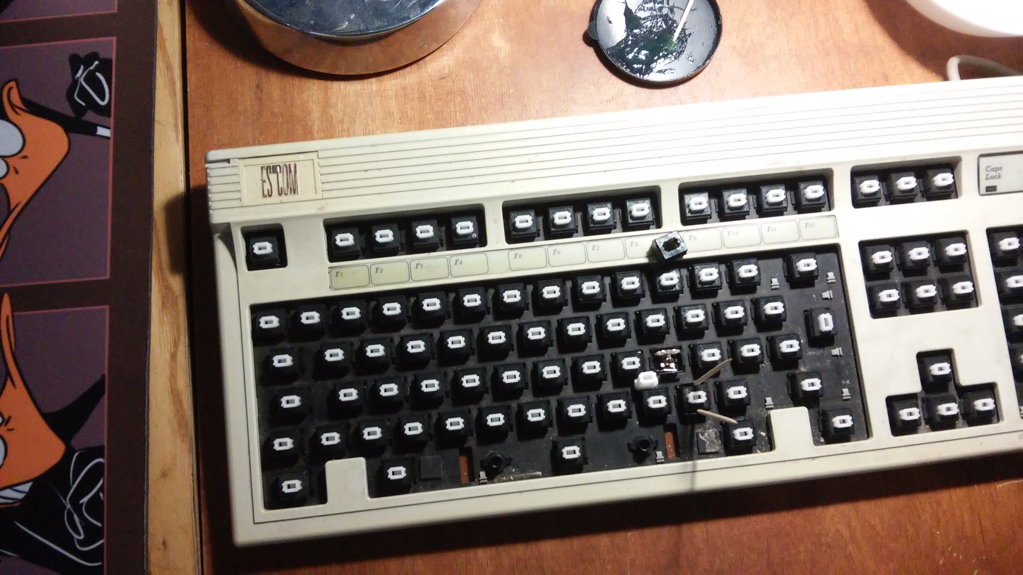

Hello, just registered on deskthority after some time lurking around. about 2 weeks ago or such i have spent about three days cleaning and lubing every switch on my fk2002, before that it was HORRIBLE, my friend actually bought that board but didn't use it because it was that bad. I used just a little bit of bearing grease (lithum based) and so far its great.
