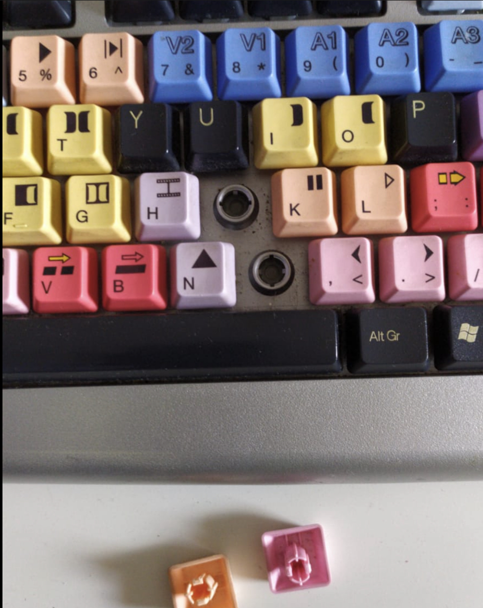

Alectardy98
- Location: USA//Washington DC
What is this guy ?
- 44345EF0-9102-4F41-A389-0F8996222CE2.jpeg (957.02 KiB) Viewed 11319 times
HC514
- Location: Ireland
- Main keyboard: F122
- Main mouse: Various trackballs
- Favorite switch: Model F buckling spring
Looks like ordinary rubber dome. The gold-coloured lasered lettering looks like early 2000s HP/Compaq stuff to me, although I wouldn't have pictured them doing video editing gear.

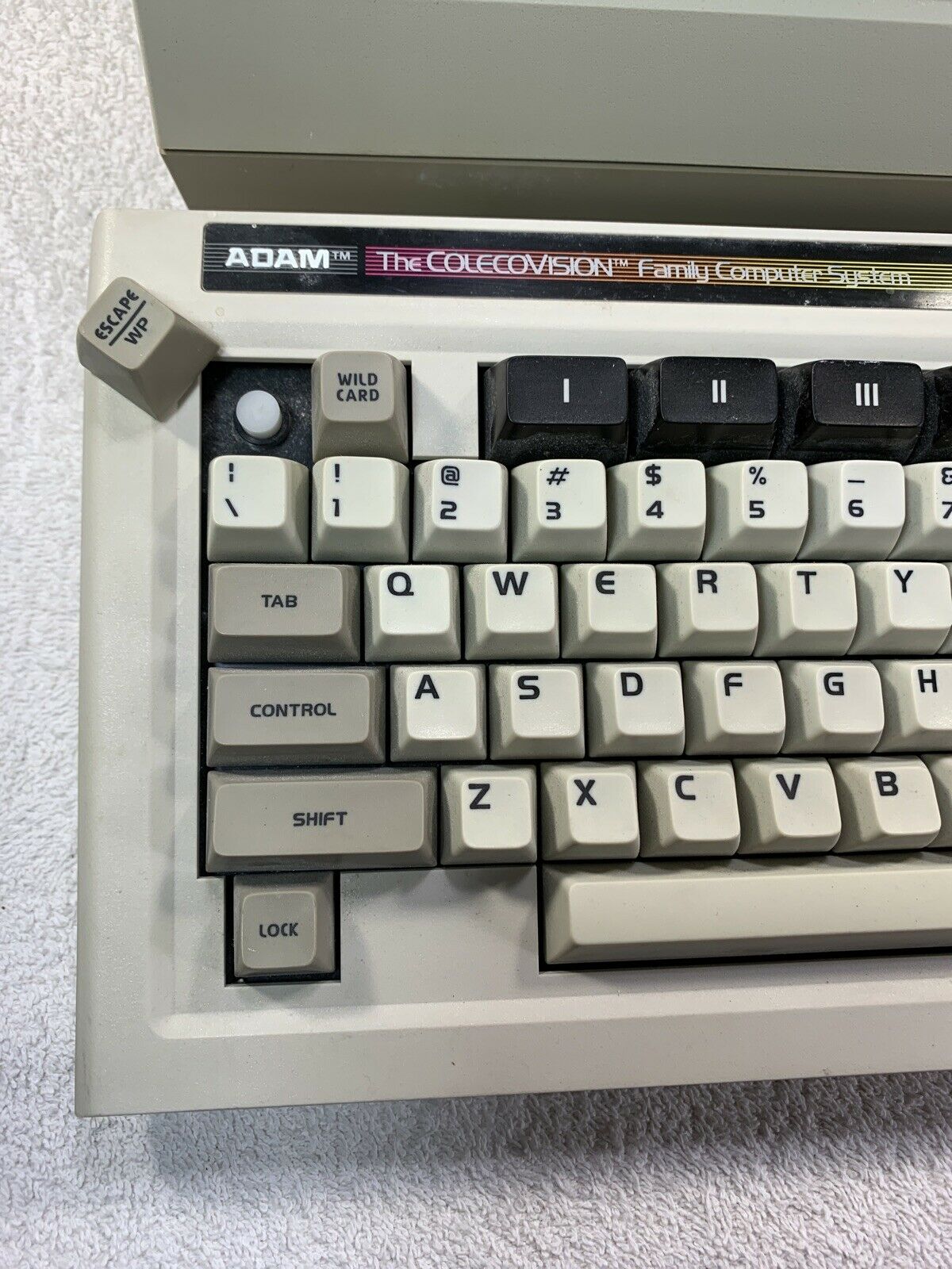

lauralouise
- Location: Toronto
I know what this keyboard is -- (Coleco Adam) but I haven't connected it up yet and I'm wondering if anyone who's used one of these can tell me.... what on earth does the 'WILD CARD' key do???
- s-l1600.jpg (286.78 KiB) Viewed 11054 times

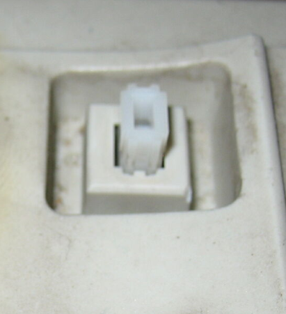

Alectardy98
what is this switch, its looks like alps?
- Capture.PNG (278.27 KiB) Viewed 10937 times
kelvinhall05
- Location: Canada
- Main mouse: MX Master 3
Acer switch I think, or that weird Alps slider/clicker over membrane that has been mentioned/spotted here before.

Looks beautiful in the cream color. Is that a distinct switch or is the housing a part of the case?
4_404
- Location: Brisbane, Australia
Looks like the Tai Hao clicky spring over membrane semi mechanical switch
wiki/Tai-Hao_APC_semi-mechanical

Cool! Anybody know if it’s any good? Would love to see a Chyros review on it one day.4_404 wrote: 22 Jun 2020, 00:18Looks like the Tai Hao clicky spring over membrane semi mechanical switch
4_404
I have a 'Gear G2101' branded 'Type III' with one click leaf. It is genuinely the rattliest keyboard I know. Shaking it sounds like shaking a box full of springs, which is basically what it is. Typing on it sounds like typing on a box full of springs. The click is pretty light, the spring is very heavy, so it basically feels like a wobbly Cherry MY that is broken and clicks for some reason - the dead octopus analogy holds true, except this octopus is full of a bunch of crunchy bits that click when you poke it. The click is usually right at the top of the stroke, but it's pretty inconsistent. They're also scratchy, even though mine is NOS, but they don't bind at all. I got mine cheap for the caps and it's a funny board to mess around with but not something that is pleasant to use at all. The Acer switch is vastly superior. I have a typing video somewhere if I can find it.ddrfraser1 wrote: 22 Jun 2020, 00:56Cool! Anybody know if it’s any good? Would love to see a Chyros review on it one day.4_404 wrote: 22 Jun 2020, 00:18Looks like the Tai Hao clicky spring over membrane semi mechanical switch

Yikes4_404 wrote: 22 Jun 2020, 01:37I have a 'Gear G2101' branded 'Type III' with one click leaf. It is genuinely the rattliest keyboard I know. Shaking it sounds like shaking a box full of springs, which is basically what it is. Typing on it sounds like typing on a box full of springs. The click is pretty light, the spring is very heavy, so it basically feels like a wobbly Cherry MY that is broken and clicks for some reason - the dead octopus analogy holds true, except this octopus is full of a bunch of crunchy bits that click when you poke it. The click is usually right at the top of the stroke, but it's pretty inconsistent. They're also scratchy, even though mine is NOS, but they don't bind at all. I got mine cheap for the caps and it's a funny board to mess around with but not something that is pleasant to use at all. The Acer switch is vastly superior. I have a typing video somewhere if I can find it.ddrfraser1 wrote: 22 Jun 2020, 00:56Cool! Anybody know if it’s any good? Would love to see a Chyros review on it one day.4_404 wrote: 22 Jun 2020, 00:18
4_404
I really like the older mechanical APCs (I have and Orteck MCK-101 with some branded/unbranded ones, best clones I've tried), but the membrane based ones are really only good for the novelty, the caps and possibly the click leaves.davkol wrote: 22 Jun 2020, 12:43 I have swapped APC/Tai-Hao leaves (from older models though) into Alps SKCM Black and it improved the tactility quite a bit. The keyboards had okay doubleshot keycaps as well, but that's about it.

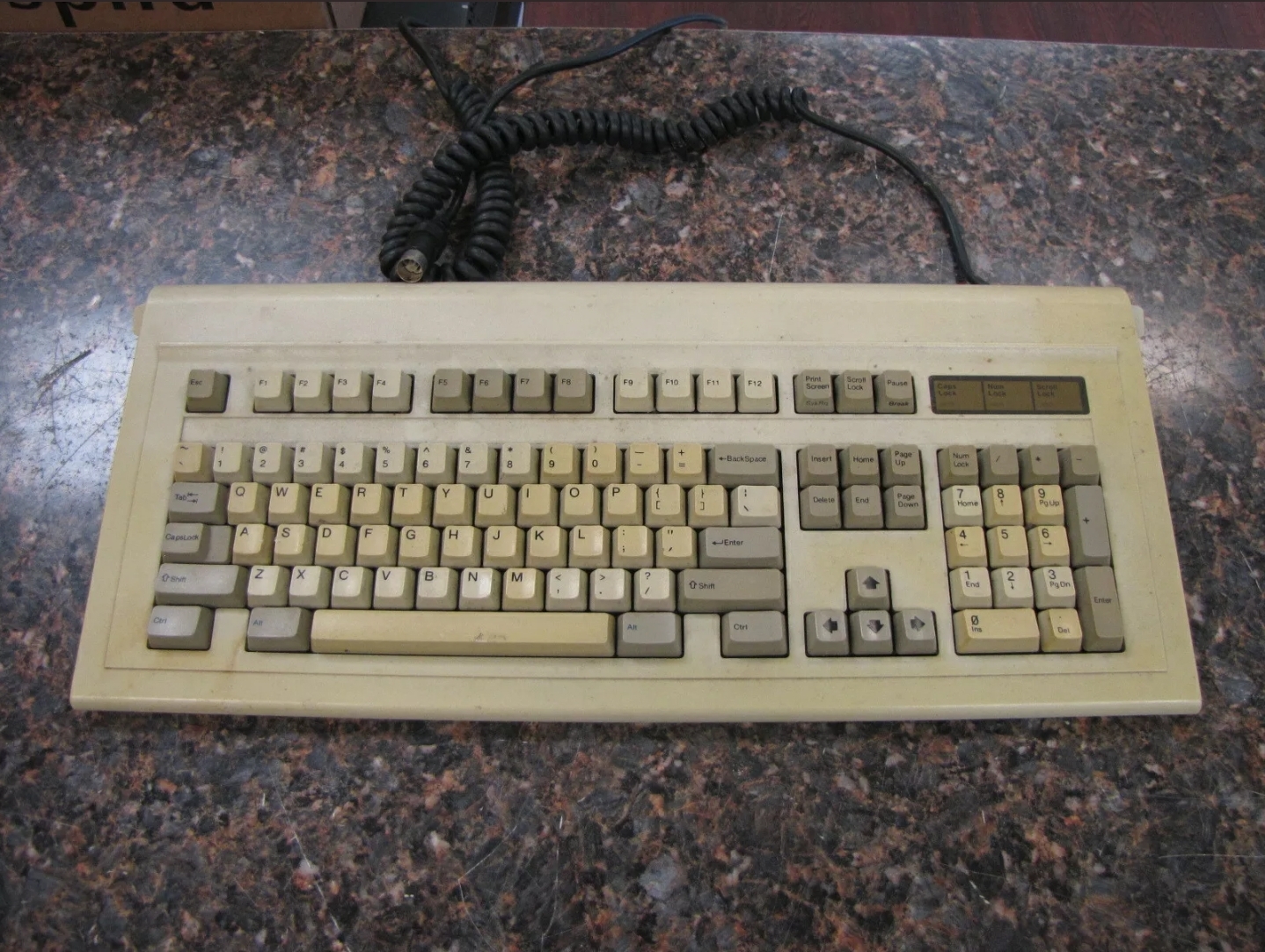

any ideas what this is? yellow alps suggest its not bad
only information on the back sticker is "north america 9281 17 01-01"

Looks like keyboard from Micro-Term 420 terminal https://www.reddit.com/r/MechanicalKeyb ... _keyboard/

- Jesseg
- Location: Australia
- Main keyboard: AEK1 - SKCM Salmon
- Main mouse: m720
- Favorite switch: Capacative buckling spring, Linear space invader
Looks like datacomp, I know some of those came with green and blue alps, I have one of the 515AT's and that had blue alps and the same arrow keys.
- Polecat
The bold arrow keys say Datacomp, but that Caps Lock keycap suggests something other than Alps. I'm guessing Futaba MA switches, but that's only a maybe.
edit: looks like a Datacomp DFK-501:
wiki/Datacomp_DFK-501F/502F
uttindar
- Location: Ukraine
- Main keyboard: XW60V1
- Favorite switch: SMK 2nd gen
Could be also wiki/Datacomp_DFK555 it looks the same (I have one right now). Futaba MA switches inside.
Also I have a problem connecting it to PC for some reason and some users on this forum had similar issue.
- Polecat
Just found this DFK-515, apparently there *were* Alps Datacomps with the big step on the Caps Lock key:
https://www.ebay.com/itm/133413851267
