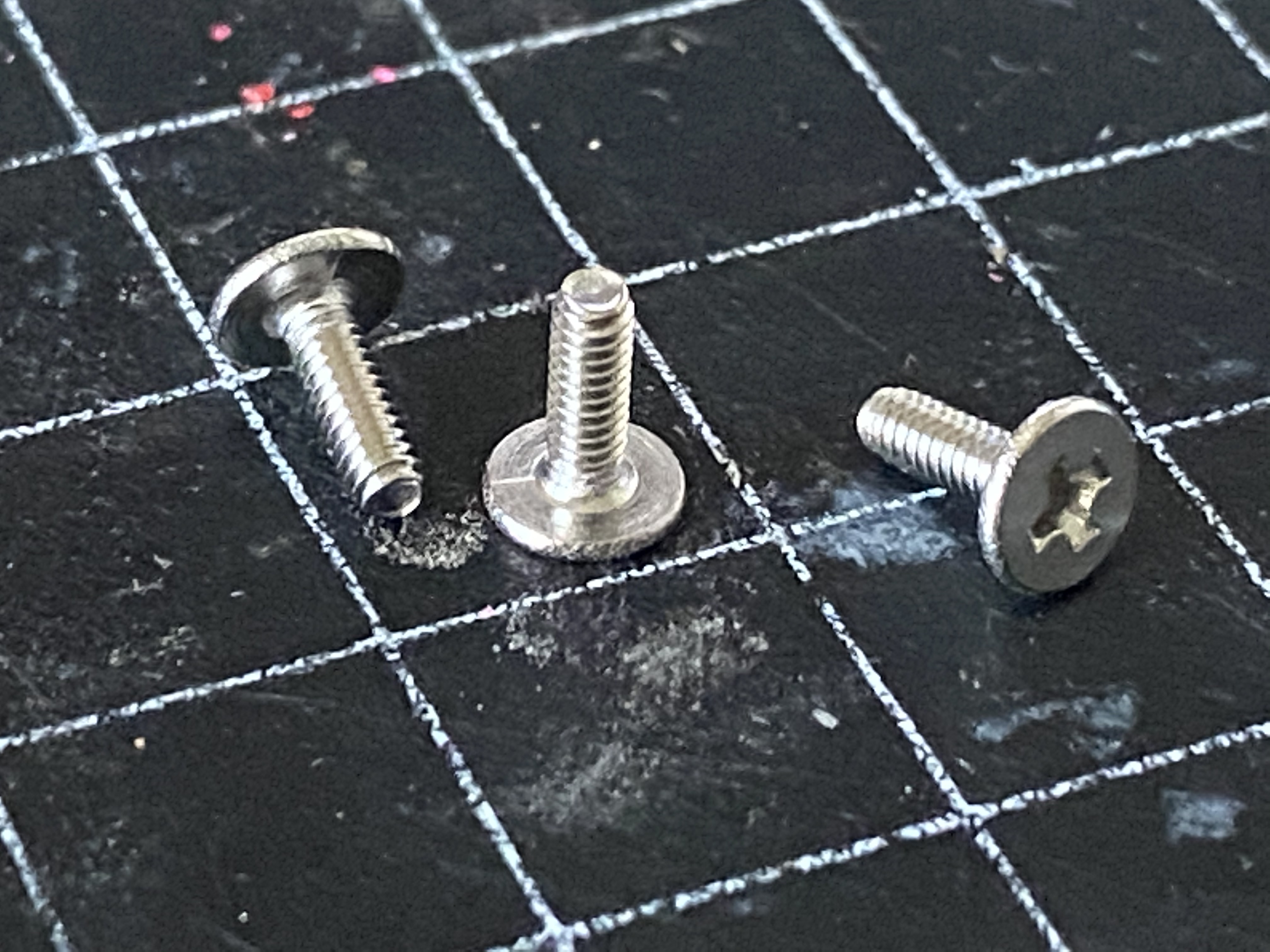

use this.
- CF1668C2-0C49-4B35-84BE-ECF49420E169.jpeg (1.64 MiB) Viewed 27536 times

I managed to find some nylon locknuts in M2 size, which I think will be more long term than regular nuts, but they're a bit taller. I ended up buying a whole bunch of screws (2.2 and 2.5mm diameter, 6mm and 8mm length, countersunk and normal heads) as well as m2 bolts and the mentioned M2 nylock nuts.
Do you have part numbers / link to those super flat head screws in the picture Anthony?

- anthonymak
- Location: Hong Kong
- Main keyboard: IBM Model F101
- Main mouse: Microsoft arc
here are some variety of super flat head m2 screws from aliexpress
