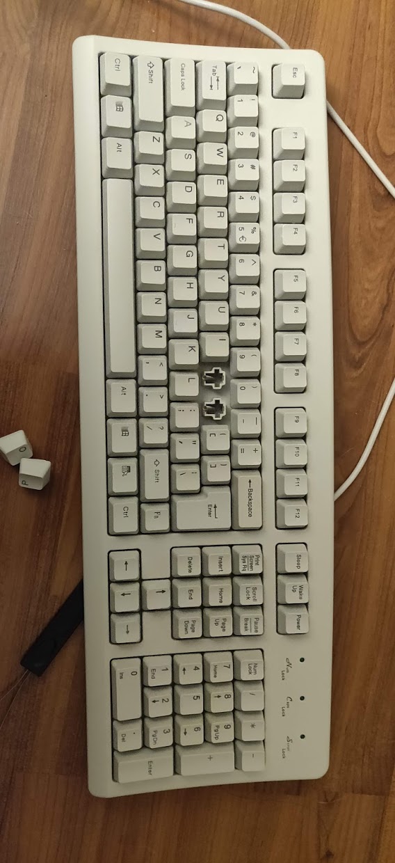

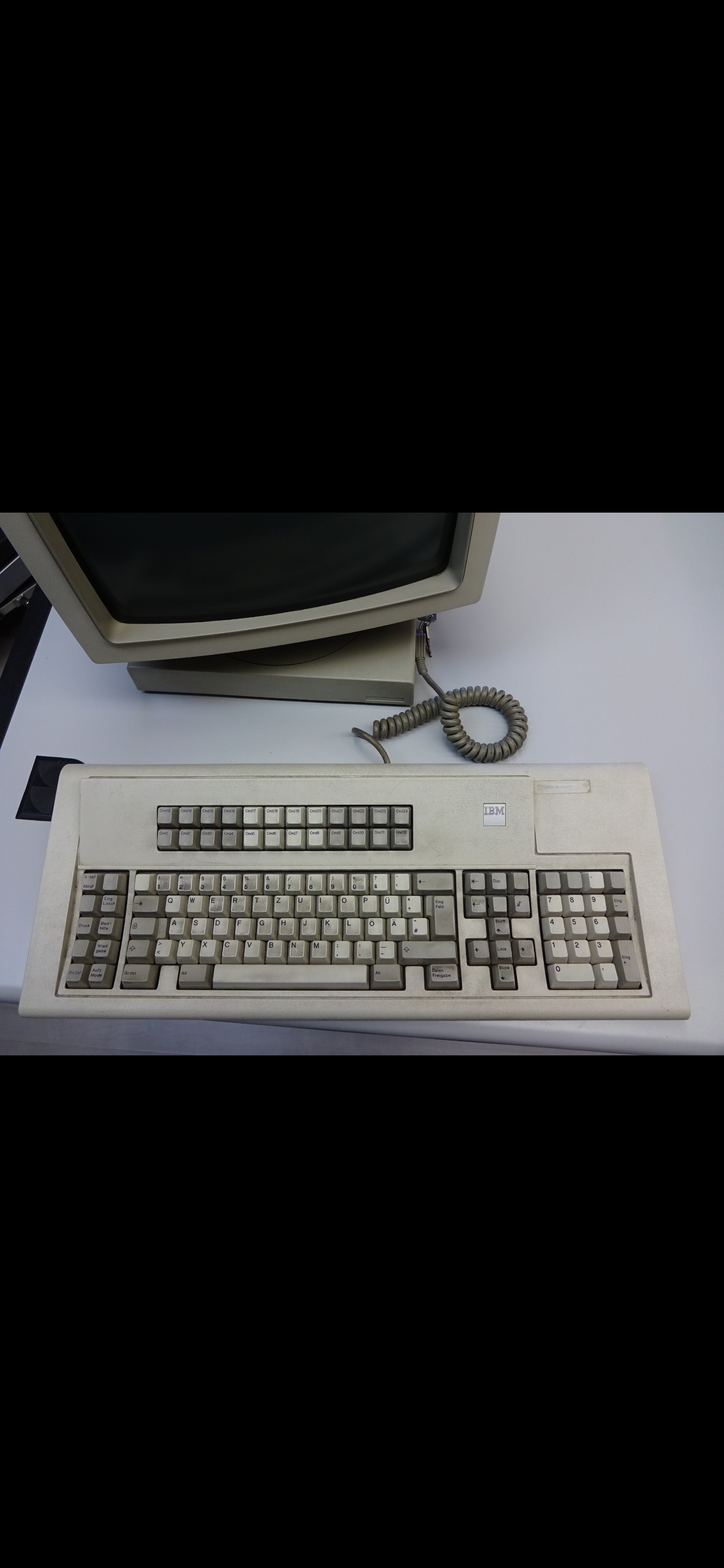

Hello

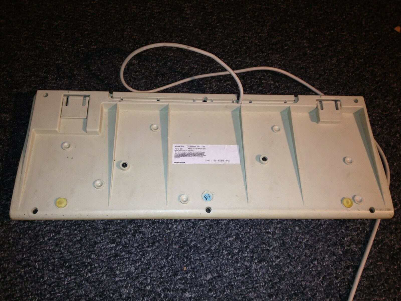

I've found this AT keyboard :
not a great shape and missing some key caps,cant read the sticker.
thanks
Lalaland124

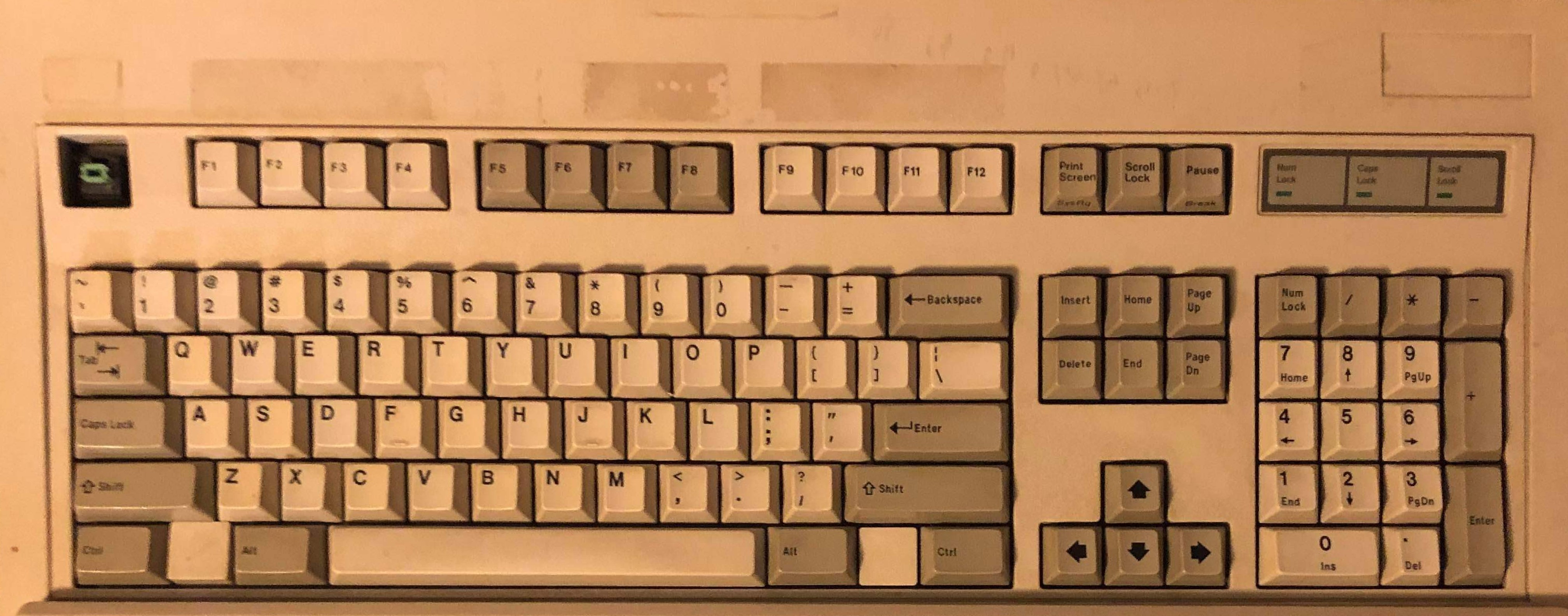

13 Feb 2021, 20:47
Aren't those buckling springs?
Lalaland124
14 Feb 2021, 15:23

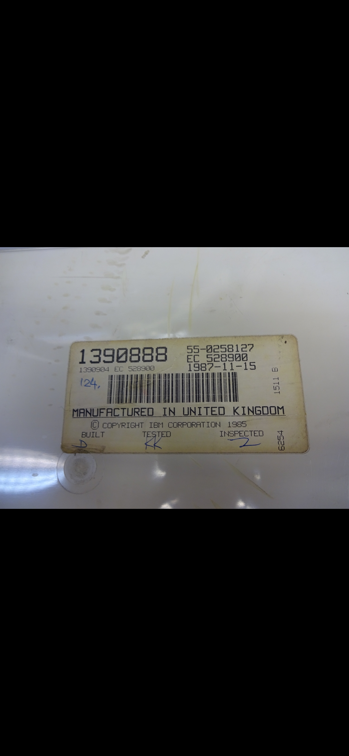

Is this the IBM Model M122 or F122 :)?
14 Feb 2021, 15:34
M
Those numbers usually start with 138 or 139, F-122 numbers usually start with 611.

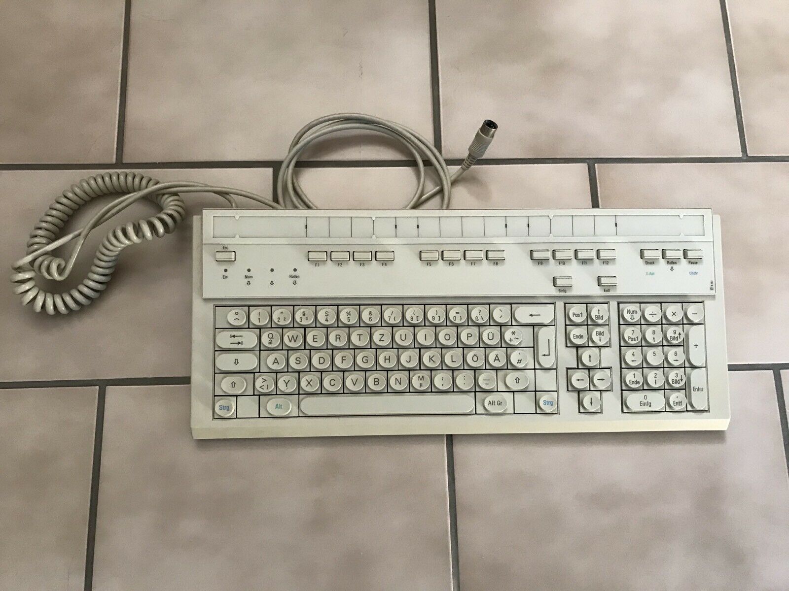

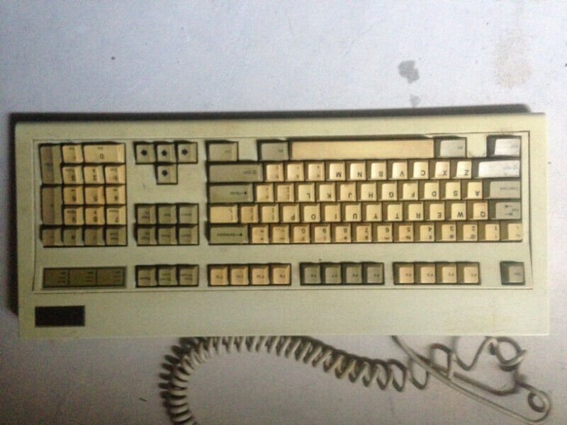

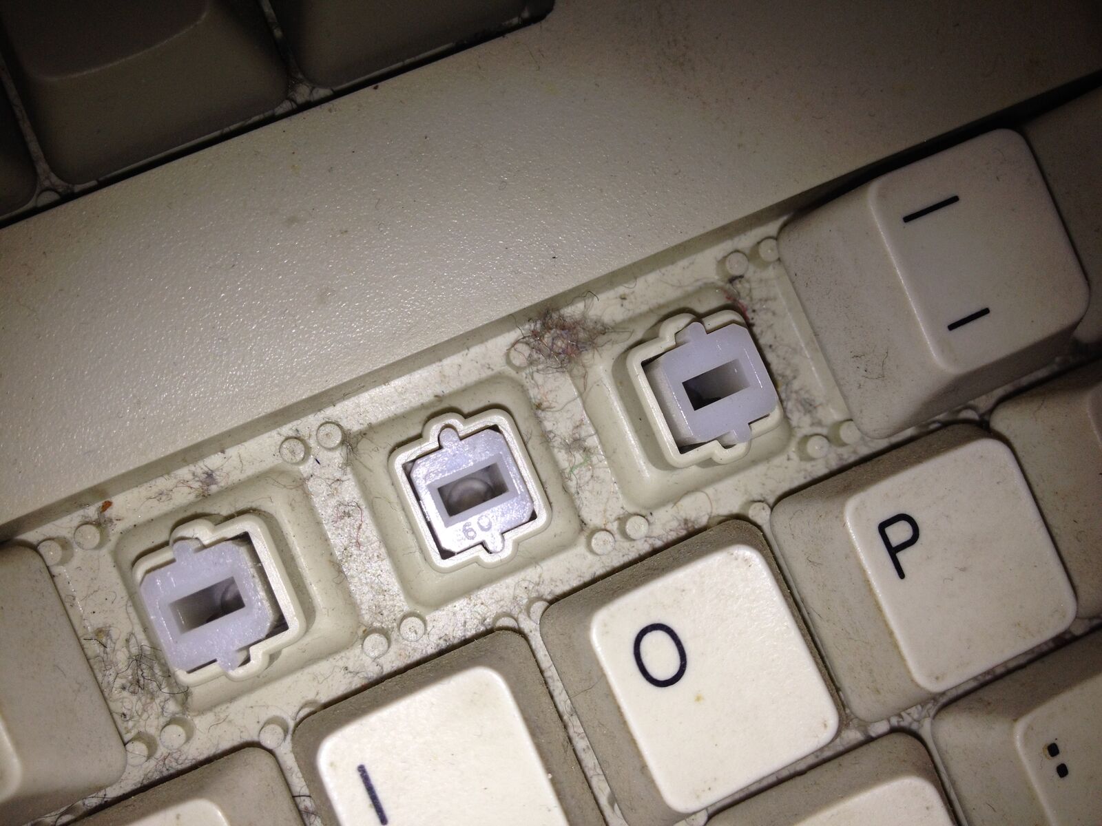

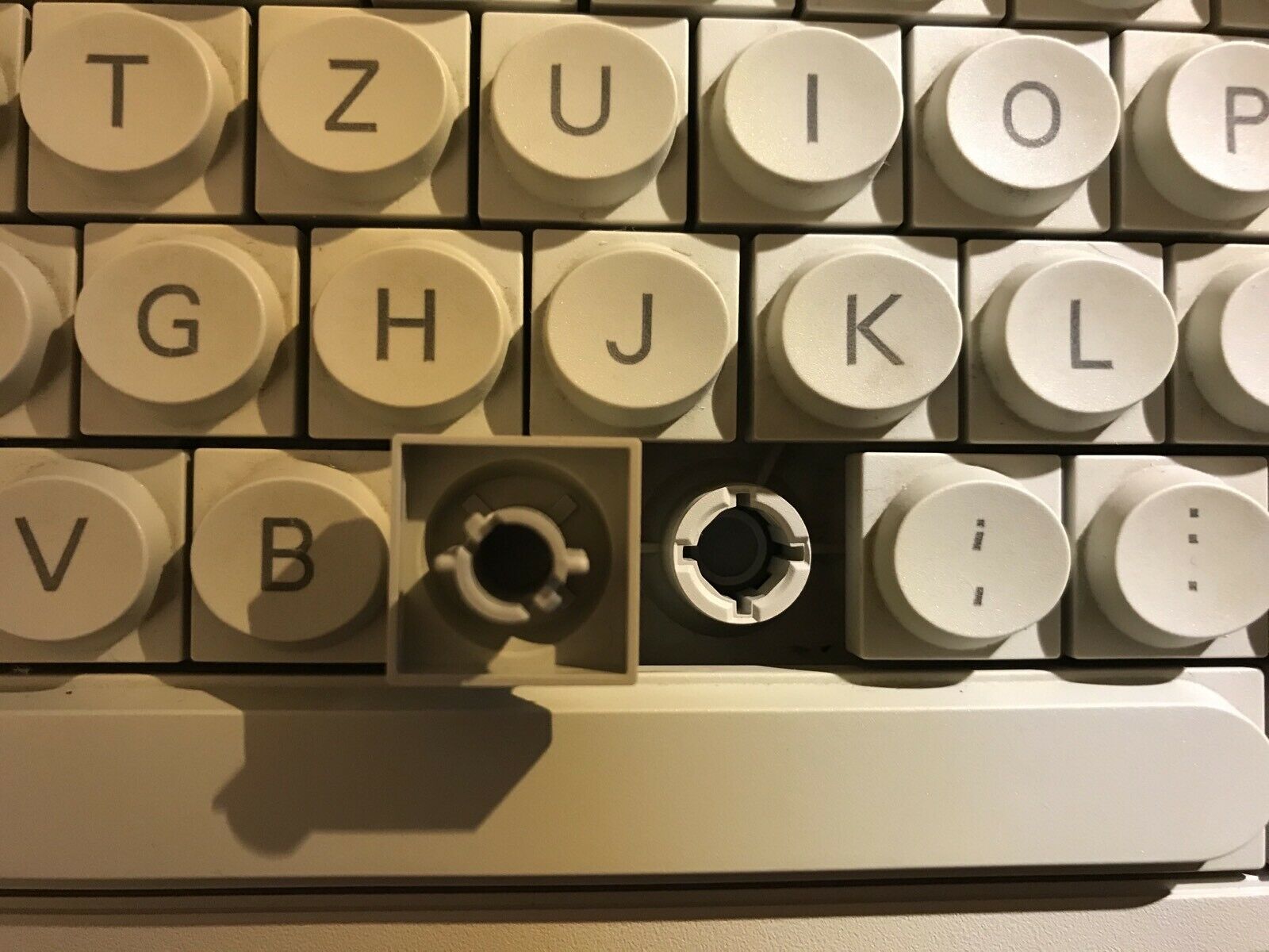

Nixdorf keyboard with ominous switches. Does anyone have an idea what these are?
$_57 (5).jpg (199.35 KiB) Viewed 10465 times
$_57 (4).jpg (145.71 KiB) Viewed 10465 times
$_57 (3).jpg (227.57 KiB) Viewed 10465 times
Go-Kart
15 Feb 2021, 09:32
O.K. guys, Lion Tech. Read a bit about one model being made by Dih Shin bit I can find little else. More interested in this style of dome with slider; haven't seen one like it before. Anyone recognise it?

hellothere
17 Feb 2021, 19:46
Rhododendron wrote: 14 Feb 2021, 19:17 Nixdorf keyboard with ominous switches. Does anyone have an idea what these are?
wiki/Fujitsu_Siemens_KBPC_S2
Rubber dome.

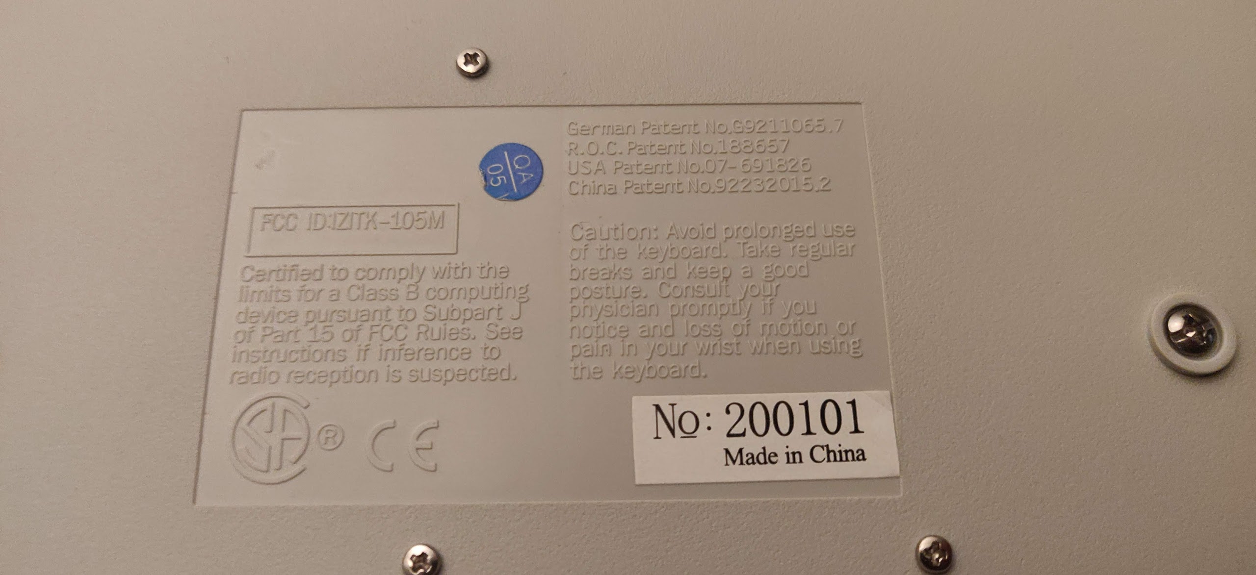

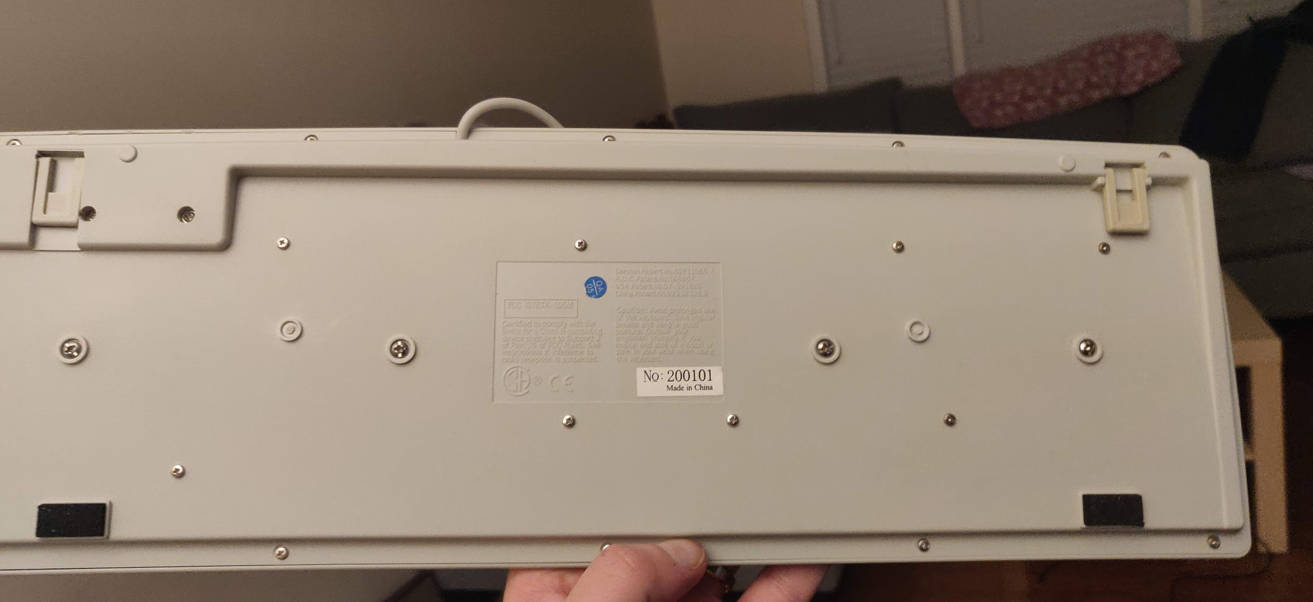

leetuser
22 Feb 2021, 07:13
I have a buckling spring board here. I looked up the FCC ID it seems to belong to Can Technologies. There's even an entry in the wiki about the FCC ID but this keyboard is different. No model or manufacturer listed but it lists the same patent numbers. It's clearly newer as it has windows keys.
22 Feb 2021, 12:56
Branded "Syncan" or "Can". The model number is there in the FCC ID after the grantee code. https://www.youtube.com/watch?v=un65h8NWSAE

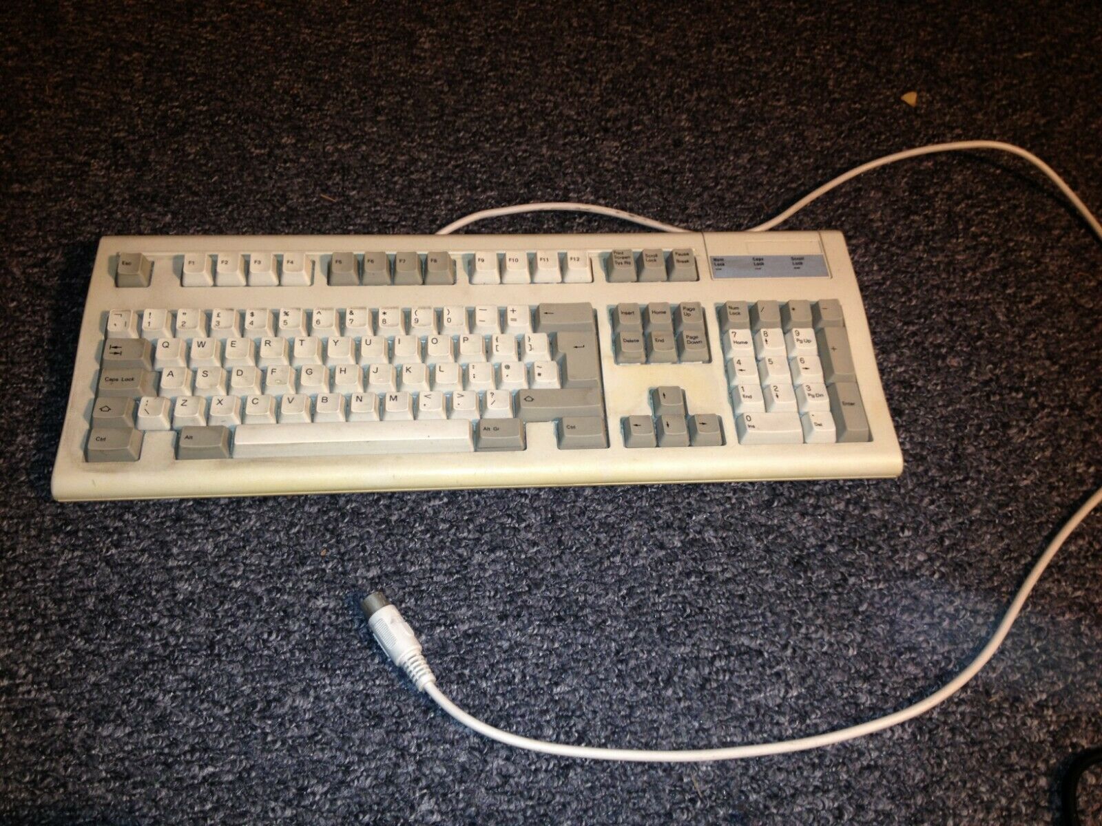

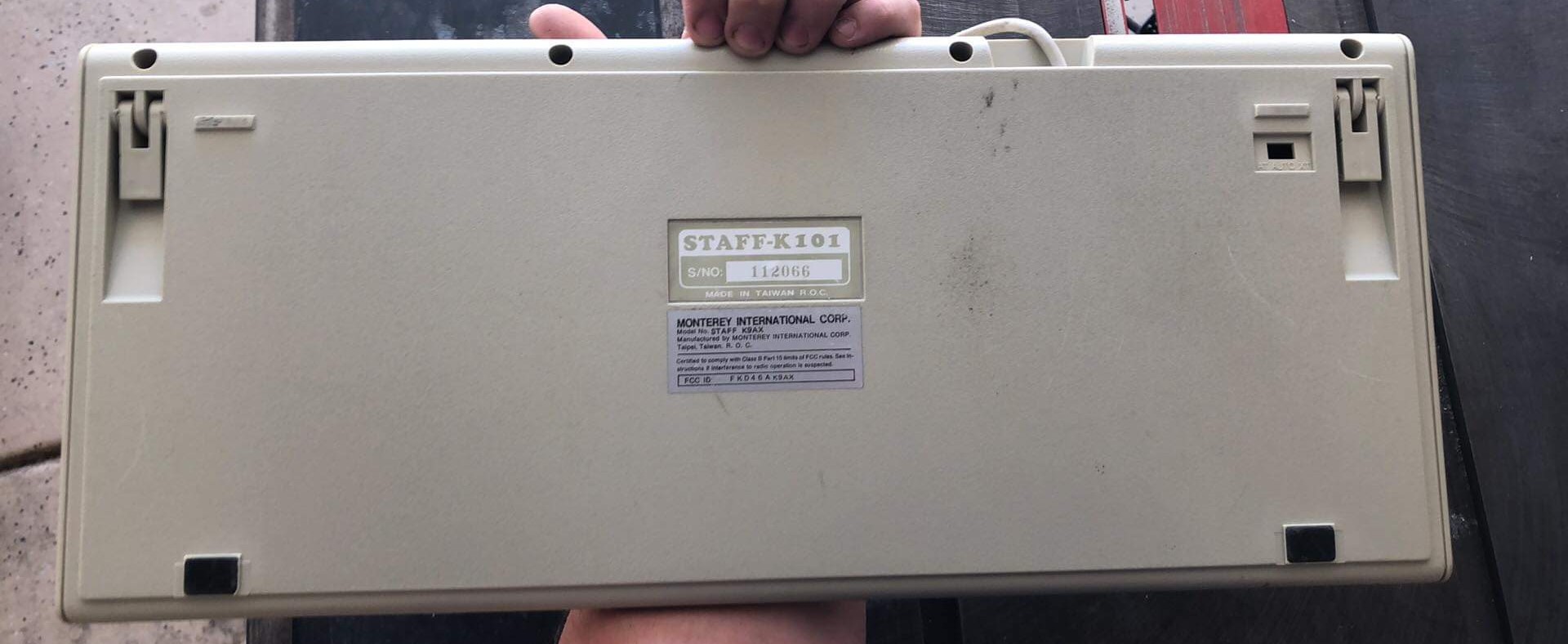

Anyone know what this one is? It's in my local classifieds and I'm debating picking it up.
Polecat
02 Mar 2021, 17:45
Monterey K102. White or blue Alps SKCM.
edit - right case, wrong layout, unless there was an ANSI version?
Willy4876
02 Mar 2021, 18:56
Yeah that's what I thought too but I didn't see mention of an ANSI version on the wiki. The legend placement on the numpad 0 is pretty distinctive though. Especially when combined with the bold arrows. If I manage to get it then I'll try to post an update.

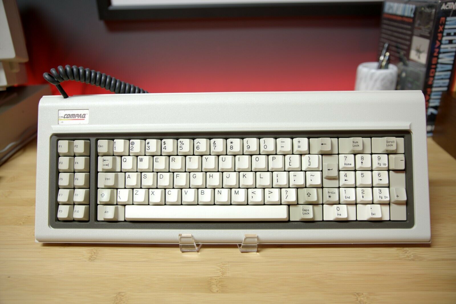

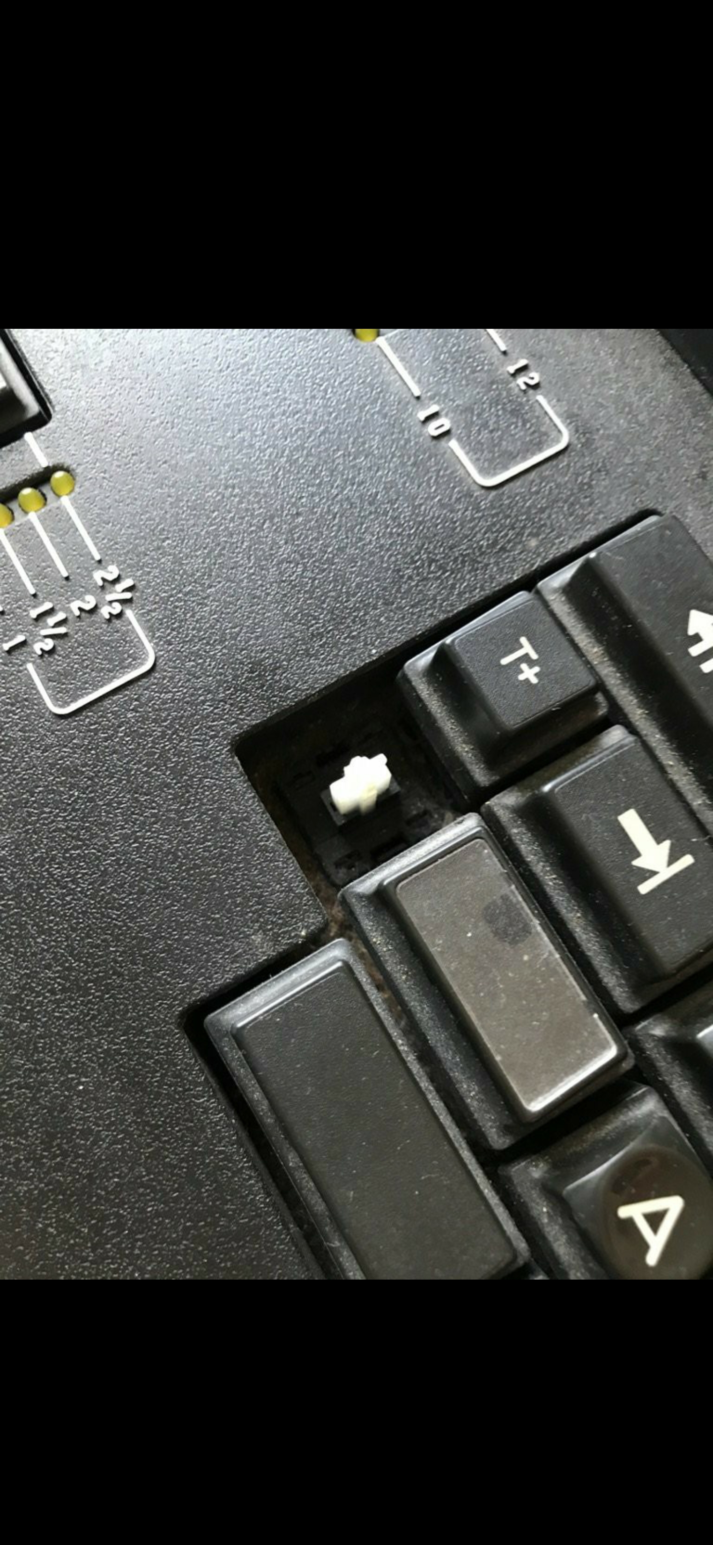

Does anybody know, what kind of switches that Seequa Chameleon keyboard uses:
https://www.ebay.co.uk/itm/RARE-Vintage ... Swmyle5qqe
Rayndalf
03 Mar 2021, 00:00
AJM wrote: 02 Mar 2021, 22:11 Does anybody know, what kind of switches that Seequa Chameleon keyboard uses:
Keytronic foam and foil I think. The position of the lock lights are either that or space invaders, but the keycaps look like doubleshot DCS so it can't be space invaders.
Of course with a replacement PCB, keycaps and switches, it's be a great case (powdercoated bent metal).
Lekrafter
03 Mar 2021, 01:17
Rayndalf wrote: 03 Mar 2021, 00:00
Can confirm, f&f
TNT
03 Mar 2021, 01:30
Are you guys sure? The caps look very similar to the ones on my Unitek K-150L. That would mean they could be some form of Cherry switch...
TNT
03 Mar 2021, 01:32
Alright, nevermind. They look an awful lot like the caps of those Compaq XT boards. So most probably f&f.
Polecat
03 Mar 2021, 03:27
Willy4876 wrote: 02 Mar 2021, 18:56 Yeah that's what I thought too but I didn't see mention of an ANSI version on the wiki. The legend placement on the numpad 0 is pretty distinctive though. Especially when combined with the bold arrows. If I manage to get it then I'll try to post an update.
Just checked my database, and there is a K101 listed with ANSI Enter, no filler keys on the bottom row, and "K102 style case". Switches are blue SKCM. Rebranded as "Staff". No promises, but this could be a nice find.
4_404
03 Mar 2021, 06:29
Polecat wrote: 03 Mar 2021, 03:27
I have an ANSI "Staff-K101" with model number Staff K9AX, and SKCL greens. K101 style case, but with blockers instead of filler keys on the bottom row. Not the same, but thought it was similar enough to mention.
AJM
03 Mar 2021, 09:19
Thank you very much.
(I would have been more interested in the keycaps and PCB (if they would have been MX compatible), though. I find the shape of the case a bit .... "rudimentary". :mrgreen:
Thanks to Lecrafter and TNT as well.
