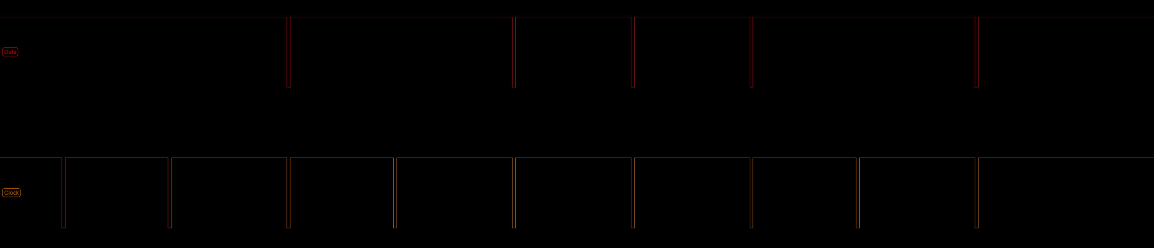

Here is some analysis done with the tool scla. Does someone see something unusual or potential wrong?

coolrainbow20 wrote: 20 May 2021, 20:16 I fixed the problem by uploading the ibmpc_usb firmware from the tmk repository to the device.
But since the firmware seems pretty unreliable, I can't really use it.
So what's the status now? It seems like it has "sticky" keys with Soarer's converter firmware but it works with a particular version of TMK?

JBert wrote: 22 May 2021, 23:55 So what's the status now? It seems like it has "sticky" keys with Soarer's converter firmware but it works with a particular version of TMK?
With Soarer's Converter I just get "rFF" on every keypress. And only with the TMK converter I can barely even use the use the keyboard. But even then it throws some errors. All other keyboards I've tested with this converter (AT and PS/2) are working with Soarer's and TMK. So I think there is something wrong with this keyboard. Also someone who has this exact keyboard seems to have problems while using it with the computer the keyboard came with. https://hblankes.home.xs4all.nl/Museum/ ... titerm.htm

coolrainbow20 wrote: 23 May 2021, 15:15 With Soarer's Converter I just get "rFF" on every keypress. And only with the TMK converter I can barely even use the use the keyboard. But even then it throws some errors. All other keyboards I've tested with this converter (AT and PS/2) are working with Soarer's and TMK. So I think there is something wrong with this keyboard. Also someone who has this exact keyboard seems to have problems while using it with the computer the keyboard came with. https://hblankes.home.xs4all.nl/Museum/ ... titerm.htm
It's still possible that this keyboard is sending data just a little too slow so that the converter errors out. It will be hard to troubleshoot unless you get accurate timing information out of a logic analyzer or oscilloscope. And once you figure that out it will take some time to find why the keyboard is out of spec (maybe a worn out capacitor or a bad connection somewhere? Who knows)...
It might not be worth all that trouble though. Have you considered desoldering the controller (and possibly some other components) and hooking up your own controller? It might even allow you to sync the num lock and caps lock leds with the computer then rather than being limited by the XT keyboard protocol.
