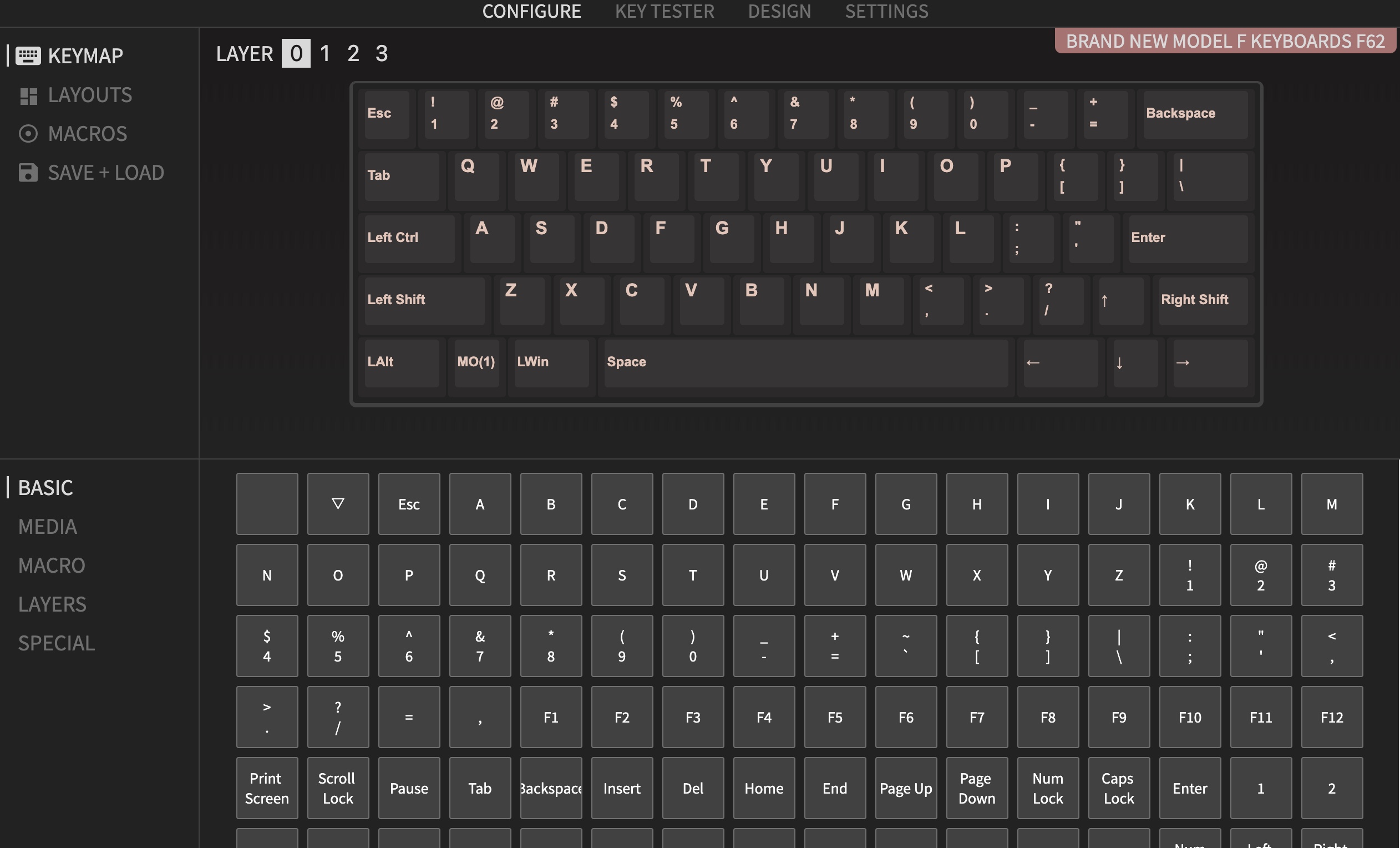

I have added the tested VIA files (Firmware, Layout, and small PDF that explains things).
They are built for the Brand New Model F (F62 and F77 - all layouts). Everyone who wants to test the easy to use VIA App to assign the key layout - you can download the latest versions from here:
https://www.bucklingspring.com/via-firmware-and-layout/

Hi,
I have just received a new Model F62 and thought I'd give this firmware upload a try but a few things are not clear to me - sorry for the newcomer questions.
I downloaded "QMK Toolbox", "VIA" and "Firmware for VIA" from the links on www.modelfkeyboards.com/manual and I also see the layout files from "https://www.bucklingspring.com/via-firmware-and-layout/" for the F62 - the "all keys" one.
1. The PDF readme instructions mention that; If Fn+Space+R works then I already have QMK installed - this indeed worked on my F62. So first question, if this is the case do I still have to Erase the
firmware or can I just go ahead and flash one of the Layout .hex VIA specific firmware files. The action to be taken is not clear to me?
2. In the Layout zip file are some 46 layout files, clearly I should choose one of the F62. However, I have a HHKB - split right shift + spit backspace. There don't appear to be any that match this? Also there appear to be three types; (i) F**, (ii) Via F** and (iii) zF**, I guess Via is for Via but what are the other 2 types for?
3. Lastly, given that I already have firmware on my F62 why do I need to flash anyway? Shouldn't VIA just be able to detect my keyboard so I can make key assignments - again this is not clear? I have
tried it and VIA just reports " searching for devices ..", clearly my mental model of the process is not right ...
Thank you in advance for any insights you can give me ....

Sorry for my late response:Tarmac wrote: 28 Apr 2021, 03:27 Hi,
1. I would always erase the firmware first. I have seen a strange behavior if it is not done.
2. Ellipse has done this a bit differently than me. If you use my files, you won't need any of those json files. It is prepared already and nothing is required.
3. The firmware pre-flashed on your board most likely doesn't have VIA enabled. That is the reason, why you need to re-flash it once. After that first initial flashing, you can go ahead and assign keys in the future without ever re-flashing.
Hope this helps,
Roland

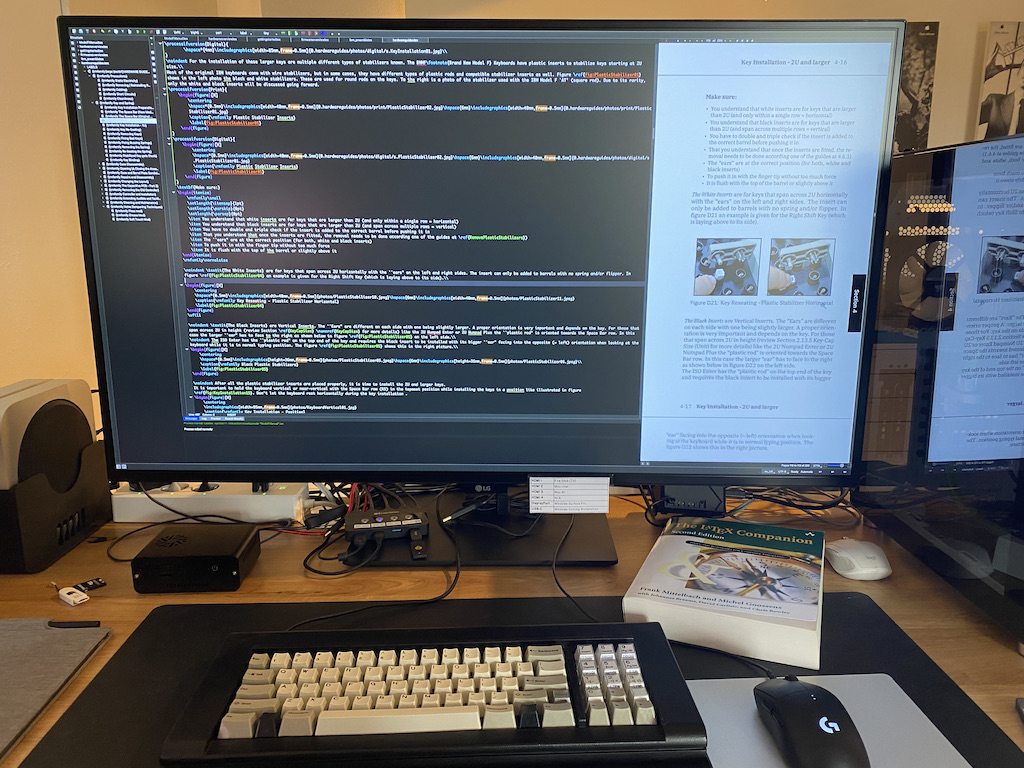

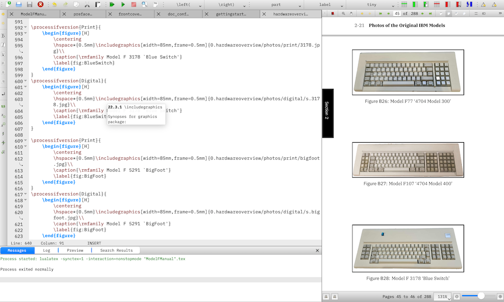

I wanted to give a quick update on the status of the Technical Manual.
After chatting with Zed (who's ideas and work I value so much), I dissected the LaTeX document and started to do a small rebuild of what we have so far.
I have not only segregated the sections into different files, I also did the same for the figures and photos.
Furthermore, I segregated two variants of the Manual:
The Print version will use the original IBM design with rotated pages, tables, or graphics. The size of the photos is normally full size in best quality including color profile.
Within the latex typesetting files I am using a processifversion detection, so it will automatically produce the versions needed. All within the single project.

Today I released probably the largest update of the Model F Technical Manual, yet.
I have re-written it so it has a print and digital (viewing) version. Both versions are not only different in size but also in its appearance. For example, the digital version has no 90 degree rotated tables or drawings, as you can easily zoom in to your needs, I also optimized every photo for sRGB instead of printing colors. Tables have been re-created for each variant; drawings went through the same exercise.
Finally, I have re-drawn nearly all illustrations that previously used PNG or JPG files. These are now SVG, EPS, or PDF line art graphics.
https://www.bucklingspring.com/download ... reference/

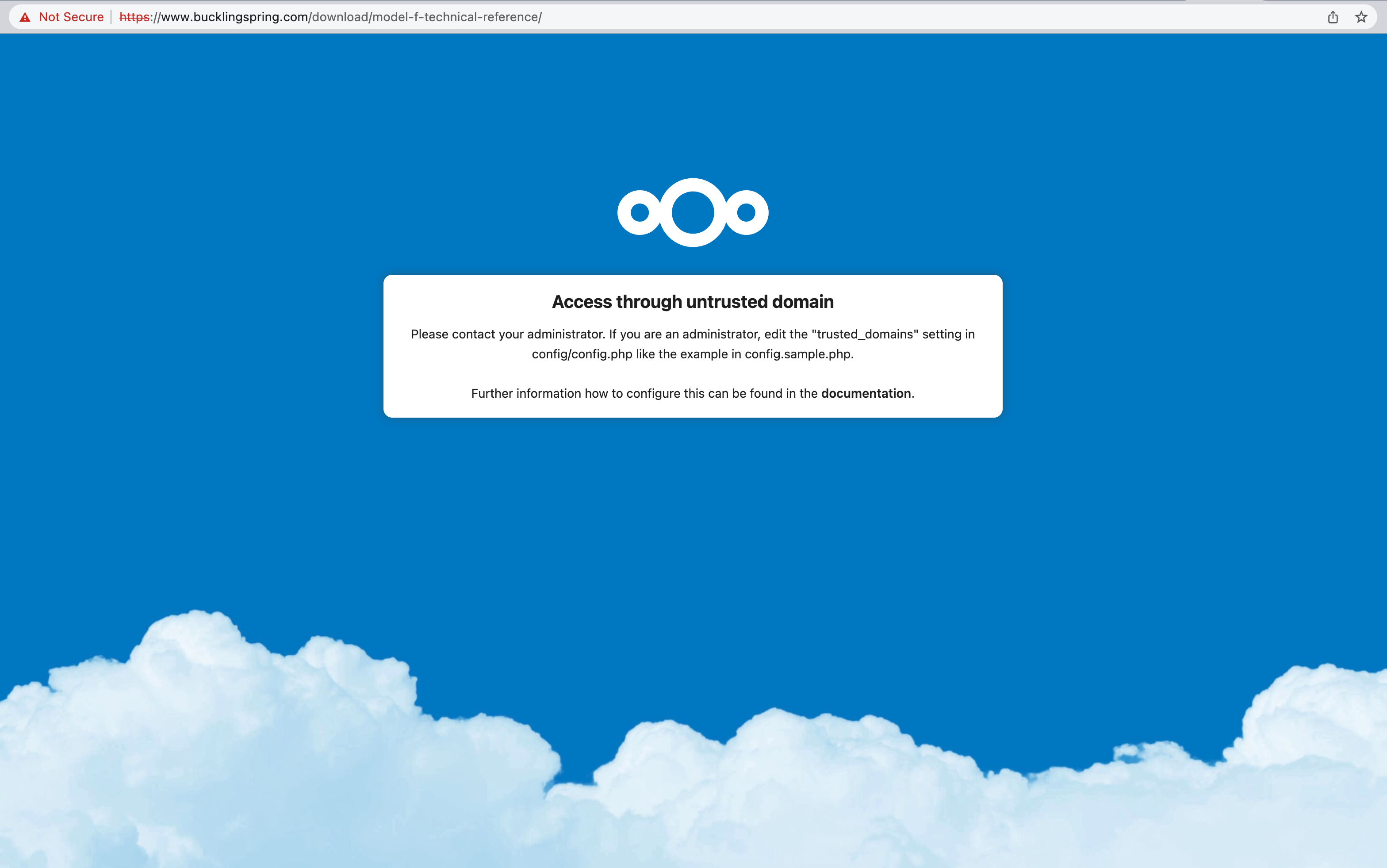

I'd love to be able to check out the website (bucklingspring.com) and the manual, but I get an error anytime I try. Has anyone else here run into this issue and if so, what's the work-around.
Thanks!
Thanks!
- Screen Shot 2022-11-11 at 1.52.18 AM.png (1.1 MiB) Viewed 5993 times
- darkcruix
- Main keyboard: Brand New Model F F77 Keyboard
- Favorite switch: Ellipse version of Buckling Spring / BeamSpring
- DT Pro Member: 0209
I am in the process to move the site to a different cloud space. Unfortunately, I had to stop in the middle for a week or so. I have uploaded the actual version to this temporary link for now: http://195.90.200.37/ModelFManual.pdfj-pevar wrote: 11 Nov 2022, 10:54 I'd love to be able to check out the website (bucklingspring.com) and the manual, but I get an error anytime I try. Has anyone else here run into this issue and if so, what's the work-around.
Thanks!
