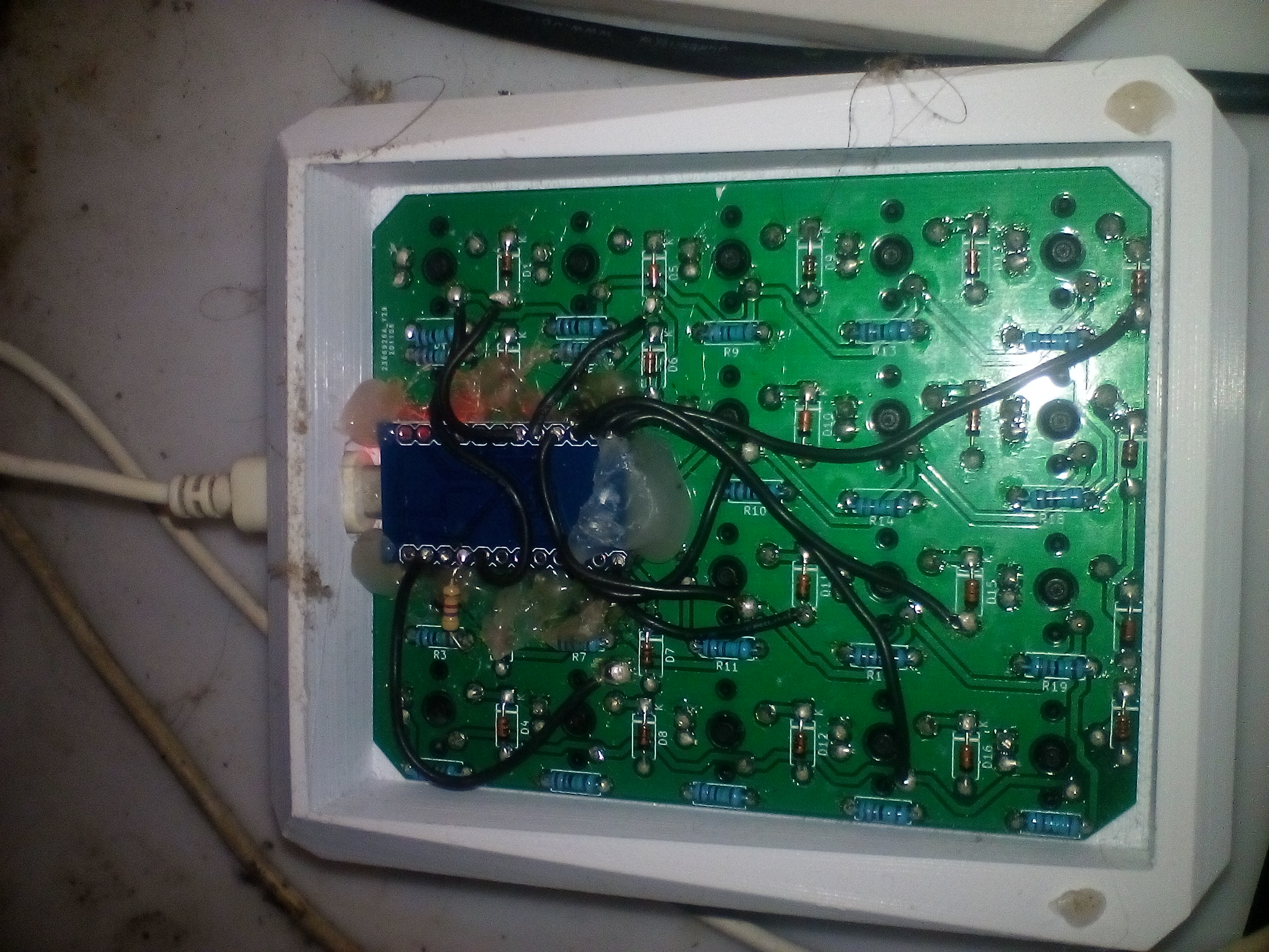

it's probably to late to change design but if you're interested i have a backlit 5x4 grid pcb that has done most of the work already. i put 3 of them in my 3d printed preonic clone. all you would have to do is space each pcb slightly to give the separation you want, and chop one column off the nav cluster, and modify the file for a 2u numpad enter if it is really important. it's really cheap to buy cos you get 5 pcbs usually so that will do the entire keyboard.
you would have to modify the GK47 on thingiverse 3d printed file to add the appropriate separation, and blockers. that's beyond my abilities though, i didn't design the 3d print.

Nice work. At this point I'm all in and going for broke. I'll either be very proud that I made my own design keypad from scratch or I'll rue the day I ever heard of mechanical keyboards, and I hope it's the former!
