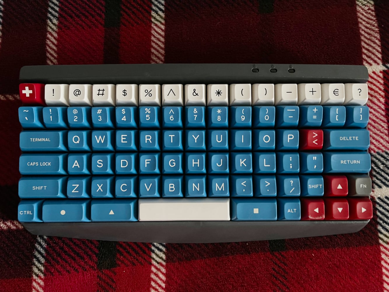

19 Oct 2021, 11:44
POS keys are real. Spot the single unit modifier keys. ;)
That little ortholinear matrix keyboard of mine has a simple uniform grid of switches. I wouldn't advise using 2 unit or 4 unit wide keys, if you're designing your own thing. Those keys all feel just as heavy as you'd expect with the extra switches underneath!
As for numpad keys: they have specific scancodes in the USB keyboard spec, so your computer definitely knows you're pressing numpad 7 rather than numrow 7. But here's a question: what keys do you actually need? I'd advise starting small. You can leave out whatever you want.

The trick to using 2U POS caps that span 2 switches is to cut the spring in the second switch in half,makes it feel much nicer,you will have to replace the spring if you ever want to use that switch again though.
19 Oct 2021, 16:15
Sure. But they still don't stabilise right: they don't go down straight unless you press them dead centre. I wouldn't advise multi-switch caps when you're doing your own design.
