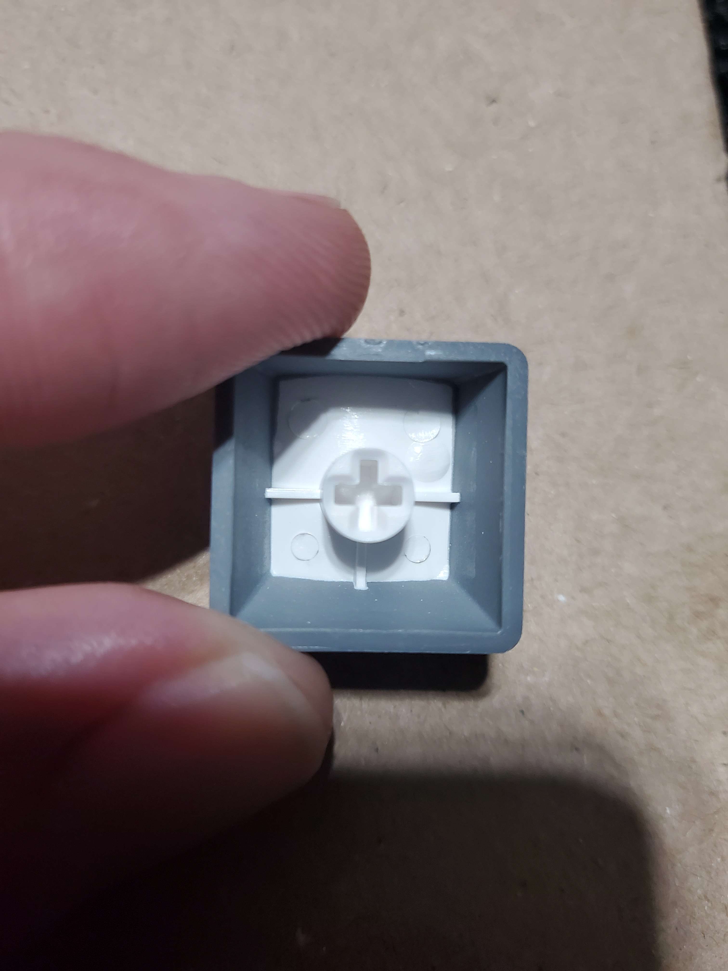

Here's the cap from the F key on my Das, since I figure it is probably one of the most used. A few of the caps on that board are starting to shine even though they're PBT and that's the set I have had on the same set of box switches the longest.
Does it look even slightly damaged at all to you? Do what you will, but I would just get some decent double shots to replace the lasered caps that came on that one and enjoy.

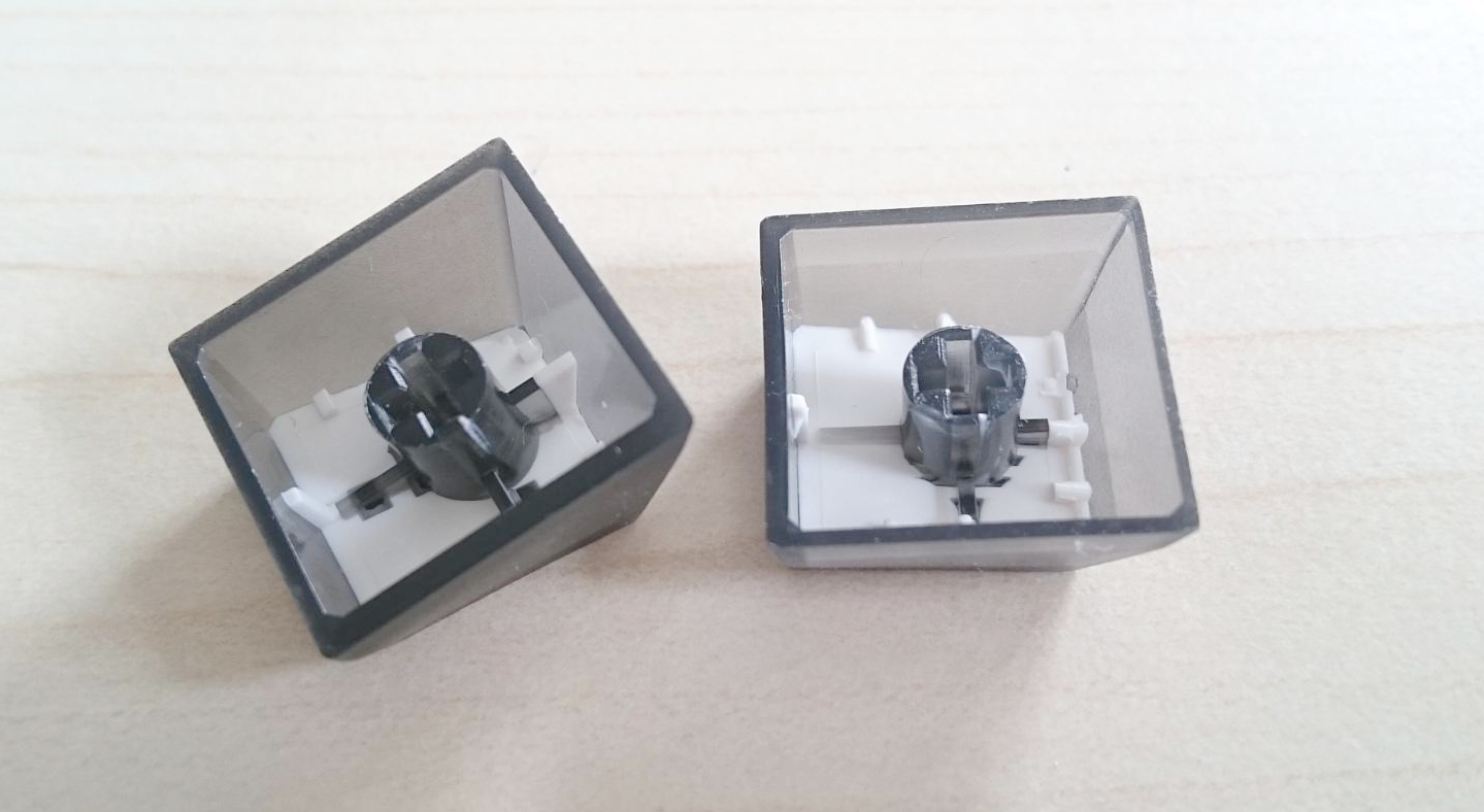

The left cap has been on a BOX White, the right one on a BOX Pink.

The cap on the right looks to have a crack in its stem, the left one seems fine though. Hard to tell from the pic. Got any more that have been wrecked?
I’m no fan of Box switches (tried a tester with Jades and Navies etc., meh, didn’t buy any) so I’ve no agenda to protect their rep. Does seem strange that there is no uproar against them if they really are still mincing caps, though.
Regarding the left one: Look closely. There is a white mark on the stem, even bigger than the mark one stem of the right one. I didn’t check all caps, but I noticed cracks on many of them.

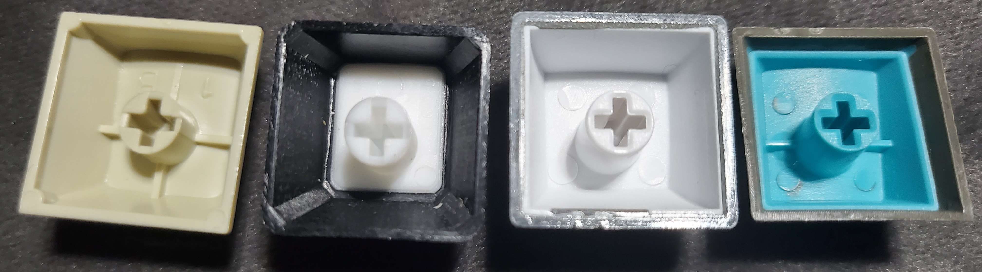

Here's the rest of the caps I have used for extended periods of time on box jade or navy switches from batches from 2020-2021:
From left to right:
Unitek K-151L OG caps used on box jades, TG3 OG caps on box jades, AKKO double shots on box navies, cheap Amazon double shots on box navies.
I have another box jade TG3 board, but that would be redundant. I put each of these caps one-at-a-time on a Cooler Master Quick Fire Rapid with MX blues and they were not loose on them.
From left to right:
