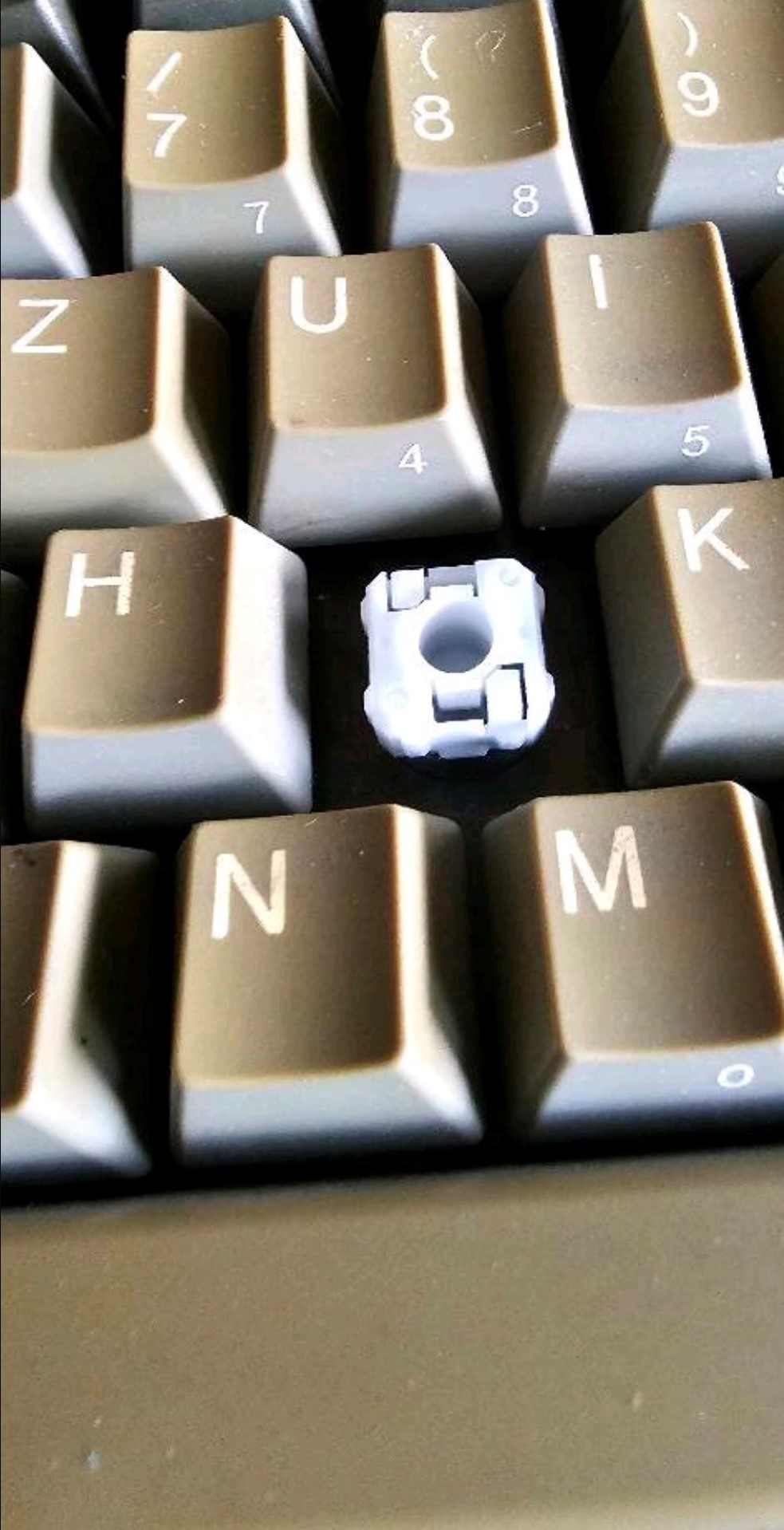

I'm not sure what board this is from so I can't confirm, but the slider looks a lot like Keytronic foam and foil, the low profile variant. I don't see a bar across the center like I do in most of the examples, but the mount is pretty distinctive and the keycaps look like they'd be compatible if the bar were there. Also, is the circular cutout in the top left a result of damage or are all the switches like that?

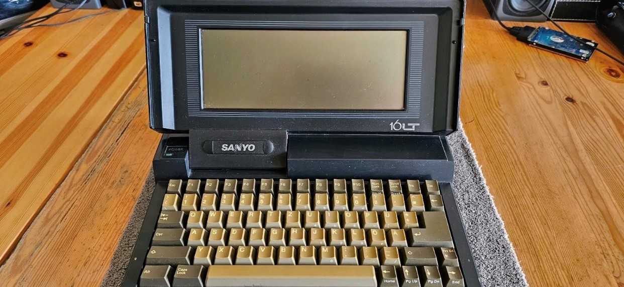

Somebody has a clue ?
At first I thought wiki/Fujitsu_Peerless but it doesnt look like that at second glance
Model: Sanyo MBC-16LT
inozenz
leafe spring, got that keyboard aswellguidemetothelight wrote: 15 May 2023, 10:15 Somebody has a clue ?

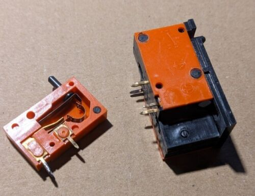

Could you guys identify these linear switches? Some early RAFI like this one? They are from a 1976 Videoton keyboard, part of the VT-340 display terminal. Manufacturing started in 1972 (Hungary). The switches are these big blocky ones, four long pins in a row on the PCB side. Unfortunately I can't get closer to them without desoldering:
More photos: https://imgur.com/a/zeLBbCl (some really nsfw)
- jsheradin
- Location: USA
Four pins per switch usually means contactless. Your board has TKI stickers on the inside which tracks with Rafi of some sort. They're definitely not RS74/76 and don't look like any of the RC72 examples that I've seen. Rafi magnetoresistive should only have 3 pins, 5 if they're an illuminated switch.
I say desolder one and hope there's some writing on the side. Whatever they are, they're not common.

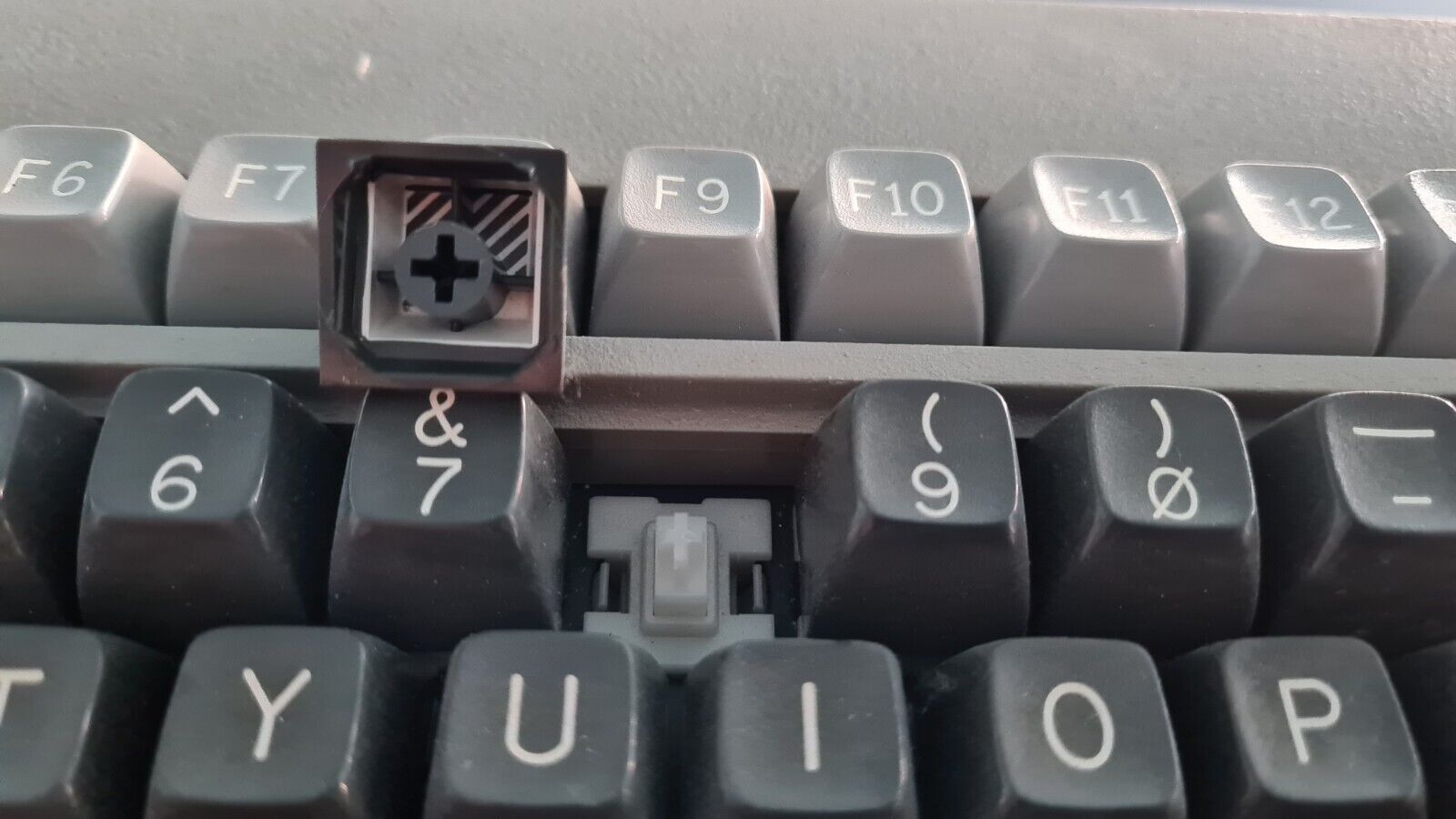

It was found on a Copam K-455 keyboard, but according to my search, K-455 should have dome and slider switches and not this kind of switch.
I have also looked into the Alps clone list but didn't find anything similar.
Does anyone has any clue what this switch is?
