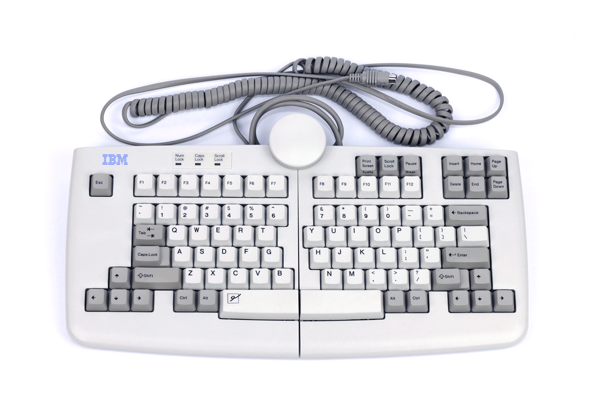

08 Feb 2016, 22:20
XMIT wrote: I'm glad you got this together with the parts you needed! I do still need to tear into an M2. I'm glad clickykeyboards was able to get you the parts you needed. :oops:
He also got me some parts for my other keyboards so it's all good. I bought a set of M2 caps at the start of this restoration but it turns out they were rubber dome caps or I would have sent you what you needed. Luckily, I found an inexpensive M2 that I pulled a key from. Now I need the M2 keys to finish off the M2. I DO like the M2!
Scottc, I forgot to reply to the "how does it feel?" question. It feels exactly like an M2 but it has some weight behind it :)

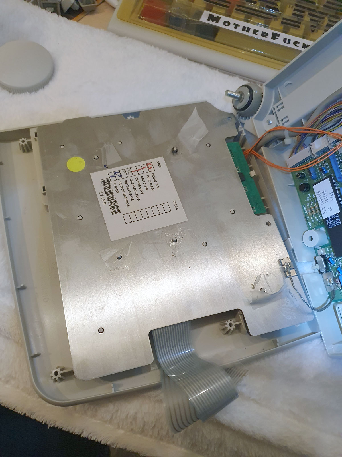

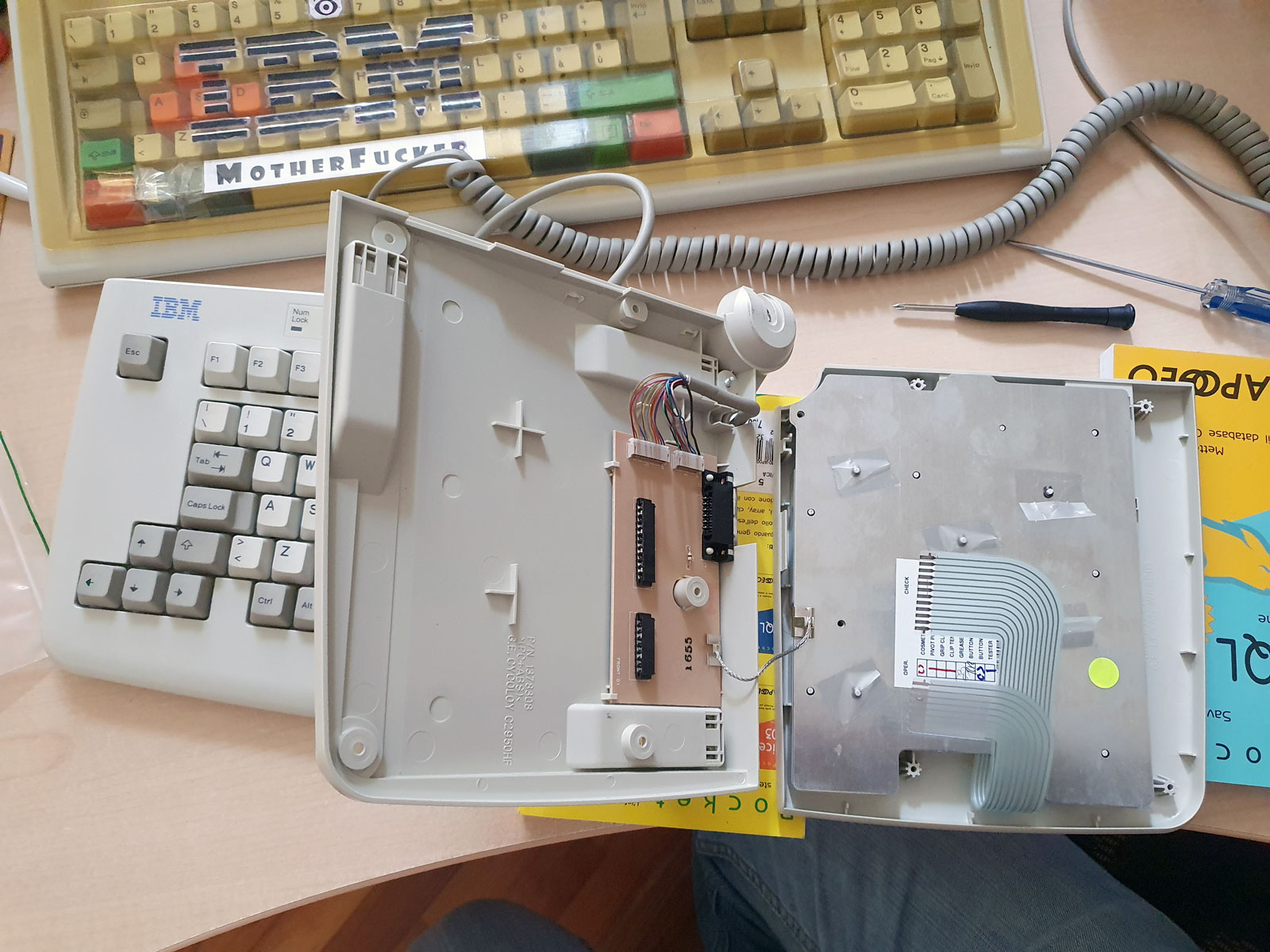

Drawing inspiration from your great daring - Snuci, I took courage for converting my ANSI IBM M15 to ISO, Italian layout. Yes! Now I'm writing this post with a f* 'fine' Italian IBM model M15.
Sorry for necro this post, but I thought that it would be more useful to publish here my m15 porno pics for future reference instead of creating a new boastful and useless topic on the like: "hey, look how smart I am", as well as being pointed out as a lucky bastard who owns an M15!

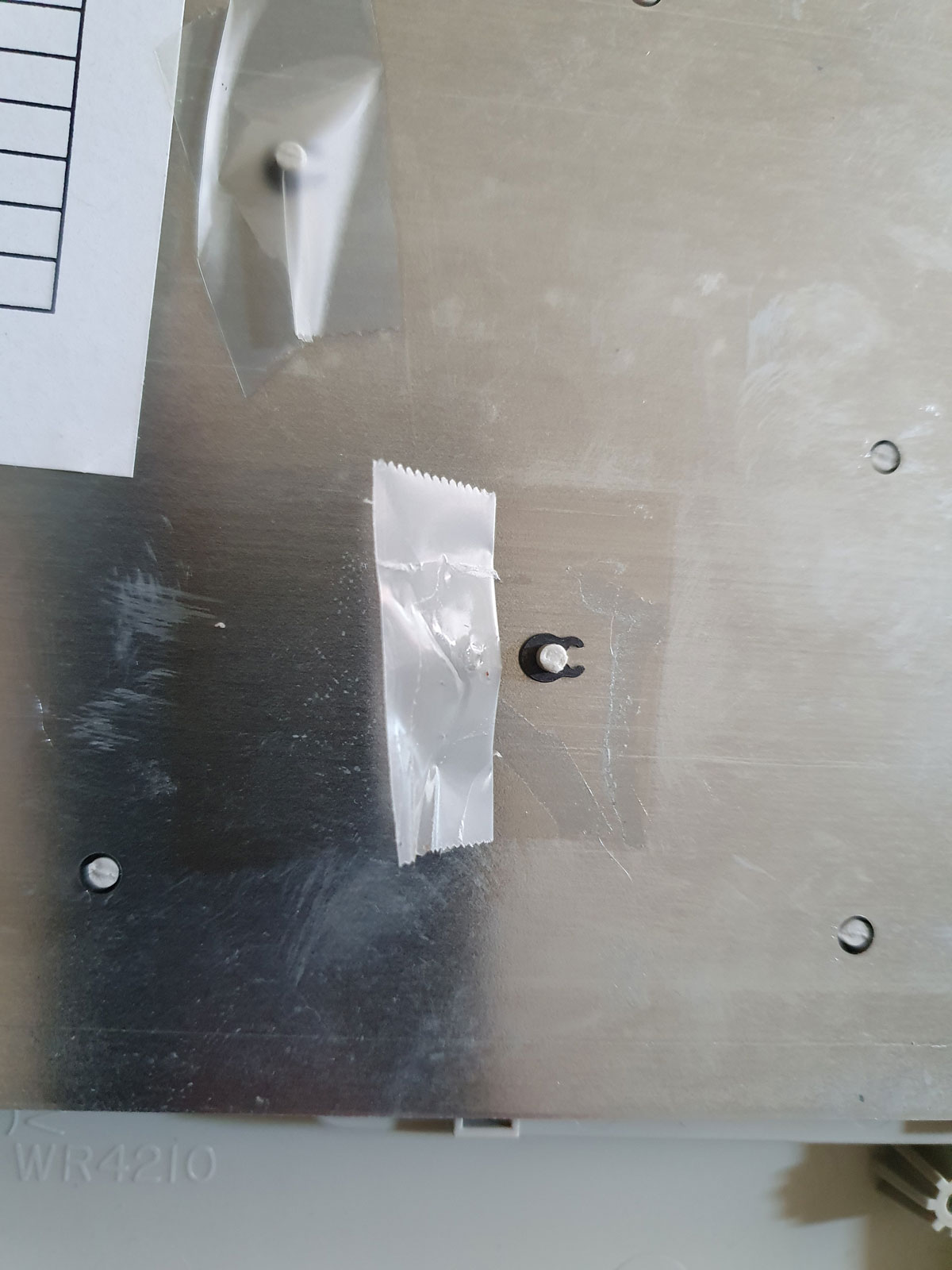

Opening up and tearing apart such an expensive and rare model requires a good dose of heroism. So starting from where someone else has already been is a nice start. The IBM M15 isn't as complicated to disassemble as an IBM M2, but those clips are really the worthy infamous heirs of the M2 flimsy plastic hooks. Here a closer look to them:

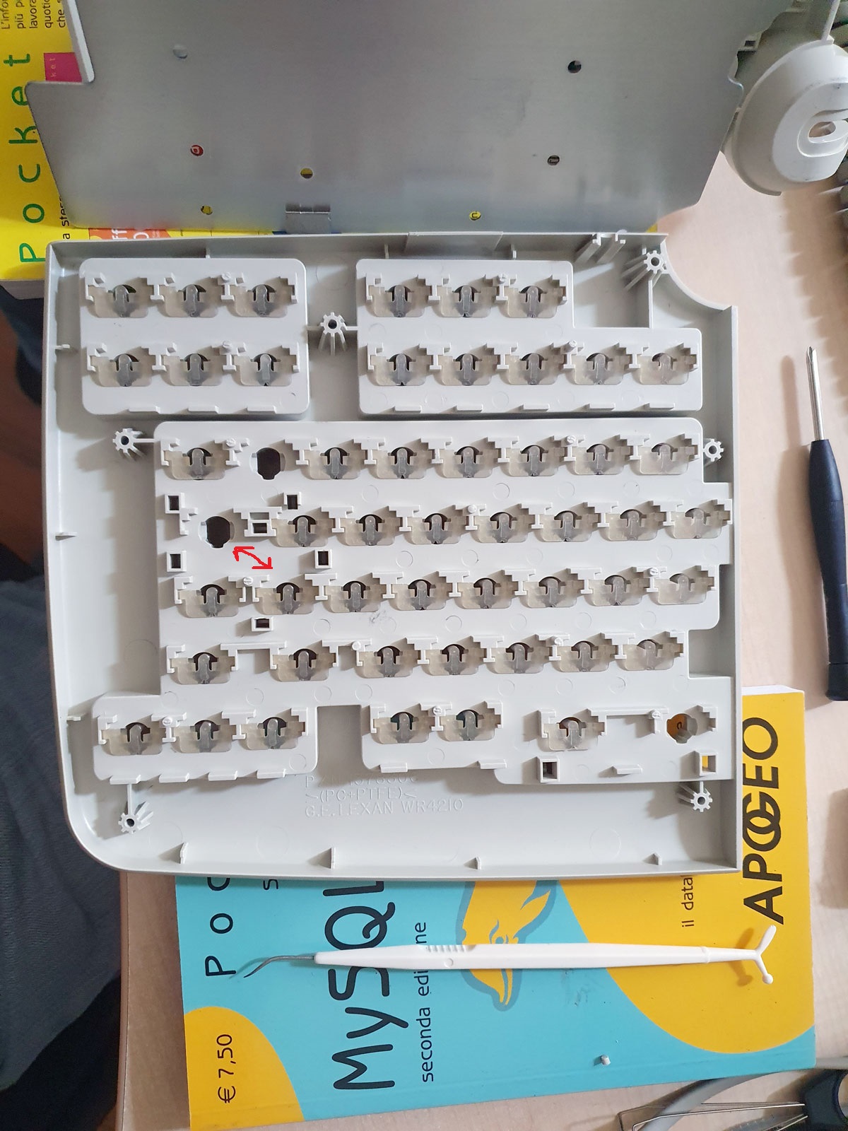

It's very easy to break one of the ten plastic pegs trying to take the ring clips (see pic) off to access the barrel frame in order to proceed with the ANSI to ISO conversion. You'll need, indeed, to add and swap 2 springs/hammers in the two different halves of the keyboard, respectively.
in the pic above: I swapped the spring/hammer located beneath the ANSI '/' character into the slot located on the left side of the vertical ISO Return, (right half of the keyboard).

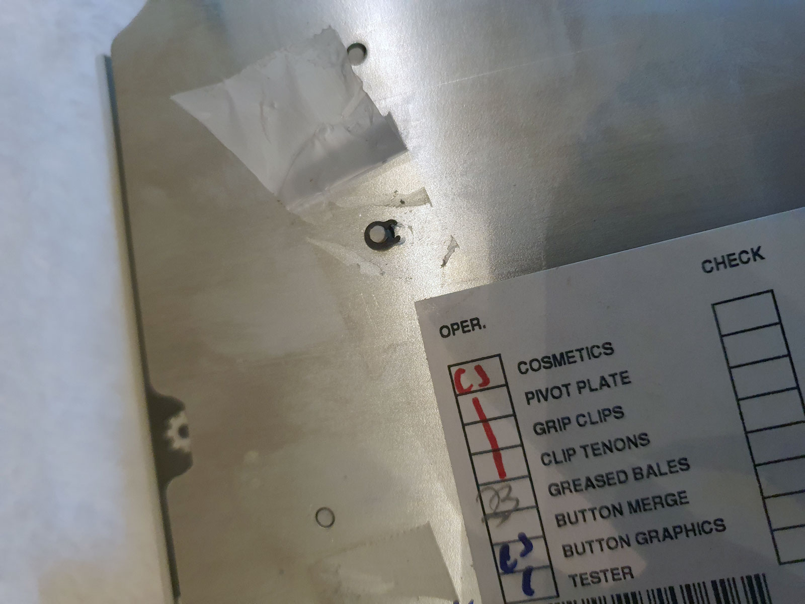

In the pic above, look at the extensive list of quality control procedures. Of course, I personally missed some.

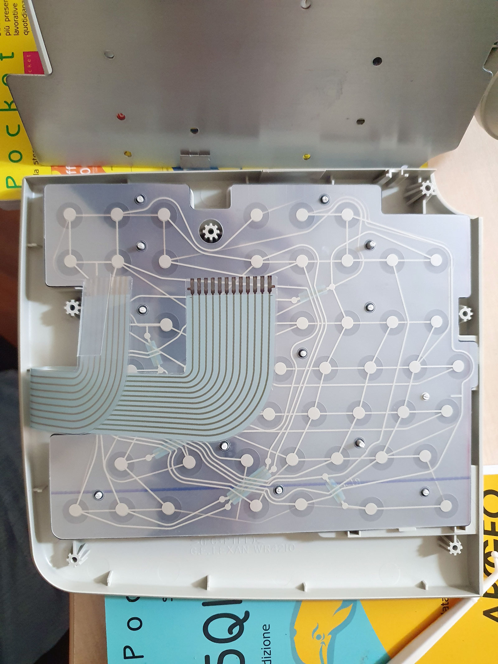

inbetween the metal plate and the barrel plate.....
I found a membrane in pristine conditions with no signs of corrosion. Once done the first half, I started over with the other half where you are required to add an extra spring with hammer in correspondence of the long ANSI left shift, which hosts the angle brackets key in the ISO layout, just between the 'Z' and the new shorter 'SHIFT'.
