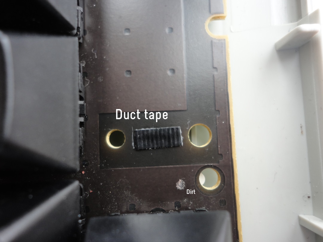

Yes, I placed duct tape under all my stabs. I am thinking about adding another layer to one of them to try and see how much difference it will make (thank god for the 1800 being PCB mount) But at the moment I am pretty satisfied with the feel. I only really think some lube will make it much better.Acanthophis wrote: Did you also put tape on PCB on this second mod? I wonder how much a fabric tape would make a difference.
On my mod, I just cut off the little feet, gotta try clipping away those entire legs, if it really does feel better than just cutting off the feet.
That is exactly what I am doing. Personally I like all my keys to be uniform in feel and preferably sound, and moving the bottoming out to the switch instead of the stabilizer achieves that goal, or at least moves it closer to.Jmneuv wrote:I think you're shifting bottoming out to the switch itself by shortening the stab stems.
Edit: Added some pics
- Cherry stabs mod.jpg (131.8 KiB) Viewed 15701 times
- Added a single layer of duct tape under the stabilizer
- Cherry stabs mod Duct tape.jpg (155.57 KiB) Viewed 15701 times

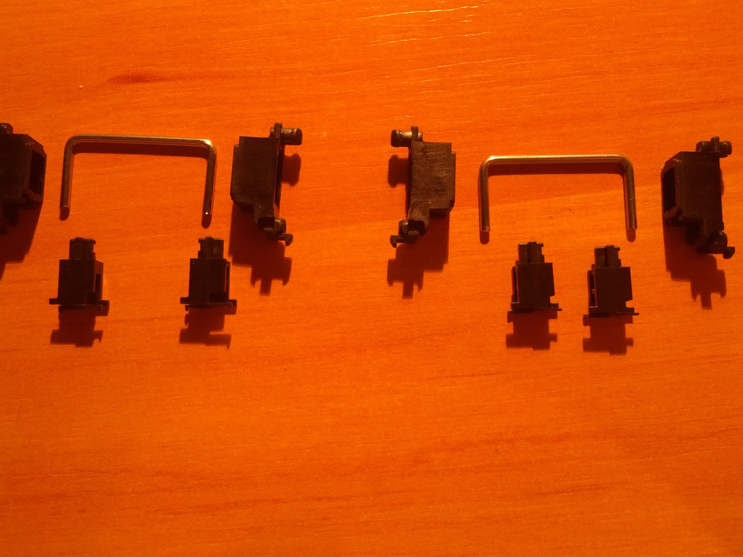

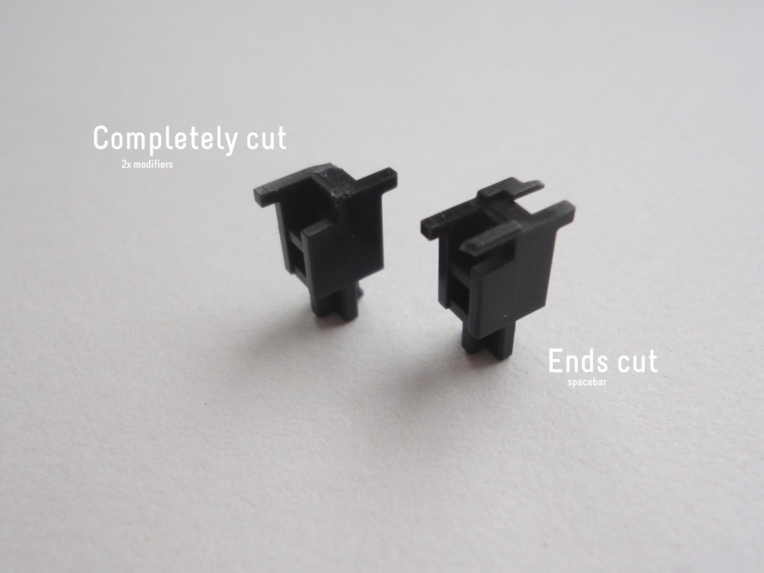

I just did the mod to my Poker and I wanted to add a little potato picture to contribute somehow - It's sad that I have a better camera but I didn't manage to get a proper focus so you could appreaciate the difference (anyway the shadows in the picture help).
I noticed the mushiness on my Poker modifiers since the very first day but I didn't know why it felt like this until I found this thread. While I was modding the modifiers I wondered why did this happen to my Poker and NOT to my Race (both with Cherry stabilizers and PCB mounted). So I opened up the Race just to find out that the little footchops were gone! (not fully cut off)
Could it be that Cherry is making a new stabilizer or did the KBT folks simply cut them off before assembling the keyboard?
Second option sounds more plausible to me...
Anyway I used a precision knife to do the mod (the plastic is quite soft) and I managed to cut all the stabilizer legs and also my thumb twice.
Left is the default Poker stabilizer; right is the default Race stabilizer. Both without any modification by me.
The resulting stabilizer to the Poker is not worth taking a picture of because there's plenty of them in this thread.
A big thank you to all the posters (not only for the info, but also for the randomness, physics lessons and general entertainment found here)
