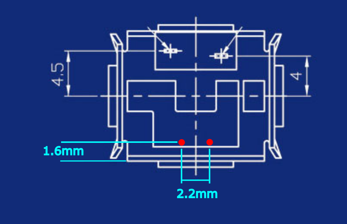

I need help with the Z-150 as I need someone to measure a SKCL switch, with an LED, because I can't find any info on the footprint of the switch with LEDs and that board has 3 switches that require those LEDs. So the faster I can get that information, the faster the GB can open.

BlindAssassin111 wrote: I need help with the Z-150 as I need someone to measure a SKCL switch, with an LED, because I can't find any info on the footprint of the switch with LEDs and that board has 3 switches that require those LEDs. So the faster I can get that information, the faster the GB can open.
Ok so the legs of the LED are 5.5mm in from the short sides (6.2mm from the side ears), 1.6mm from the long side directly opposite the switchplate legs and the LED legs are 2.2mm appart. The actual switch has the same footprint as other SKCL/SKCM alps. Hopefully that is what you were asking for.

Anakey wrote: Ok so the legs of the LED are 5.5mm in from the short sides (6.2mm from the side ears), 1.6mm from the long side directly opposite the switchplate legs and the LED legs are 2.2mm appart. The actual switch has the same footprint as other SKCL/SKCM alps. Hopefully that is what you were asking for.
Okay, I made a drawing to make sure I am understanding you correctly, the light blue dimensions are the only ones that matter, I ignored the other dimensions as it should be centered.
Only question I have is, are you sure it is 2.2mm instead of 2.54mm? Standard spacing is 0.1in(2.54mm) to pin centerline. So I just want to make sure before I do the footprint that I have everything setup correctly.

using my fairly cheap calipers, yes i make it to be 2.2mm but feel free to ask orihalcon as he sold me the 3 switches i have i assume he would have one he could send to you so that you can confirm yourself.
