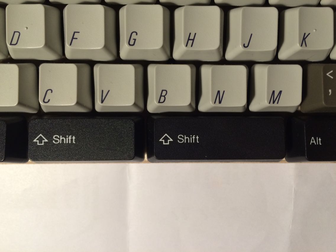

26 May 2016, 03:30
Indeed. My understanding is that split spacebar folks want to use the smaller (Code key) half of the split as a Backspace key, because that's how they roll. Trouble is: where to source smaller spacebars? Were there itty-bitty Japanese spacebar style JIS Model Ms? Does Unicomp supply anything like this?
As for the rest of the board: I'm almost all in favour of following IBM's lead and going straight traditional SSK / fullsize Model M layout, with the addition of 2x 1u keys between each Control and Alt for the extra mods on modern boards. We're just talking capsense pads. No harm in adding these to the PCB, even for those of us planning to use unmodified vintage cases.
Almost? Well, there is one thing. Split right Shift key, HHKB style:
Not exclusively the preserve of HHKBs, far from it:
That key has such a following that Ellipse had to make a separate model of Kishsaver just to satisfy demand! Separate? Because IBM split that looooooong old 2.75u right Shift the other way. On Model Fs and Model Ms alike, there's two barrels and you can either cover the pair with a single 2.75u cap, or with a 1u on the inside/left with a 1.75u cap on the outside/right. I believe IBM did this is to satisfy Japanese and Brazilian layouts, which have an extra key in there, much like ISO crams into the ANSI Return key. Trouble is, that's the *wrong* way for us HHKB fans. And there is no simple solution. Because splitting the 2.75 units the other way around renders the board incompatible with vintage / available right Shifts!
Now, how much do I care about this one detail? Not so much, to be honest. The Fn key is absolutely vital on a 60%, so it matters a lot on a Kishsaver. I really prefer it HHKB style. But we're talking TKLs (and icky fullsize boards) here. We'll have arrow keys and the navigation sixpack intact, so Fn is significantly less important. I say go classic.
