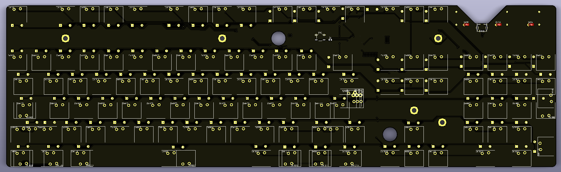

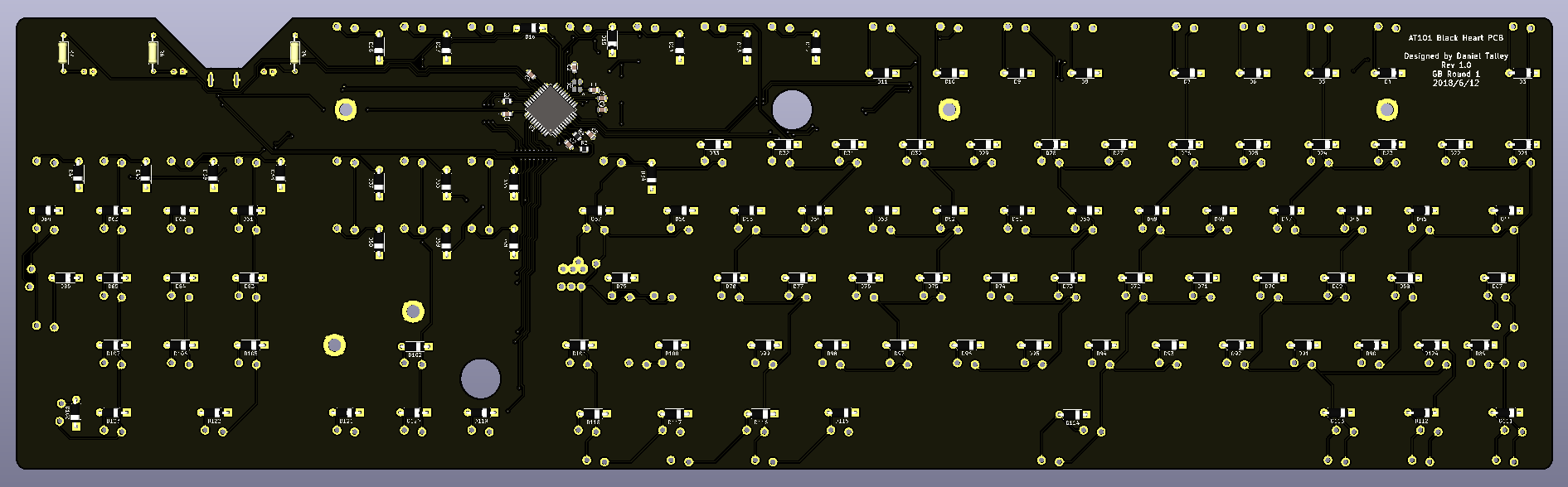

Update:
Board is finished! Took quite a bit of time to figure out the best way to run the column and row traces so it went through a couple iterations of which pin went to which column/row.
Here are some pictures of how it will look, the USB model isn't shown but it will be mounted top side in the same area the original 4-pin header was located.
Top:
Bottom:
I will be getting a more accurate quote soon, and I may add a black heart text logo as well, just to keep that going with all boards I make.

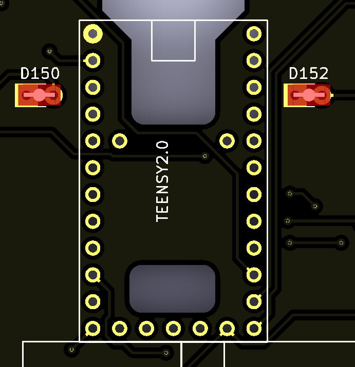

BlindAssassin111
25 Jun 2018, 05:35
Okay, I finally got the quote for assembly for the MC components...It adds quite a bit of cost and isn't economical because of this. At QTY-10 the cost for assembly is $50 each, and isn't reasonable until QTY-30 at $19, which is the same cost as a teensy2.0 with pins.
So with this said, I will redesign the PCB and try and force a Teensy2.0 to work, which is a plus for some. This will take about a week as I have to do a lot of rerouting to make it work. Once I do so I will redo the pricing and get the GB setup and ready for launch next week on 7/2 most likely.
Thank you for your patience and sorry for the delay.

BlindAssassin111
29 Jun 2018, 22:04
Update:
I have finished the rerouting of the traces to now support the Teensy 2.0. The way I have it done is you mount the Teensy upside down on the back so the connector for the USB is more inline with the PCB and the reset button pokes through the PCB so you can still press it. You could technically mount it on the topside connector side up and it will work as well, but I don't know if it will fit the plate.
Also note that the Teensy will need to have headers on the extra pins that are not on a pro micro footprint as I had to use the extra 4 pins. The 3 middle pins on the bottom do not need to be connected just the outside 2 on both sides, but the two in the middle of the board by the USB connector do need to be attached.
