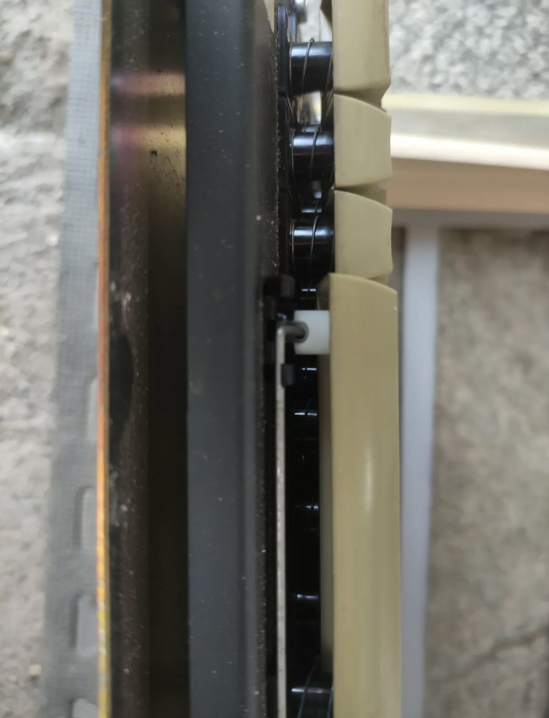

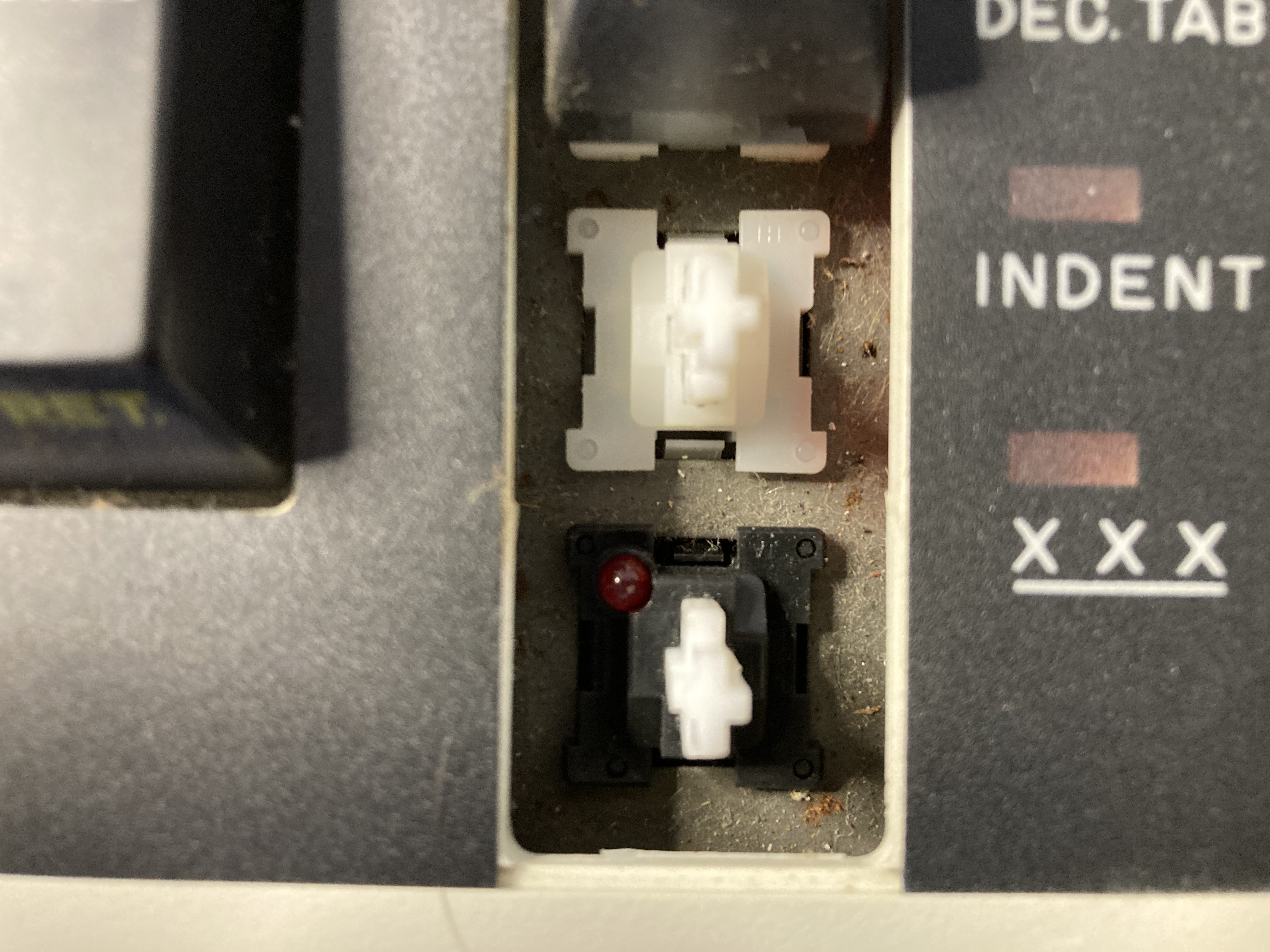

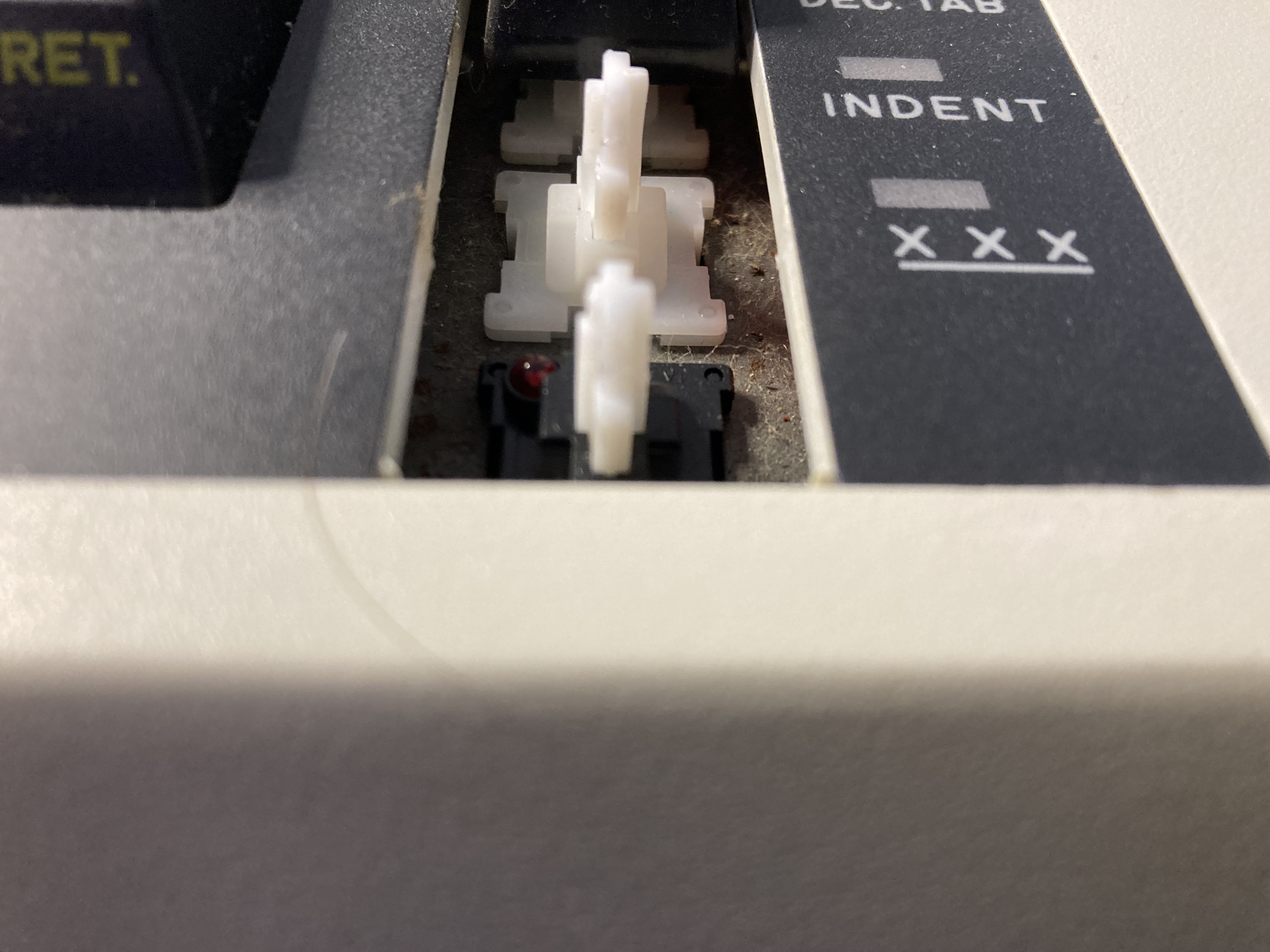

Possibly a wiki/Hosiden_switch but I'm not sure if they came in white.june bug wrote: 23 Mar 2022, 23:09 anyone recognize this switch? it was from an ebay listing a few days ago
https://www.ebay.com/itm/275203116765?s ... 7675.l2557
IDENTIFY THE KEYSWITCH thread
- june bug
- Favorite switch: they're all pretty great
oh yeah, that totally looks like it... really wish i didn't forget about the dang auctionjsheradin wrote: 23 Mar 2022, 23:18 Possibly a wiki/Hosiden_switch but I'm not sure if they came in white.
thank you

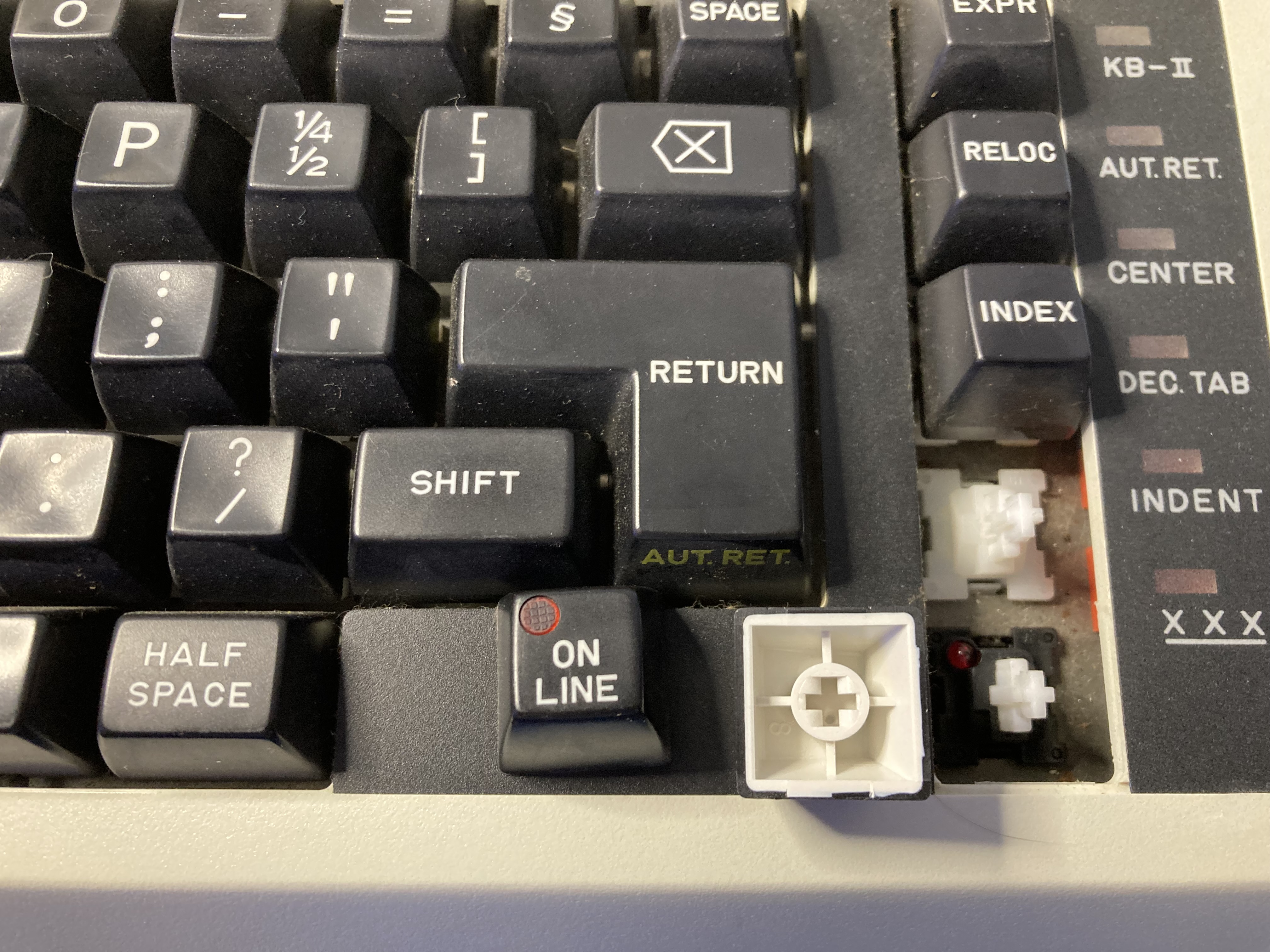

I want to say some kind of Cherry switch, but I don't know.
This is a Royal Alpha 2015 typewriter. Made in the 1980s by Triumph-Adler. Made in Japan. Linear, and not terribly heavy, cross-mount switches. I think the stems are angled. Upside down number+letter marking in northeast corner of the white switches. Caps are thick double-shot, but the mount is not MX compatible. I can't remove the switches to see if there's a name on the bottom of the switches, ATM, because I haven't yet figured out how to get into the case
Neat trick: Has a parallel port to connect to a computer.

wiki/Mitsumi_standard_mechanical, some of the switches might be wiki/Mitsumi_standard_mechanical_double_action (like x, ., -, etc.) where you press extra hard to get a repeating line of them.hellothere wrote: 26 Mar 2022, 00:56 I want to say some kind of Cherry switch, but I don't know.
This is a Royal Alpha 2015 typewriter. Made in the 1980s by Triumph-Adler. Made in Japan. Linear, and not terribly heavy, cross-mount switches. I think the stems are angled. Upside down number+letter marking in northeast corner of the white switches. Caps are thick double-shot, but the mount is not MX compatible. I can't remove the switches to see if there's a name on the bottom of the switches, ATM, because I haven't yet figured out how to get into the case.

Thanks! I've owned an Apple Extended Keyboard II with Mitsumi Mechanical switches, although Alps mount. I just forgot about them

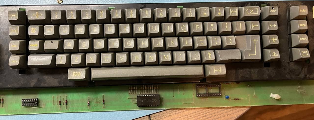

Can someone tell me what key switches these are? Link to Wiki please, if possible. They are from 1974.
Edit: wow I just replied to the first post in a four year old thread

Congratulations?Seirin-Blu wrote: 26 Mar 2022, 21:21 Edit: wow I just replied to the first post in a four year old thread
- jsheradin
- Location: USA
Those are relics of the once widespread APL notation. Unreadable compared to modern programming languages but it's powerful and you get extremely dense code.

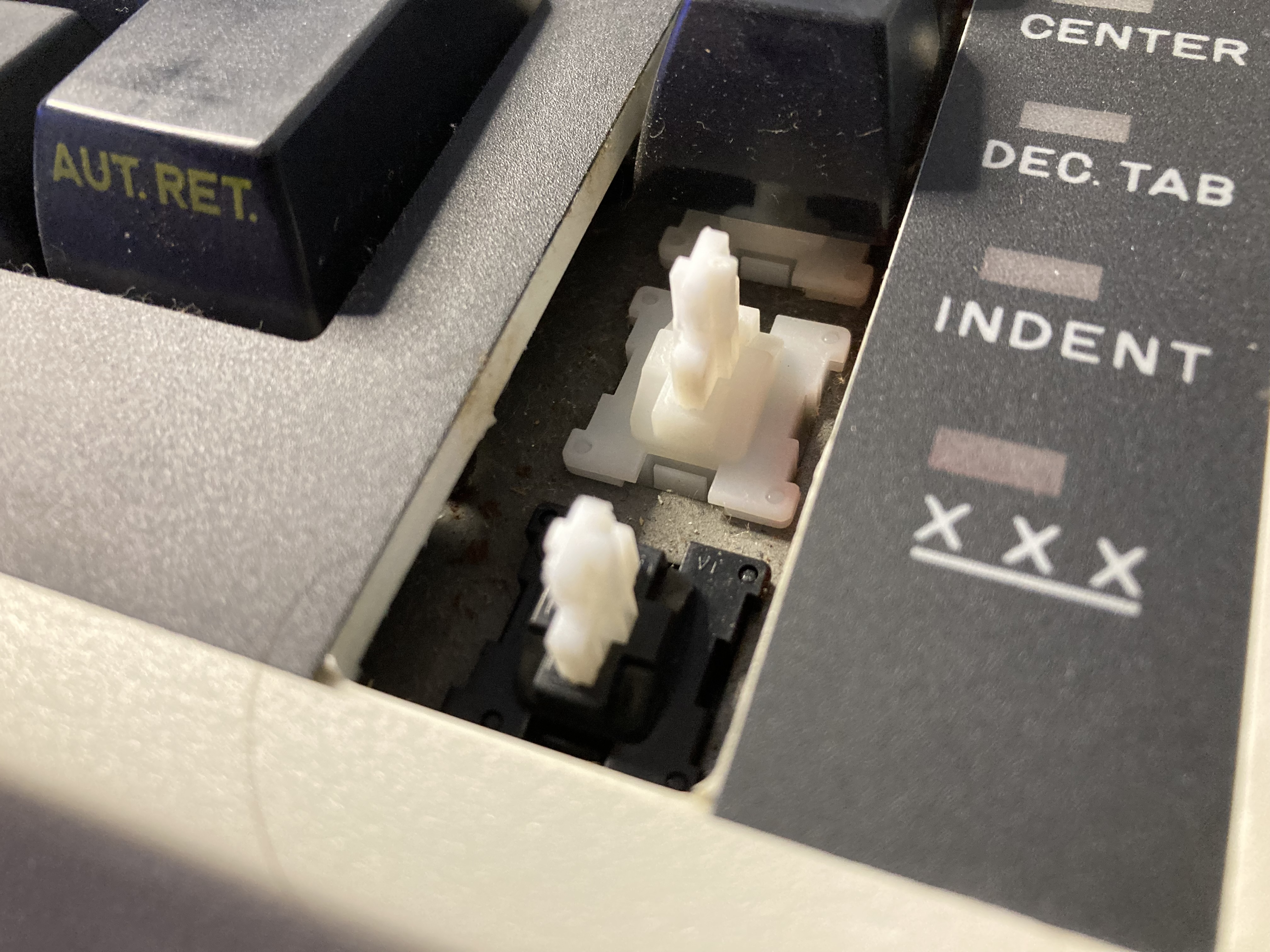

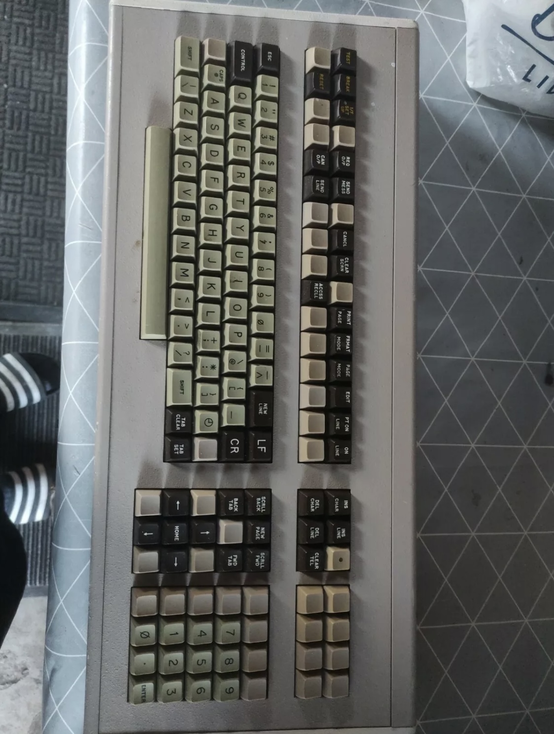

I picked up a typewriter part (PCB + switches/plate/keycaps) and to my surprise, it came with some switches I could not identify.
They are Alps branded and old. They look like SKCC but are a bit different. The PCB has a datecode from January 1982 and the keycaps are Alps SKCC mount at least.
They are tactile, which is afaik a bit uncommon for early switches and fairly light. Not too bad at all to use.
They look like this:
A few more photo's of the switch, keycaps and what's inside is here: https://imgur.com/a/9vPBzO9
If someone knows what these are, I'd love to know. According to the person I got these from it came from a damaged BSI typewriter.

ferix wrote: 13 Apr 2022, 21:59 I picked up a typewriter part (PCB + switches/plate/keycaps) and to my surprise, it came with some switches I could not identify.
If I’m not mistaken then these are Alps SKFF.

Thanks, that indeed is the one! As the wiki didn't have pictures I completely missed it. For a small bonus the keyboard, well, as much as I have. Thanks a bunch!

Really good switch with a very sharp click, can only recommend!hellothere wrote: 16 Apr 2022, 00:50 https://www.reddit.com/r/MechanicalKeyb ... on_to_the/

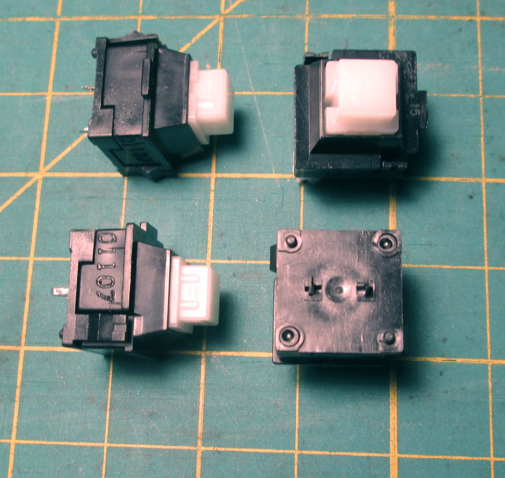

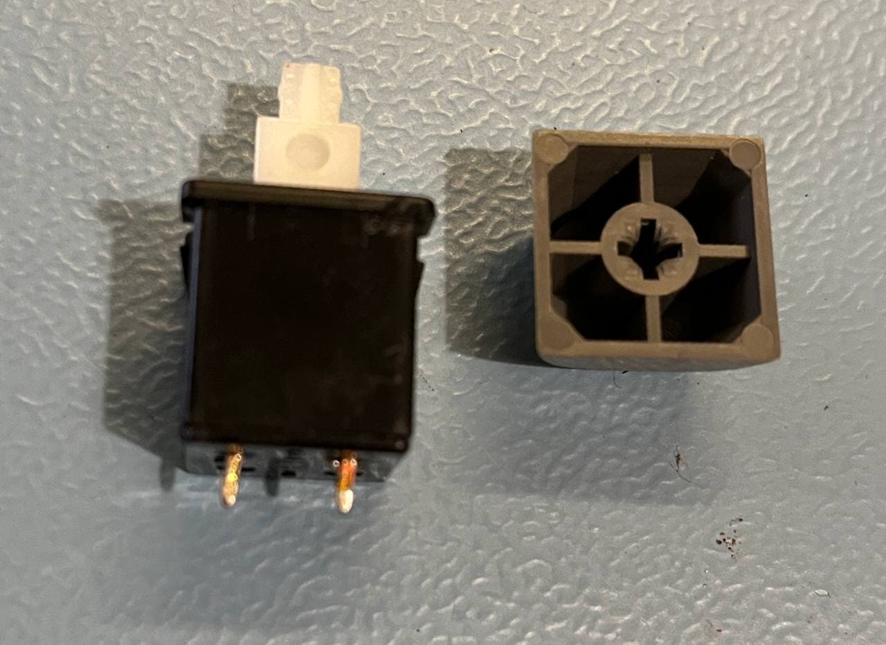

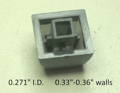

Looks like the place/thread to ask, to identify the following keyswitch, and to ask where I might get keycaps.
Another tech friend has a few hundred of them, no data or source, unused old stock. In summary,
Switch is momentary, 2-pin .1/4" spaced pins,
Black body 9/16 inch square, about 11/16" tall base to stem
with square flat-topped white stem slightly tapered around .270".
Details and photos on my site at:
https://www.retrotechnology.com/z/keystem.jpg
https://www.retrotechnology.com/z/keycap.jpg
https://www.retrotechnology.com/z/1000_switches.txt
but I've attached the photos. Any one recognize this?
Regards Herb

SK-8K

Not sure, but could probably 3D print an adapter to MX stem, since the original keycaps stem stuck out anyway. Also if you have a datasheet I can make a KiCAD footprint.Herb Johnson wrote: 25 Sep 2022, 23:13 Looks like the place/thread to ask, to identify the following keyswitch, and to ask where I might get keycaps.

Switches are Datanetics DC-60: https://telcontar.net/KBK/Datanetics/DC-60Herb Johnson wrote: 25 Sep 2022, 23:13 Looks like the place/thread to ask, to identify the following keyswitch, and to ask where I might get keycaps.

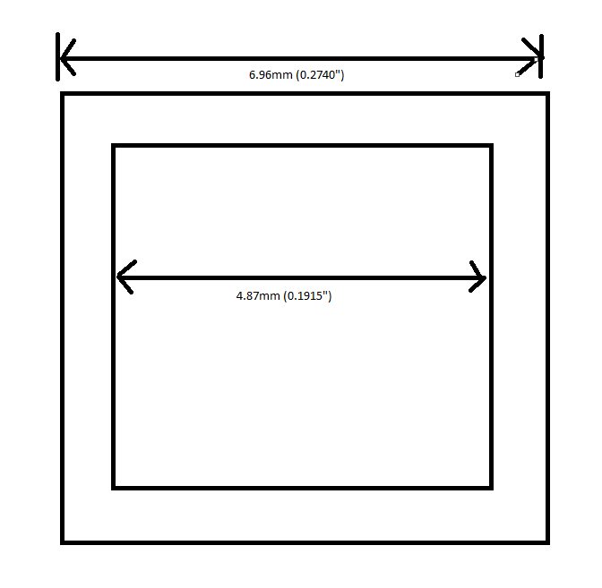

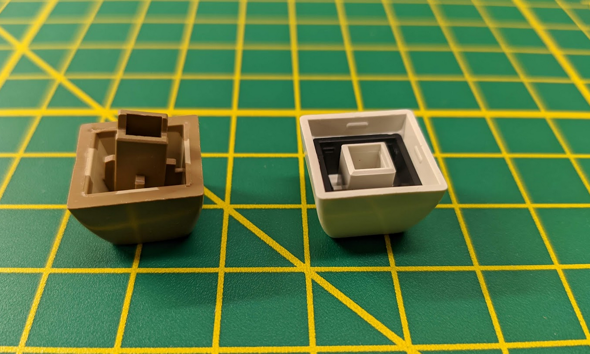

Not too sure about a source for caps though. Resin printers are always an option. They're pretty cheap these days and have sufficient resolution for smooth caps.
That cap looks awfully similar to Hi-Tek high profile caps though. I'll measure one in a bit.
Update: Hi-Tek peg measurements
There's a handful of peg styles but they all seem to measure about the same.
Herb Johnson
- Location: New Jersey USA
jsheradin, thanks for the quick ID and references to the telcontar.net page for details, and of course the local deskthority reference. I looked on site "here" for square keystems, but Datanetics wasn't listed there. My friend the owner is really pleased to ID these.
Regards Herb
Regards Herb
Herb Johnson
>> Update: Hi-Tek keycap peg measurements: inner box .1915", outer box .2740
problem is, these keystems are spec'ed DC 61-01 your catalog,
at .275" square. Actually measured they are slightly tapered at
.266" square on top and .276" on bottom.
So I don't know if a proper keycap "peg hole" would be tapered or straight. It would be a snug fit
at .275" or so square inside the peg-hole, and (my buddy's measurements of keycap)
.271 + .033 + .033 = .337" outside the peg hole (to fit inside the switch body).
(measurements on posted photo confused, should be .033" - .036" walls")
I measure the inside width of the switch body to admit the keycap peg,
That is the likely outside width of the keycap stem, at
roughly 11/32" or .343" . Consistent with the above calculation of .337
by various means my guess at the keycap size is .620" square give or take.
Spec'de minimum spacing for DC60 switches is .625" (5/8"). Consistent.
regards Herb
regards Herb

Any ideas what this one could be? I've clicked through all the linears in the wiki but can't find this.
It's definitely linear and the housing is open on top. The switch is covered only by the keycap.
The device is a Rolitron Rolco-60.

The switch type is listed in your linkdovenyi wrote: 07 Oct 2022, 12:49 Any ideas what this one could be? I've clicked through all the linears in the wiki but can't find this.
