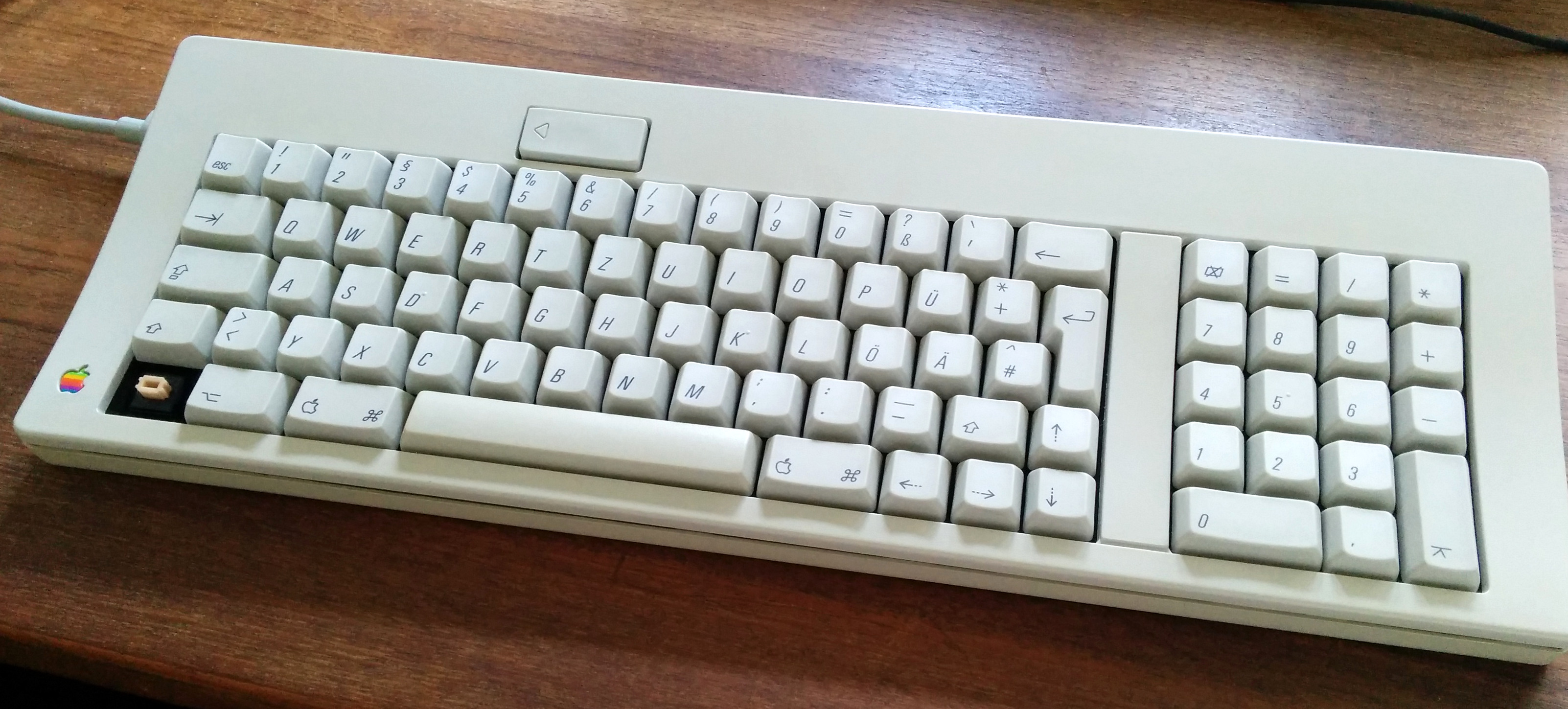

@seebart: The M0116 is one exception to my usual preference for ANSI over ISO. With the ISO version, I would probably remap as follows:
Backspace --> Backslash
U umlaut --> Left Bracket
+ --> Right Bracket
Return --> Backspace
O umlaut --> ;
A umlaut --> Single Quote
# --> Return
Up Arrow --> Fn
The "ANSI" version of this keyboard with the flipped L Return doesn't give me as many good options for remapping to a HHKB-like layout.
On the ISO version, which key is CapsLock? Is it a latched CapsLock?

OK interesting choices for remapping, I'll have to try that. Caps Lock is right above left shift, yes it is a latched grey Alps SKCL.
emdude wrote:
seebart wrote: The ISO versions of Apple boards were always weirder than their ANSI counterparts. The ISO AEK I/II is just bonkers though:
That's for sure, Apple made some strange decisions. They pulled the same wierdness with the M0110.
wiki/Apple_M0110

@seebart: That latched CapsLock would not work for me -- this is where my Ctrl key would go. However, I recall seeing a way to remove the latching mechanism. Alternatively, I suppose the switch could be replaced with a standard Alps switch.
chzel
08 Sep 2016, 19:10
Hypersphere wrote: @seebart: That latched CapsLock would not work for me -- this is where my Ctrl key would go. However, I recall seeing a way to remove the latching mechanism. Alternatively, I suppose the switch could be replaced with a standard Alps switch.
photos-f62/chzel-s-apple-pie-err-m0110-t10403.html
Check the last pick of my post! It's really easy! Keep in mind that if you replace the switch you need to mod the cap to fit.

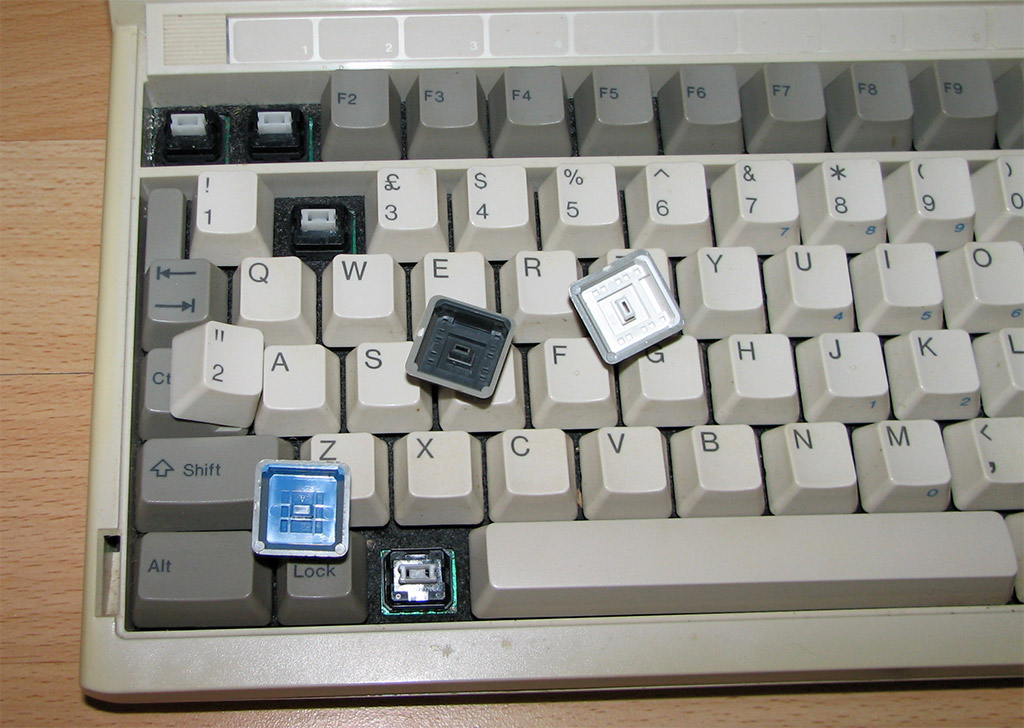

On another matter, I could use some advice on how best to go about cleaning and repairing Alps switches, and theories that might explain how I finally got an unresponsive switch working again. I've posted this on GH as well.
Today I was testing a keycap on my recently refurbished Northgate Omnikey 101 with SKCM white Alps. I had put a "D" cap from an IBM 5140 on the D key, and then replaced it with the stock D cap. After doing this, the D key failed to register. All other keys registered just fine.
I pulled the cap and replaced it again to be sure it was seated properly. It still failed to register.
I then opened the switch, blew it out with canned air, put it back together, and still no joy.
Opened the switch again, cleaned the switch plate as best I could with 70% isopropyl alcohol, checked to be sure that the click leaf was not damaged in some way, reassembled, still no luck.
Opened the switch again and found that if I gently pushed the leaf on the switch plate toward the rear of the switch with a plastic spudger, the key would register. So I supposed that the problem was within the switch and not due to a broken PCB trace or bad solder joint. I tried gently pulling the leaf on the switch plate toward the front of the switch in an attempt to adjust the springiness, but the reassembled switch would still not register.
Finally, I replaced the slider, spring, and click leaf with the corresponding parts from a Matias Click switch and reassembled. Now the key registers. I am glad that this worked, but I do not know why it worked. Thoughts and suggestions welcome!

If it's the SKCL Lock switch that is being referred to here, then I believe that a simple slider/latching mechanism + switch top (and spring, if the weighting is different, I guess) swap will do the trick.
Hypersphere wrote: @chzel: Thanks! While there, I cast my vote -- another one for the Hasu converter.
Have you tried replacing the contact leaf itself?
I did something silly the other day; I replaced the contact leaf of an SKCM Brown switch with its tactile leaf and removed the dummy switchplate entirely. The result was a tactile "SKCL", more tactile (if a bit clunkier) than an unmodded switch actually. However, it would not register, unfortunately.
Is it the type with the embossed dot on it or without?
emdude
Model M Apologist
08 Sep 2016, 20:17
The contact leaf has the embossed dot, the tactile leaf does not. Thanks for asking that question, I never quite understood how the contact leaf + switchplate worked, even after reading the wiki article on the switch series, but I see now that the embossed dot presses the front-facing foil against the rear terminal. That must be why the tactile leaf cannot be used to actuate the switch.
