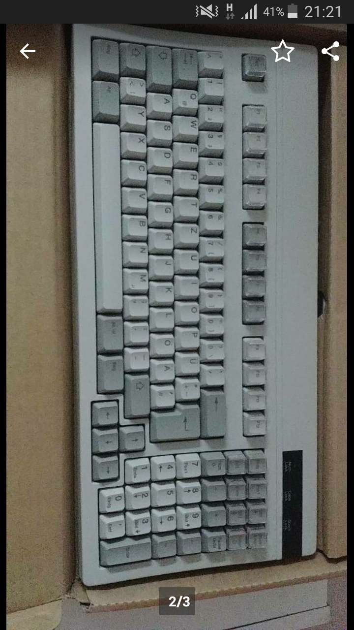

Another time, another question of what is the switch?

Pretty cool to see 2u keys straddling two 1u positions. Those look like they have stabiliser bars, but that also means that the switches between each one can't be very wide. Because of that, and because it has a white plate, it is likely not mechanical. Good-looking special-purpose keyboard though.

Findecanor wrote: 05 Mar 2019, 05:22 Those look like they have stabiliser bars, but that also means that the switches between each one can't be very wide. Because of that, and because it has a white plate, it is likely not mechanical.
I'm not saying that you're wrong, but I have a PC Accessories KB-7001 in front of me with a 2u Escape that has a stabilizer for an Alps switch, so the coincidence was too good not to share :D

Do you have any idea? What kind of switches and keycaps? Is it connected via ps2 or xt/at?
ghostdawg187
06 Mar 2019, 12:08

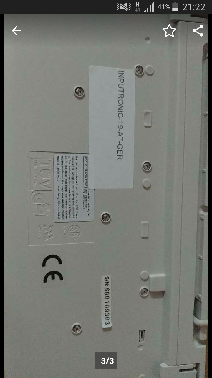

The above requested keyboard is from "Inputronic" or "Solid Year". I have never heard of them and seems to have an AT-connector. But I am totally unsure if it is rubberdome or not.
PS: It is a Solidtek ACK-700, but I still don't know if it is rubberdome or not :(

ghostdawg187 wrote: 06 Mar 2019, 12:08 PS: It is a Solidtek ACK-700, but I still don't know if it is rubberdome or not :(
based on the number of screws on the back and the fact that the keyboard case doesn't look that deep (except the top where the controller, cable gutter and legs are located) it is most certain a rubber dome

derzemel wrote: 06 Mar 2019, 15:49
The more screws it has the more it is likely to be rubberdome?

ghostdawg187 wrote: 06 Mar 2019, 15:59 The more screws it has the more it is likely to be rubberdome?
not that alone, but also the fact that the case is not deep enough to hold normal switches. In the second picture you can see the the back of the case (there the legs are located) is taller than the part where the screws are. This tells me that inside the case there is a membrane that needs to be kept from moving around.
The only membrane keyboard that I know of that we consider to be mechanical, is the IBM Model M

Keyboards that have sunk-in backpanels like that are almost always membrane, in my experience.

It looks to me like it has a slightly curved backplane, and a curved backplane means membrane.
However, a membrane does not always mean rubber dome. I know of only two non-rubber dome membrane switches that could have a curved backplane though: Model M buckling spring and Mitsumi's "hybrid switch".
Judging by the keyboard font, it could perhaps be Mitsumi: neither this nor known Mitsumi keyboards have a font that sticks out from the crowd. The Alphas and digits seem to match but many others might also use the same font. One would need a better picture to tell better.

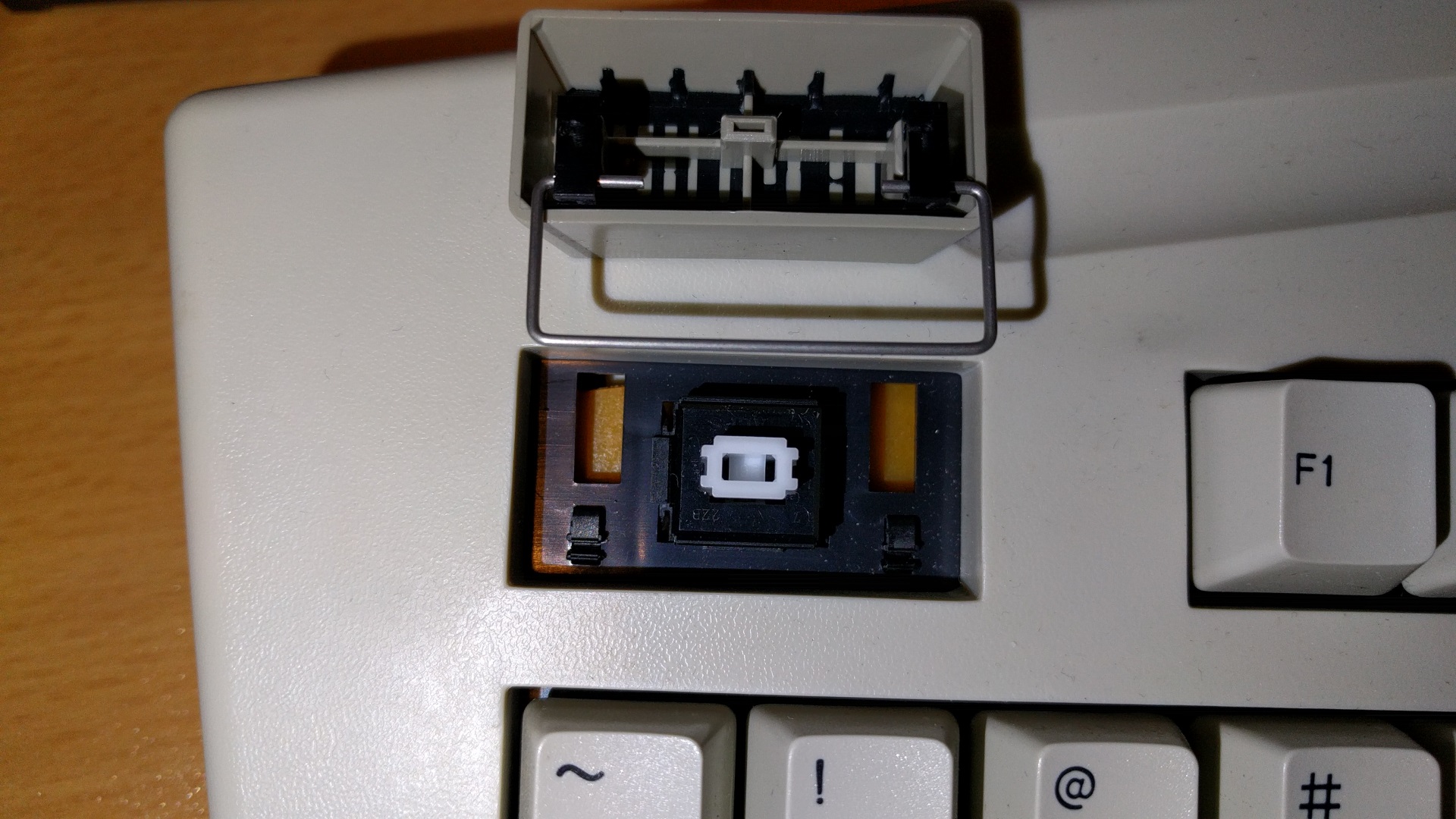

ghostdawg187 wrote: 05 Mar 2019, 21:24 Do you have any idea? What kind of switches and keycaps? Is it connected via ps2 or xt/at?
I had one. Dome with slider and the keycaps and slilders awhere a single piece built in the chasis of the keyboard, so if you take a keycap it will break. Very strange keyboard.

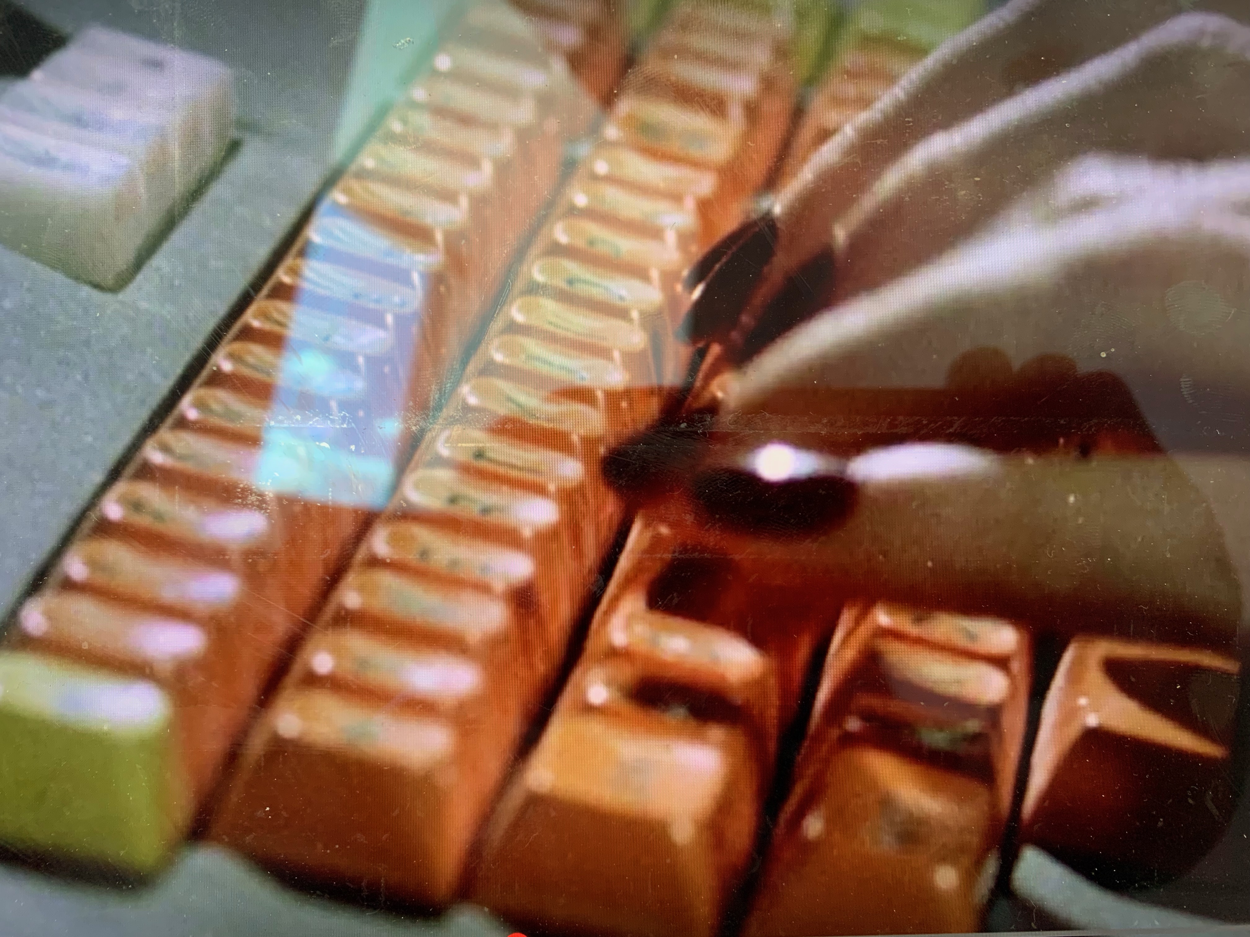

This is a screencap from "The Farthest", a documentary on the Voyager spacecraft. What's the keyboard? The caps are gorgeous.

madrobby wrote: 19 Mar 2019, 23:07 This is a screencap from "The Farthest", a documentary on the Voyager spacecraft. What's the keyboard? The caps are gorgeous. IMG_4279.jpeg
I would guess an old ADDS terminal. Nothin better than some orange computer stuff!

imdatperson wrote: 19 Mar 2019, 23:12
You would be right. ADDS Consul. Found it browsing eBay at random.
https://www.ebay.com/itm/Adds-Consul-58 ... SwYS5ccf4r
Very pretty thing.
