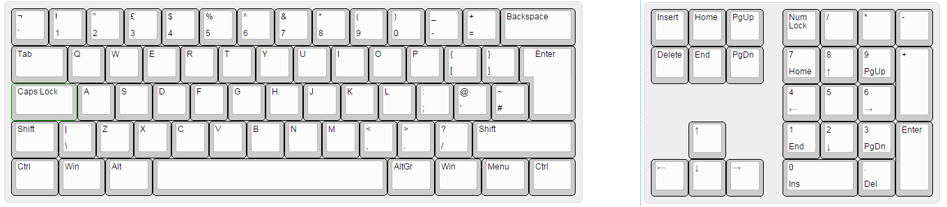

Hey all - I'm pretty new around here, but I thought I'd post a build log of a keyboard I will be making over the next few months, so I can get help and feedback from the community - and what an excellent community it is if I may say so! People here have been very helpful with my noob-ish questions so far!

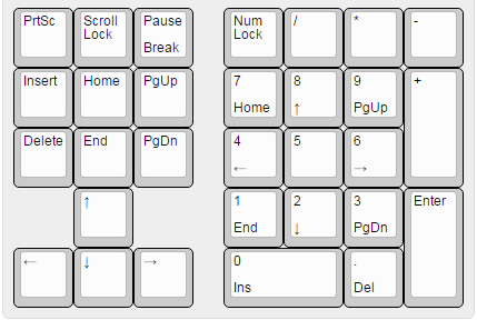

The plan for this keyboard is to have it in two parts. A standard (ISO layout) 60% board and an external numpad which also includes the arrow keys and navigation cluster, as shown below. They will essentially be two separate keyboards (two Teensy controllers, one in each). This means I can carry the 60% section around with me as I want, and leave the numpad+ section at home so I have a full keyboard on my own desk! Nothing ground-breaking, but I'm not sure I've ever seen this exact configuration before...
though I am considering an alternate layout for the right-hand side:
Though I think I am much less likely to use the three extra keys, and they will 'get in the way' more like this. Besides, they can always be on a function layer somewhere...

I'm having my plates cut by my local library's CNC machine Tuesday after next, so I guess what I'd like to ask at this stage is...is there a glaring error in my layout? Any gotchas I've overlooked?

I don't want to ruin it for you, but you can actually get pre-made keyboards with this exact layout. You could also get PCBs for the 60% too if you still wanted to DIY it. You can get some Qtronix somethingorother for the numpad etc. part also. I understand that it's fun to build from scratch though, so if that's what you're aiming for then don't let me get in the way. :)

As scottc said, both parts exists prebuilt. The numpad part exists as is as Qtronix Scorpius 32 which you can get for 20€ from eBay. But if you want to build it for the sake of building it your self, I'd say go ahead! It's great fun :D
I would split the right shift into 1.75U + 1U so you get a HHKB style FN key, if you don't mind extra difficultly to source a 1.75U shift key.
If you're a Mac user: Mac OS X manages modifier keys separately for each keyboard. If you want to make selection with the arrow keys, pressing shift on the main part and arrow on the external numpad won't select anything unless you install extra software to sync the modifiers.

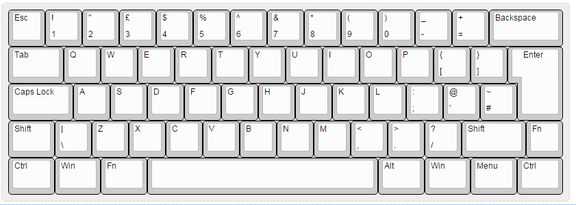

Ok. I've split the shift and fiddled around with the bottom row keys a bit.
I like having Ctrl and Alt on one side of the spacebar, but equally I want a Fn easily reachable with my left hand...the Win on the right isn't ideal, but it's the best compromise I can think of. Does anyone have any other suggestions?

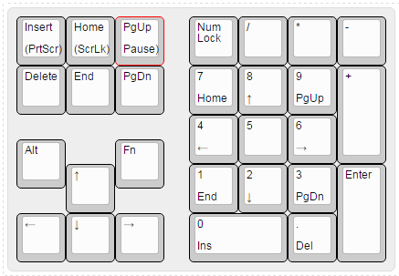

What about this for the numpad - the Alt will allow me to enter ASCII codes etc one-handed, and the Fn for symmetry and one-handed access to the fn layer (also useful if I ever end up on OSX, I guess...).

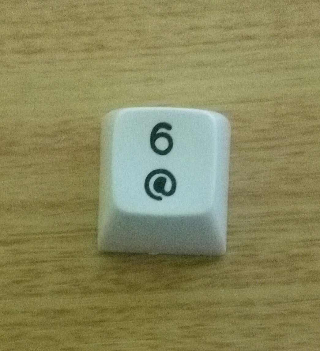

Any thoughts on how to convert 2u POS keys to fit a standard mount? I picked up some leftovers up from 7bit just to fill the numpad, but the 2u keys I got were POS ones (ie, they have 2 stems, not the 3 required for a standard stabilised mount).
The easiest way would be to knock out the stems and glue them back in in the right place (I even got an extra key so I have enough stems, as I had a feeling this might happen!) - is there an easy/known way to do this? Or will it most likely just break the keys?
[Edit]: anyone know what set this key was made for? It's a big ol' tall SA profile - 7bit threw it in as an extra. (Apologies for the potato-some picture)

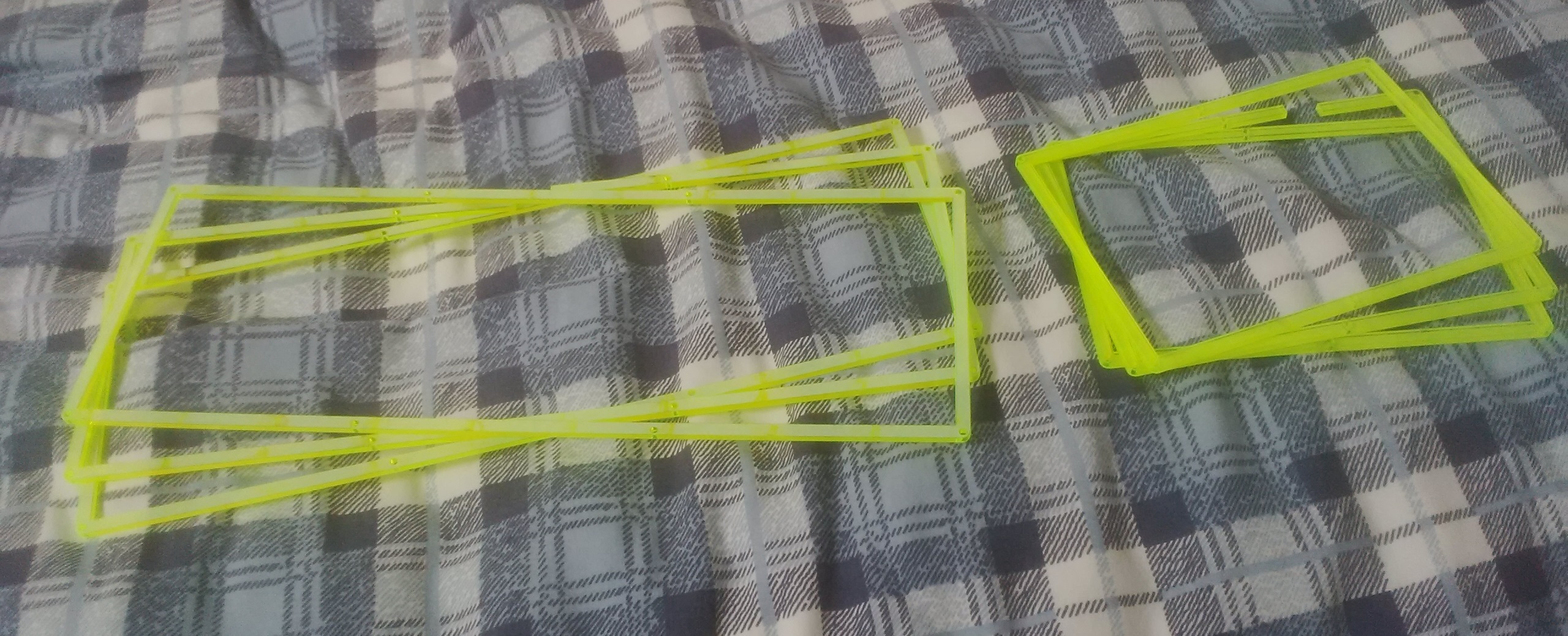

So...plate cutting delayed for another 2 weeks. I'm, a bit disappointed, but it's being cut for free (I supply materials) by some guys who run a machine lab in the local library on a voluntary basis, so I can't really complain. Also, none of them are real CNC experts, so I'd rather they have it all figured out than use my project as a test bed!
On the other hand, they were able to very quickly produce the acrylic layers (maybe temporary ones...) out of some 3mm green acrylic they had lying around. I may invest in a sheet of 5mm black or white (or other neutral colour) for the final version, but these are good for now! (Picture in next post)

14 Oct 2015, 14:46
Captain PotatoPic to the rescue! (I don't even own a camera, so apologies for trampling roughshod over the artistic sensibilities of those who take pride in taking good pictures!)
