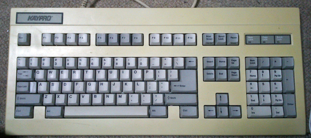

That's quite a rare keyboard your grandma let you have. Like klikkyklik I'd like to see some pictures, does it look like this?
donaldej
08 Oct 2015, 19:21
I currently am at work but Ill throw the ones I have on my phone here.
I took a couple pics as I took it apart for reference. The first image does not show how nasty it was when I first picked it up because I did a basic wipe down of the bezel before I started removing the keys. However the grime between the keys looks pretty tasty.
Crazy Canadian XXIV
08 Oct 2015, 19:28
That 1U backspace though. I'd love to see a picture of it from when you first got it. Looks like you had your work cut out for you. And yeah, that grime DOES look pretty tasty.

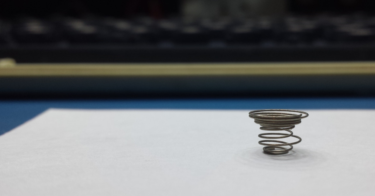

Another poster on this forum had pictures of his. Its a conical shaped spring. The bottom picture I attached is showing some kind of clip. Im not quite sure of their function as they did not really hold on, but they sat between the black assembly and the membrane underneith and the clip part went inside of the button.
http://deskthority.net/external-f34/bes ... t4455.html
donaldej
08 Oct 2015, 19:52
Ya that's it.

Alright, I just got done taking it apart snapping some pics and putting it back together.
I noticed that the model number on the case is HMB-35957U-14, but the model number on the bottom of the keyboard internally is HMB-35957U-18. My grandmother definitely was not the type to mess with technology beyond how its delivered so I am curious about that.
09 Oct 2015, 01:44
At first I thought at was a simple spring over membrane, but this is obviously something more. Nice find, I've never heard of these before!

If I had to describe the system just from those shots, I'd have said "spring with metal slider over membrane" but it's obviously not that because that system doesn't account for either the tactility or the clickiness. I have no idea what this board is, in fact I think this gourd spring is a new system for quite a few people.

Shortly after reading the OP, I went on a hunt for one of these. Found one on eBay for very reasonable back in November, and just now got done cleaning it up and am using it. Quite an interesting board; the ping isn't like anything else I've come across so far. Can't say it's the best feeling keyboard, but it types fast @ 50g or so.
Cool springs, too. More info and pictures on my blog if interested. Quite happy to have it in my rotation.
https://klikkyklik.wordpress.com/2015/12/28/oki-won/
28 Dec 2015, 02:31
There was one of these Oki spring keyboards on eBay yesterday but it's already gone so someone must've picked it up. The shape of those springs is insane xD .
