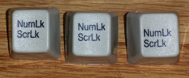

I think I wrote something about that a while back, I am still unsure if they are using the new machines on existing keyboards and are flushing the older stock out before using them....fohat wrote: Unicomp supposedly bought a new dyesub machine and improved its quality. The last ones that I bought, a couple of months ago, were nice.
The M2 has excellent qualities and terrible design blunders.
One of the worst is that it does not use M/F keys and has that stupid "Row-X, Profile-Y" crap, and the stabilizers are weird.
Except when ordering custom keycaps like in this example:
- Unicomp NumLk-ScrLk Key all 3.jpg (66.04 KiB) Viewed 7221 times
