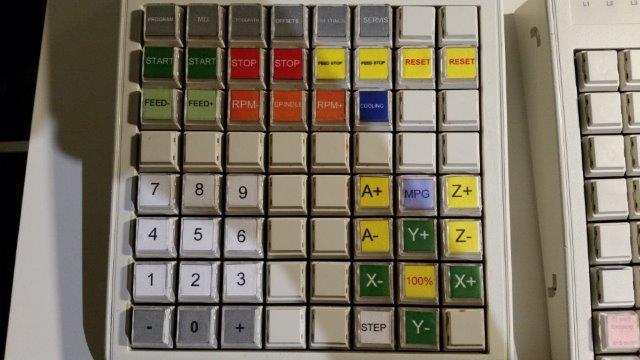

Your keyboard (the left unit on your pic) now obviously has 64 single keys. The program allows you to define two adjacent keys are a double key, and four having a common "corner" as a quadruple key. You will then need the corresponding caps. Tell me exactly what you need, I should have enough of them for you.
Are you aware there exists a plastic jointer with which you can assemble both units to build a single keyboard?

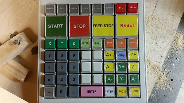

I could take 8 quadruple and 8 double. so that I had if need, for the future. That's my keyboard and the keys that are the same, I would like just to make double. Last one in a row which is reset I would like to have quad. and maybe this is nice idea of merging the two keyboards, so I can do second one to write programs for the CNC, all G-codes. Then I needed a 64 caps for the other keyboards. how much would it cost? One small issue. how would you sent it to me? I live in Norway

And new keys arrived, finally the keyboard looks like it is supposed to look, big thanks to colleague kbdfr. Working on a milling now is a pleasure. Thank you all for your time and patience.
