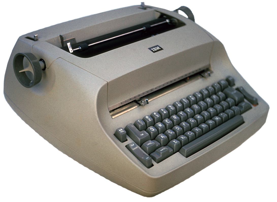

Chyros wrote: There isn't even a definition of "mechanical" anyway ;) .
That's a really good point, whereas something like this is actually (more) mechanical:
22 Jun 2016, 18:32
And. of course, it can be argued that IBM M/Fs are *not* mechanical anyway!
