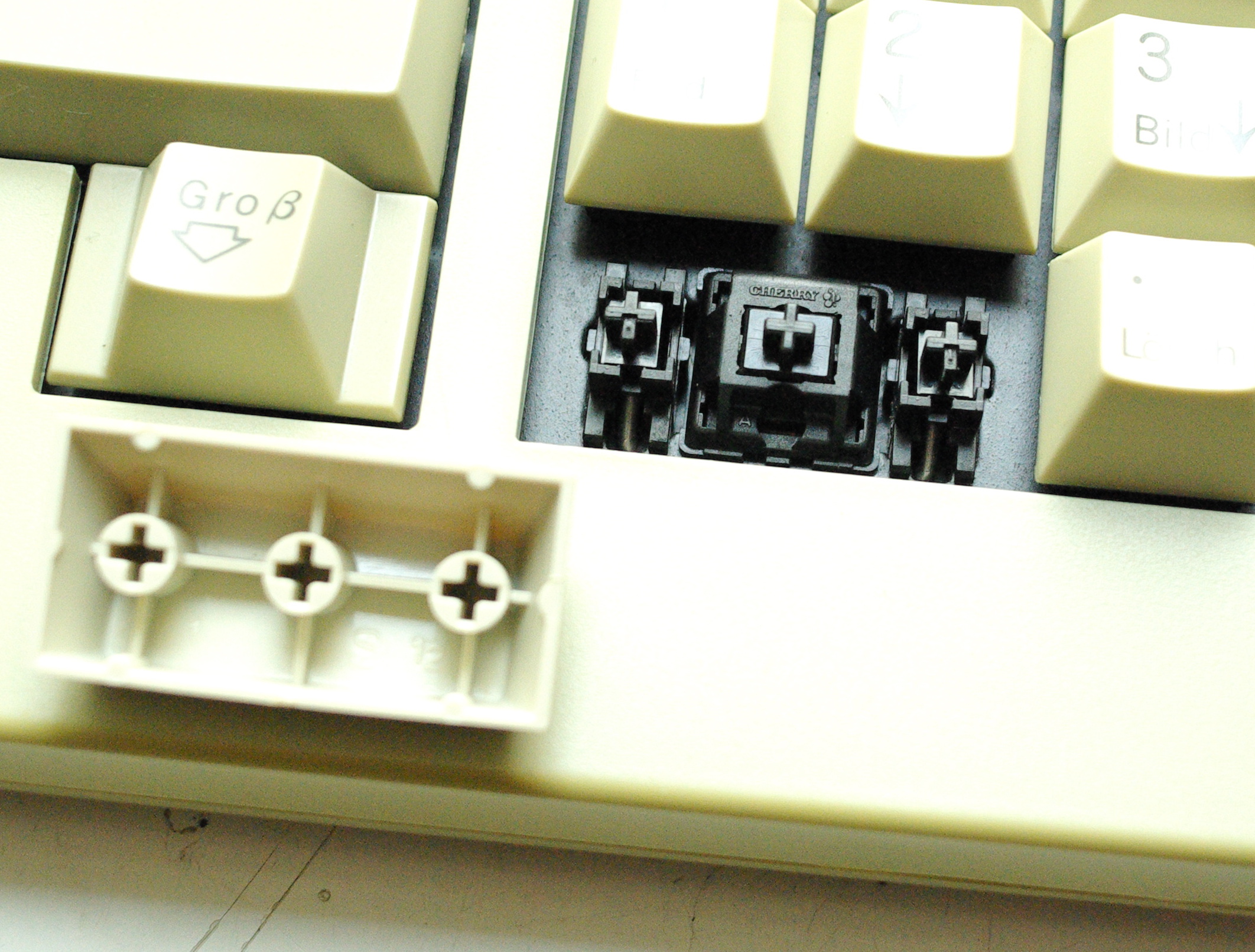

26 Jun 2016, 13:17
So far my indicator for clearly NOT vintage MX Blacks is the SMALL font Cherry print directly above the MX stem cutout on the upper shell. There are however vintage MX Blacks with a small font print where the "C" of the Cherry print is pretty much above the left flank of the cutout for the MX stem, see Seebarts pic. I have seen those on Amiga 2000 (Cherry G80-0904) keyboard. Those keyboards must have vintage blacks ...
https://imgur.com/a/CfRzh

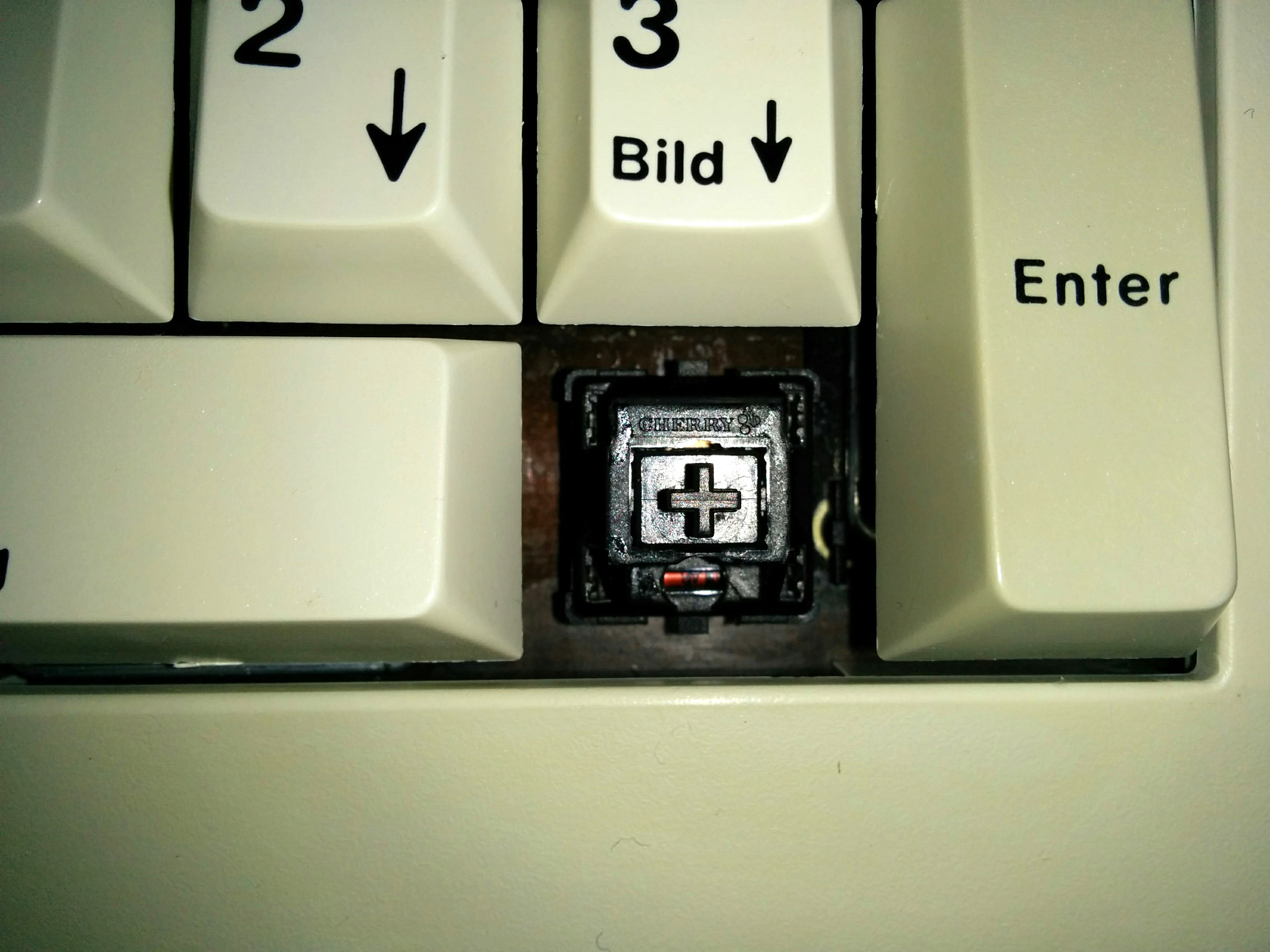

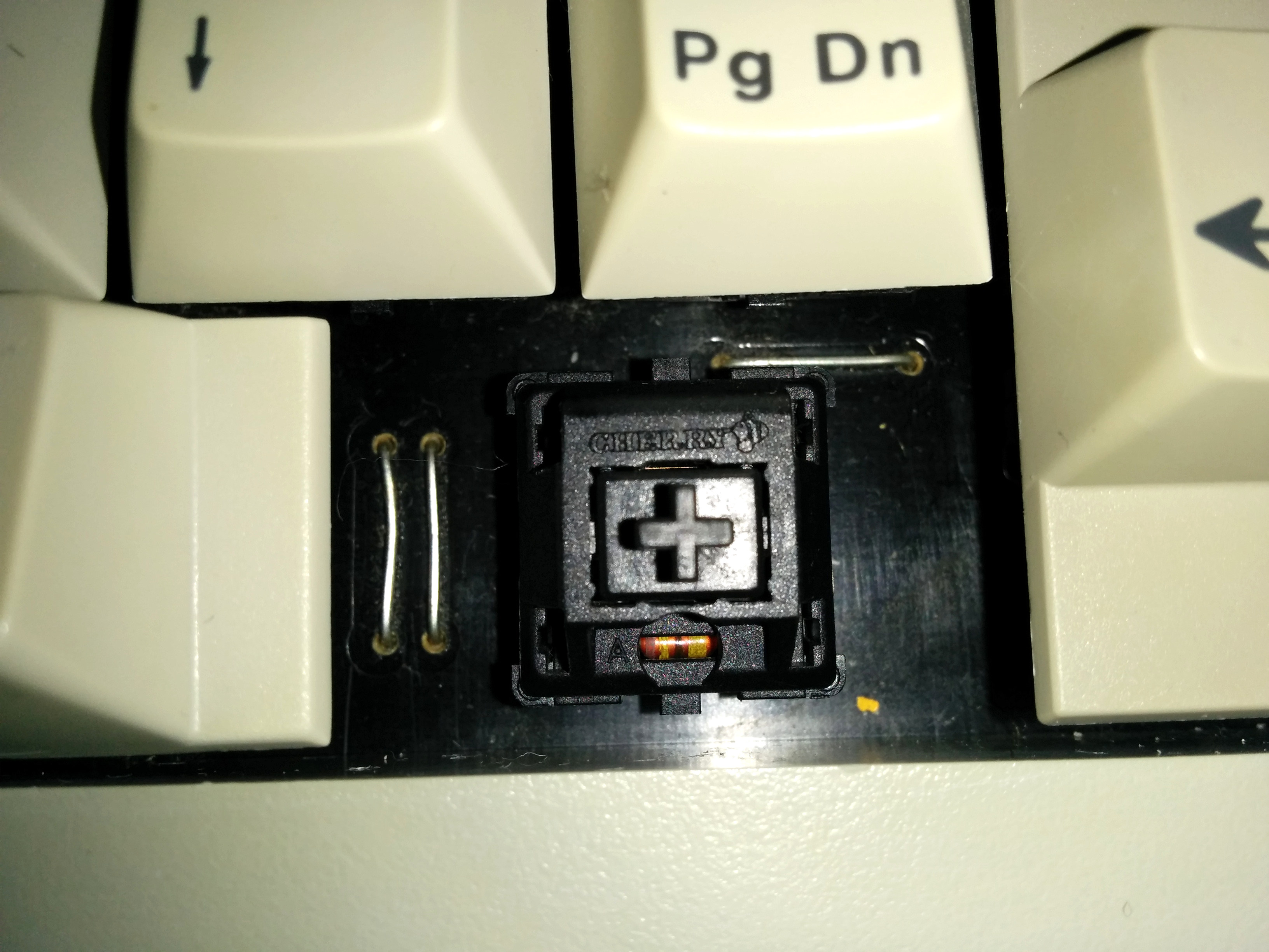

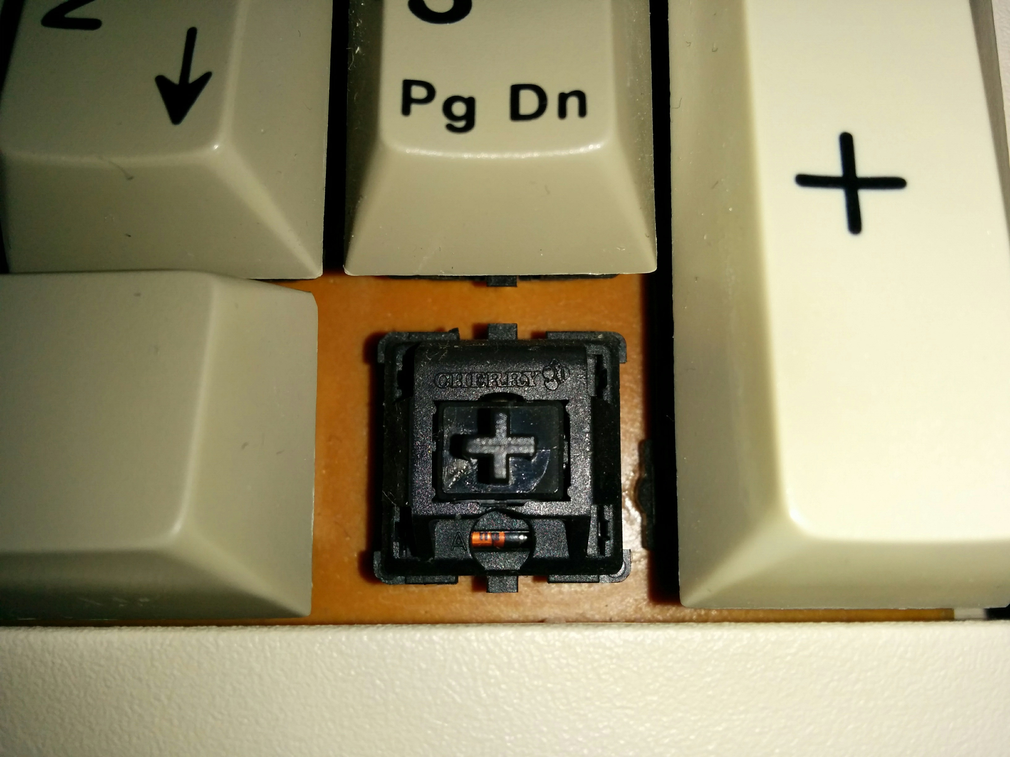

Wodan is right, I had a look at these just now:
Cherry G80-0499:
NCR H0150-STD1-10-17:
Cherry G80-2100 HCD:

G80-2100 HCD is ... not vintage?
Hope we agree on this as well ;)

Wodan wrote: G80-2100 HCD is ... not vintage?
Of course not, that's why I put it in there as a comparison to the other two.
